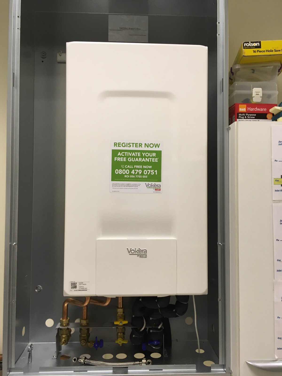

That looks like it is in the external case.
Correct. The optional frost kit is fitted (trace heating round pipes below insulation, heater pads inside boiler on hot, cold domestic pipework and condensate trap).
It's recommended a canopy is fitted above, there are kiss cuts for flue outlet options that can perforated and allow water in.
Where are they for sale? If adequate frost protection is fitted the optional frost kit is not needed. I assume this is a belt and braces approach.

Boiler has frost stat and it can fire at 6C DHW pipe and 4C heating pipe to keep itself and close pipework protected to -6C I recall. I think with the optional kit it's down to -12C.
