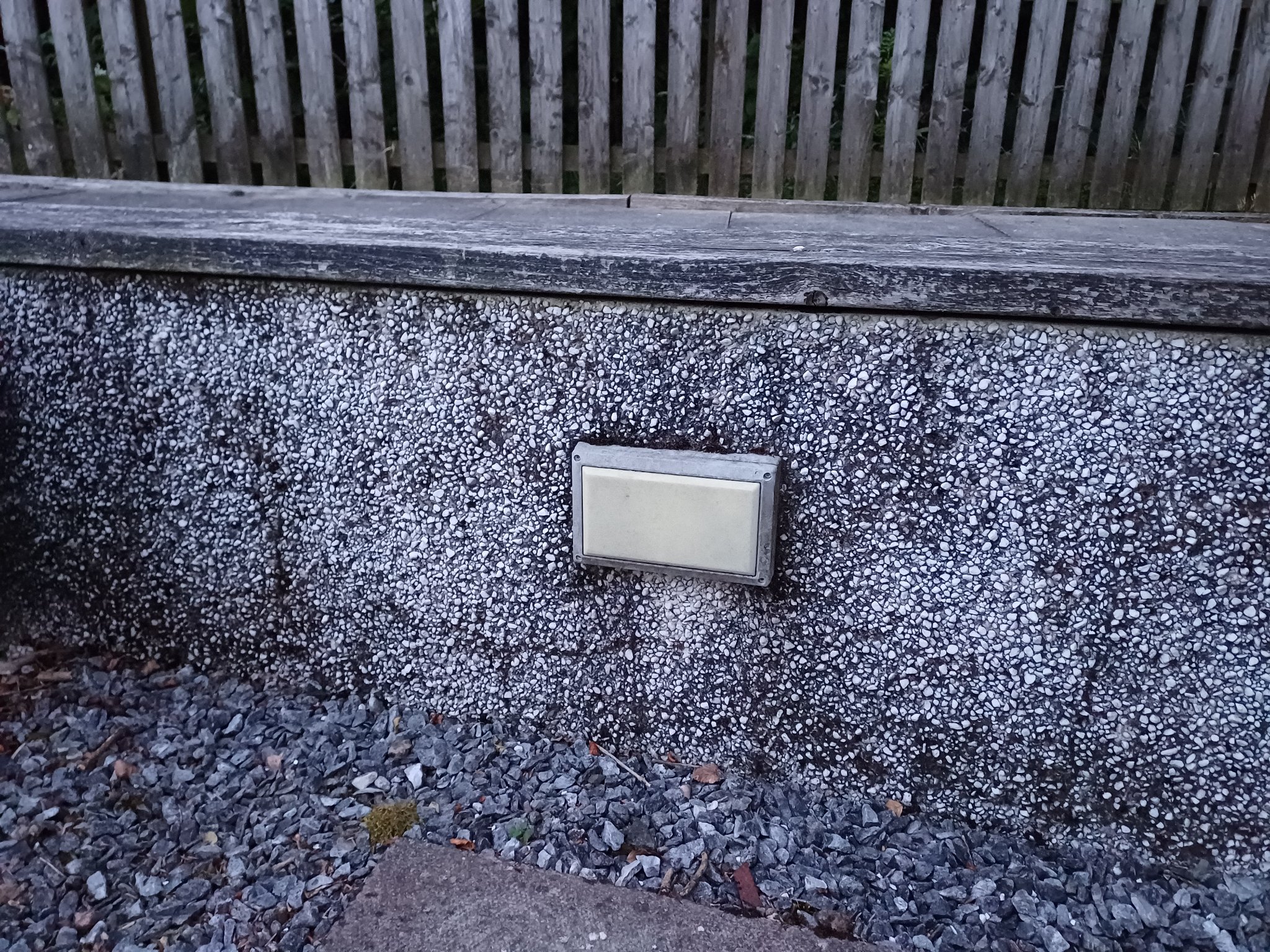

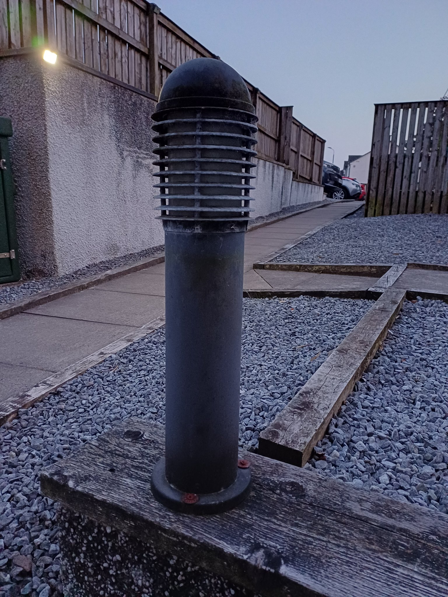

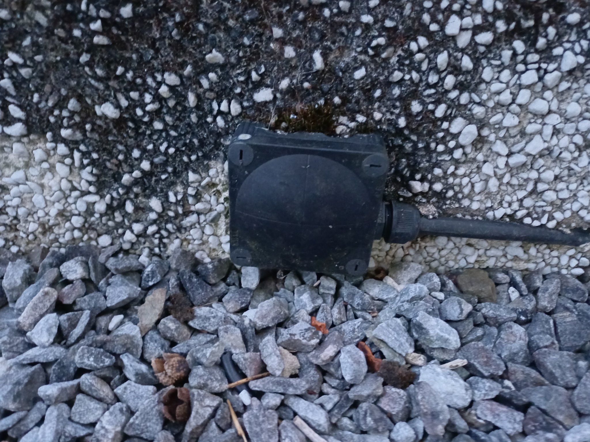

These outdoor security lights have not worked since I moved into my flat. I'm very reluctant to contact the management company because any repairs always cost a fortune. The bulb in the bollard style lamp is working. I've tried it in an indoor lamp. The wall mounted lamp (last photo) is one of several down the back of the block. None work. I'd like to try fixing this but don't know where to start. I can't see any PIR sensor that would switch them on. If they're on a timer then I can't see anything in the electrics cupboard. All suggestions gratefully received.

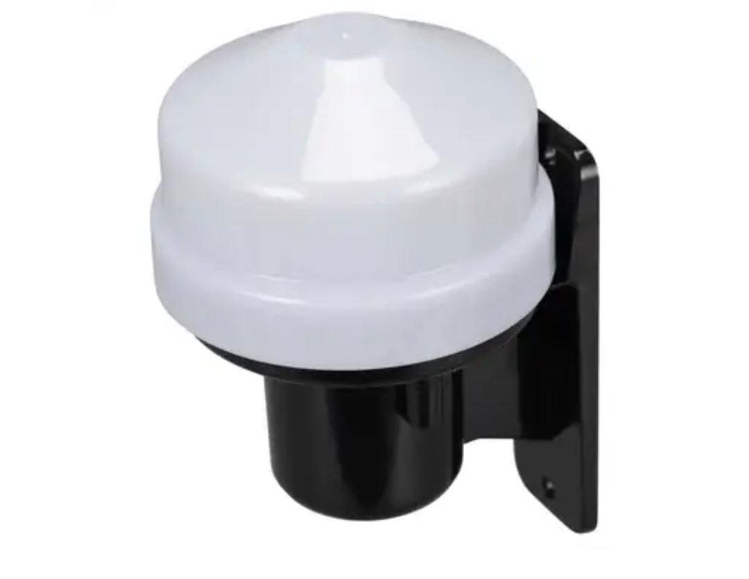

They look pretty old so could be knackered.....but is there one of these about
if so you could swap the head.....but my initial thoughts were timer somewhere
Optical sensor?

What makes me suspicious is that every light doesn't work. There are about 10 along the back wall.

Circuit breaker tripped?
I used to get called out regularly to a small block of flats. The post type lights attracted ant nests which in turn tripped the RCD or idiots who liked kicking them
There are two gate post lamps around ¼ mile from me, but they still light up my bedroom, if the turned off at midnight it would not be so bad, but I would think the owners are unaware of how annoying they are.
So it could well be that the lights you show, have also caused problems in the past, so have been switched off as a result.

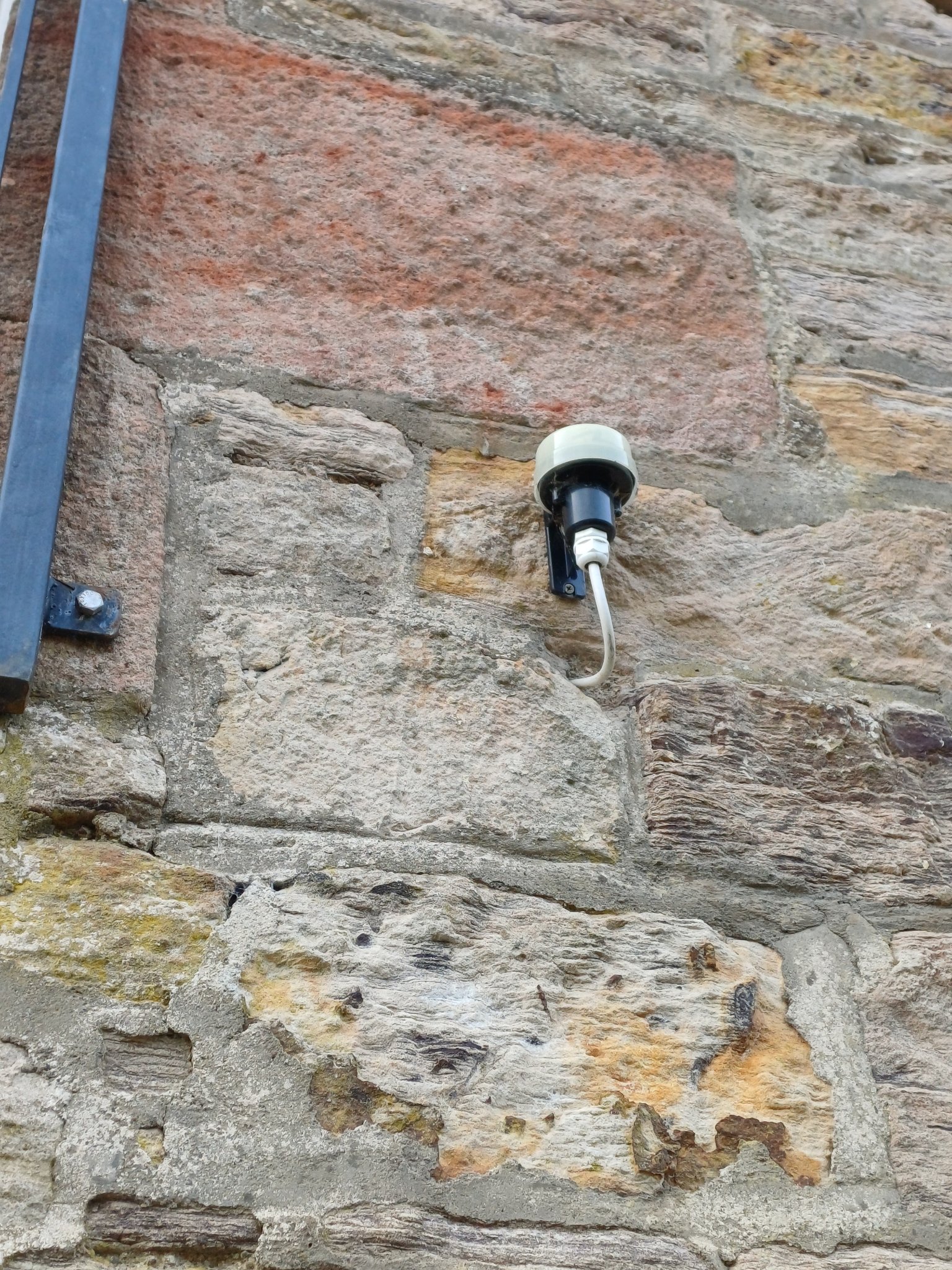

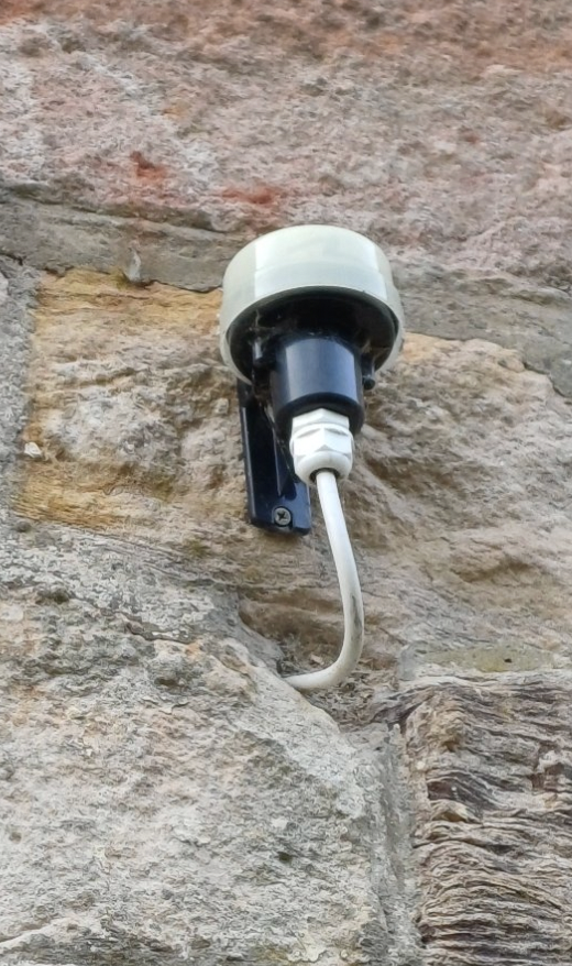

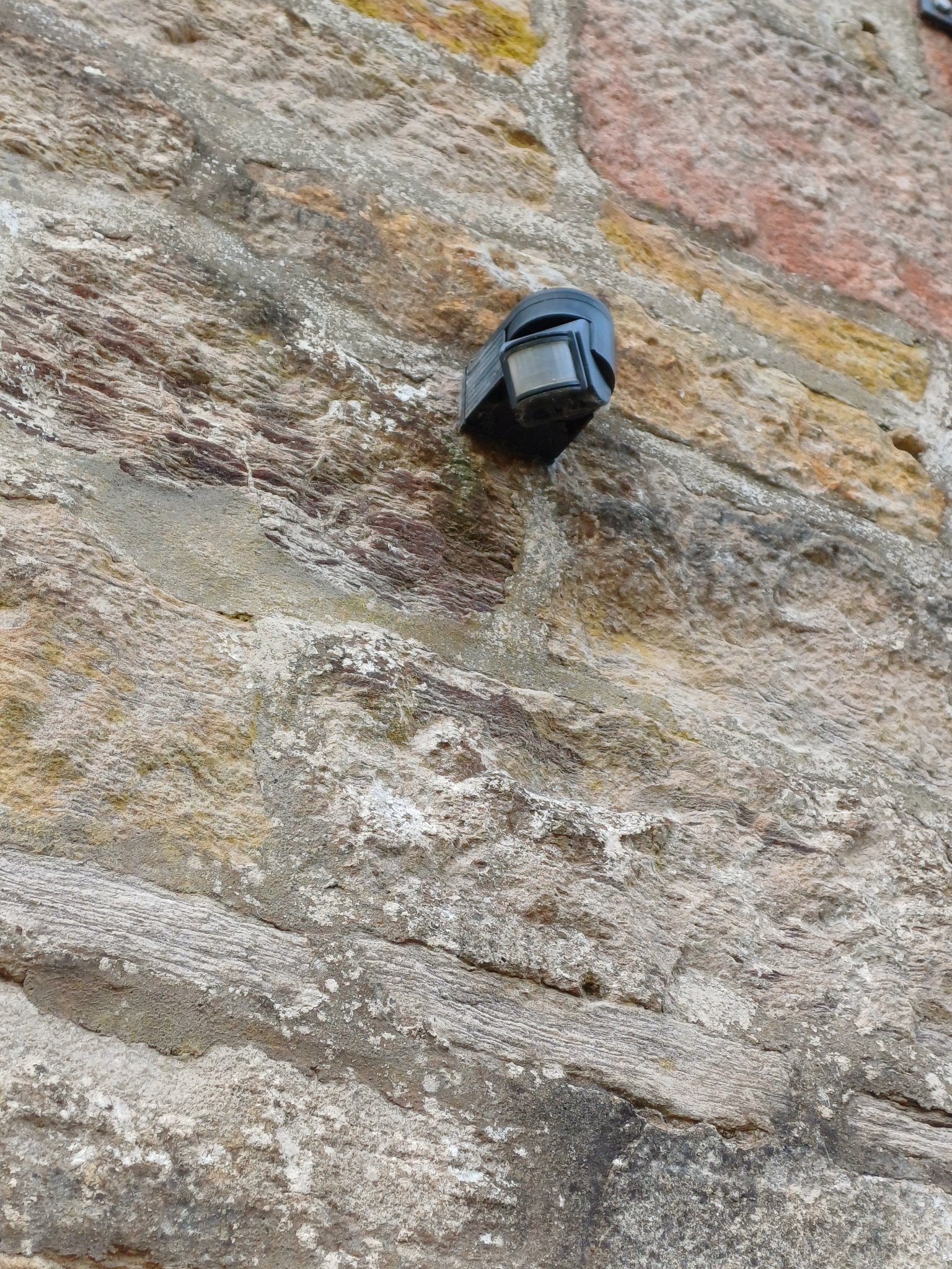

There's a PIR sensor just above the main door. I've absolutely no idea what its purpose is because it seems to trigger nothing. There's also another sensor like the one @pete01 described. Pics below. I suspect the lead from the white topped sensor almost certainly goes into the common electrics cupboard.
Can you reach to put a towel over it during the day?
If it's connected to those lights and is working, they should come on.
I'll try that, but given they don't come on at night I'm thinking it won't work. I've tried locating the wiring in the cupboard, but it's a mess of cables.

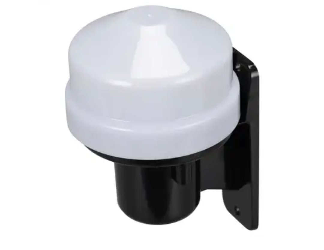

First thing would be to to swop the photocell and see if that fixes it. This thing
After that, given the unknown nature of the installation, where there might be an on/off switch for the lights, the mess of cables and (with respect) your lack of skill and - I guess - test equipment then you'd need a competent electrician to sort it. Probably first call is to the management company.

Did you find any circuit breakers tripped or switches turned off?
There may be a timer module in a fuseboard or a stand alone timeswitch. These can have switches that override the timer or turn it off.
Or you may find a double pole switch for maintenance purposes.
In a neat installation, all these things will be labelled, so it will be obvious what they are for.
