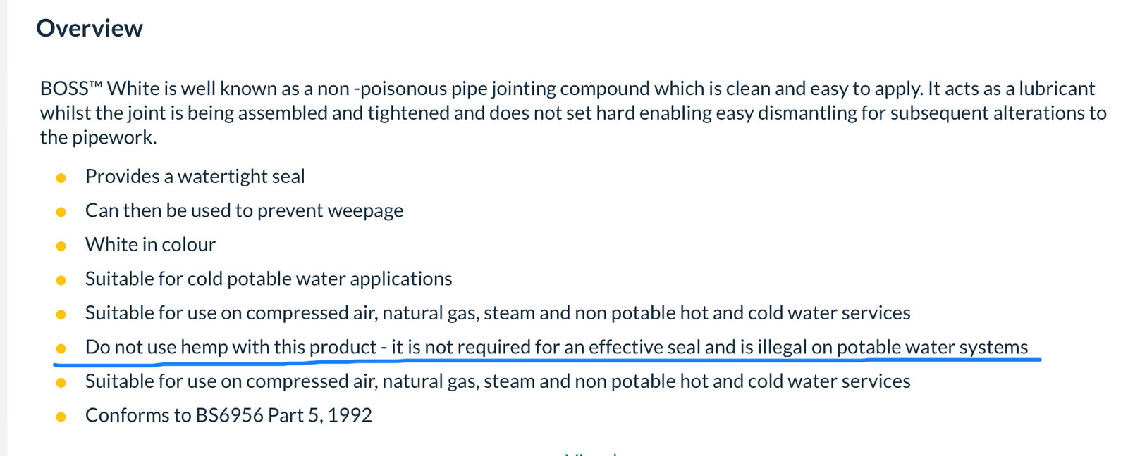

Has Bosswhite been improved? I thought at one time you had to use hemp with it, and with hemp it was no good for gas, as porous.
No idea, tbh I only looked it up as I thought you couldn’t use boss white on potable water (seems TP website could be inaccurate), we used to use boss green for this purpose.

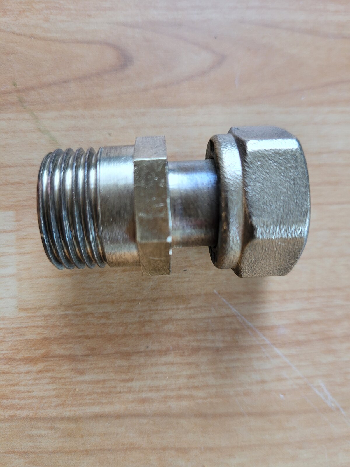

I know I’m bringing up an old thread, but can anyone tell me what this adapter is called please? I’m having a nightmare with an outdoor tap not screwing on straight, so it has to stop before the end of the thread is reached, and no amount of PTFE tape and LS-X is sealing the join. Fibre washers I have don’t fit. I just want to get one of these adapters and be done with it. Thanks.

Thanks. It seems my latest attempt with PTFE and LS-X is working, so hopefully this will work now. I had to wrap the PTFE around about 30 times, which is much more than everyone seemed to say reading about it. But the tap is a 3 quarter turn off being fully tight so I guess that much was needed to keep the seal, who knows. Anyway hopefully this works now.
