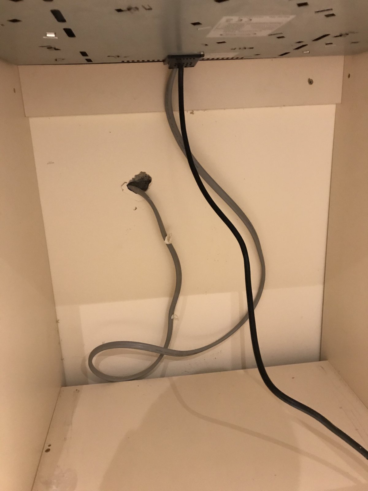

Hi, I was looking into getting an induction hob to replace the current ceramic one that is very cheap and doesn’t heat well.
I pulled out the oven to see what kind of setup was going on with the wiring and found that the oven is wired into the back of the hob (pic attached). I’ve swapped out an oven before and it was just a case of wiring it into the cooker connection unit, except that this place doesn’t have that and the wire from the CU is just coming out of the wall.
Is it safe to wire the oven into the new hob the way it currently is? If so then I could just wire in the new hob like for like. Or would I be better getting an electrician in to sort out a cooker connection unit?

Is the circuit a dedicated circuit?
What size cable is running from the CU?
WhaT is the value of the protective device in the CU?
What are the power requirements of the oven and the new hob?
10mm from the CU on a dedicated 32amp circuit. (With isolating switch on the wall beside oven)
Oven is 2.2kw
Hob I haven’t got yet but any I’ve been looking at are around the 3kw mark.

Although it might look and feel a bit ratty, there's probably not a great deal wrong with it, if anything at all.
If the cable and protective device are adequately sized, no problems there.
I would want to take a look at how the two cables are terminated in the existing hob, one's fairly large, the other to the oven, probably not, and are there additional terminals in the hob for looping out.
That's the existing. You need to confirm the same on any new appliances.
As Simon says, the supply would appear to be adequate for the hob+oven, but connections to the hob will only be meant for one set of cables. Given the high currents involved, trying to "loop in" has hazards.
The wall looks like a plasterboard stud wall. Do the job properly, fit a single deep box in the wall
and a dual appliance plate,
this allows the oven and the hob to be separately and securely connected
