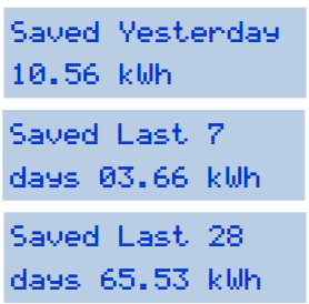

It depends on how much hot water is used, and length of pipe work boiler to cylinder and if lagged or not, because iboost+ records the energy used, I can say with my house immersion heater is cheaper to using oil, when the solar was fitted together with iboost+ we noticed the reduction of oil used.I got one, but when I calculated the RoI, if was not worth having. Cost of HW with gas is very low, and I only get worthwhile solar generation on (some) summer days.
Or an electric motor driving a given load. We discussed this in the earlier thread!ven if there is, say, thermostatic control of the load (e.g. electric heater, immersion heater
The iboost+ showsÌn summer I use less than 50p of gas a day.
Let's suppose I could halve that
For a hundred days a year.
so easy to see how much used, the oil boiler does not modulate so run time = energy used, and it is a 20 kW boiler, and it would run 4 times a week on ½ hour time slots, but after 20 minutes the return water was too hot so it would turn off, and ½ hour had expired before the boiler would start heating again, therm-syphon or C Plan is slow.If you need to find a tradesperson to get your job done, please try our local search below, or if you are doing it yourself you can find suppliers local to you.
