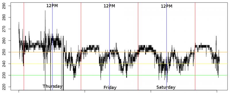

Where to start diagnosing high voltage spikes?
The high voltage is one problem and should be solved by a tap change at the sub station.
The large range of changes is a separate problem and suggests that the network as set up cannot cope with the variations in load that occur from a local heavy user of electricity. Setting supply voltage high enough to ensure voltage drop on the cable to the heavy user does not drop that user below 230 volt may be the reason your supply is so high.

It would help to add the start and end times to the graphs to relate peaks and troughs to events such as tea time kettles etc.
Updated graph with annotations. Hope it is clear:
I don't have a lot of ideas about the cause. We are somewhat near a railway line. We are also near Scotland's largest construction project: the new Forth road crossing. I asked the DNO engineer if that could be the source of the problem and he didn't think so.
I'm still planning to ask them to install a voltage recorder. It was suggested by the DNO engineer, who then decided to dig up the street instead.
The shape of the graph is fairly typical of what I see on a regular basis, just a bit on the high side, if the substation was showing similar voltages as I;ve said I would adjust it down by 2.5% (6V) which would put the voltage within optimum limits (don't for get it can go down to 216, but we avoid going below 220 if at all possible)
In some respects it's up to the DNO to show you are getting the correct volts, if the UPS was out by a large margin it would be suspect.
DNO engineer just visited. Again. I showed him my graph and he checked out the supply. Says it dropped from 251 to 240 which he said is odd. He's recommending a voltage recorder. So hopefully we'll find out if it is as variable as the UPS is suggesting.

Have you or your neighbours recently fitted any solar panels? As these have been a cause of excess volts all over the network
Funnily enough my brother was saying they are getting a lot more over-volts complaints now that embedded generation is increasing. Apparently management aren't keen on lowering the voltage a bit generally as that increases their losses*.

It's not that. As you go along the cable from supply to load, voltage reduces due to the resistance - Ohms law (V=IR), though there are slight complications in AC systems. Also there are losses in the transformers. Normally, all this is adjusted for at substations with "tap changers". There are multiple taps on the transformer so the output voltage can be adjusted, with changes being made by special make-before-break switches called tap changers (yes, this does momentarily short a few turns in the transformer during operation). I believe most of the tap changers are manual and will be set and left unless there's a problem.
Now, daily load, and hence volt drop, changes during the day, and typically results in the sort of voltage changes seen by the OP. In the early hours, load is lightest and the voltage rises. During the day load increases and voltage reduces. The exact pattern varies (ours is slightly different at work because we are in an area with large commercial loads and not a lot of residential load). Also, in a small hamlet, on the end of a long line, where several houses have night storage heaters you can get significant effects as they turn on and off.
But consider what happens as embedded generation increases - solar PV being the most significant in a domestic setting, but there are also wind turbines and small hydro. One of my customers at work has an 80-something kW hydro turbine connected to the 415V supply in the middle of nowhere - I bet that has an impact on supply voltage, especially if for some reason it trips when running at full load.
Instead of voltage decreasing between supply and load, it would (in theory at least) be possible for it to increase if the generation is more than the load. The aforementioned hydro plant will most definitely produce more than the farm and handful of surrounding houses use.
So that's the first issue - the supplier can no longer rely on a certain amount of volt drop.
But it gets worse. Renewables are highly variable - Solar PV drops to 0% output at least once per day. So the overall variation in current, and hence volt drop, in the supply chain is even more variable.

Looks very much like the graphs I do from our UPS. Except that we have a number of steps superimposed on the daily up and down which I suspect are tap changes at the grid substation round the corner.
Generally the automatic tap-changers are on the 33kV to lower HV voltage level with the tap-changers at the 400/230V transformers being manual and off circuit (dead).
We are experimenting with auto tap-changers at this voltage level to take account of local generation & the expected load changes as the gas runs out (whenever that will be).
