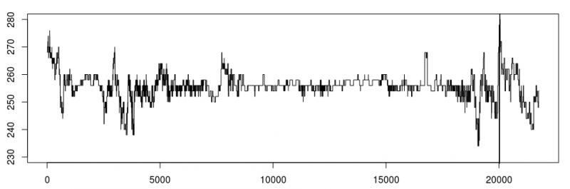

The first UPS I had was acting exactly the same as the new one. These are APC models and come with a certificate of testing (a receipt that looks like an engineer has signed off on it). APC support haven't been much help, but it doesn't seem to be a calibration problem.
Here is a graph of overnight.
DNO engineer reckons its probably a problem their side. Couldn't find anything particularly wrong here, so he's off to the substation. Then talk of installing a voltage recorder. He seemed pretty certain it's not a problem with the UPS.

Here's the chart with 253 & 260v marked.
The chances of anybody putting a meter on it and saying anything other than "No, it's fine", or "Well, it's a bit high..." are low.
Like I said, the DNO seem pretty sure it's a problem outside the house. Hence them digging it up today. The engineer reckons it'll be sorted by tonight.
The replacement UPS was a different model, same make. I think it's unlikely that they're both suffering from the same problem.
The engineer seemed certain there was a problem as the hall lights he was stood under were flickering.

Hmmm... Here's the chart with 253 & 260v marked.
Eh? I think you must understand me. I was suggesting that, as your lines on the graph show, if those figures are correct, then the chances of someone putting a meter on it and find a voltage <253V (and therefore declare that "the supply looks fine") are pretty low.
