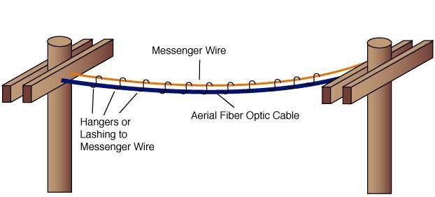

Struggling to find a decent picture. He's talking about catenary wire, basically a 3mm steel rope that would run from the wall to the shed (slightly above the cable) and this then supports the weight of the cable - stopping the droop in the middle and relieving the cable of stress.
Some limited info here

Joking aside, they're referring to a messenger wire. It's to take the weig of the wire, and avoid any future hazards, one being that it's not pulled out of the end where it's connected.
Thank you all so much, I get the idea now, the existing cable is a heavy looking round black cable and weighty, the picture helped and also the link. I have never heard of catenary wire before but it makes prefect sense now. You see in my mind I was thinking if it needs support ito put it in a plastic sleeve like a piece of waste pipe with a fixed bracket at each end, no wonder I didnt have a clue what the guy meant thanks again.
