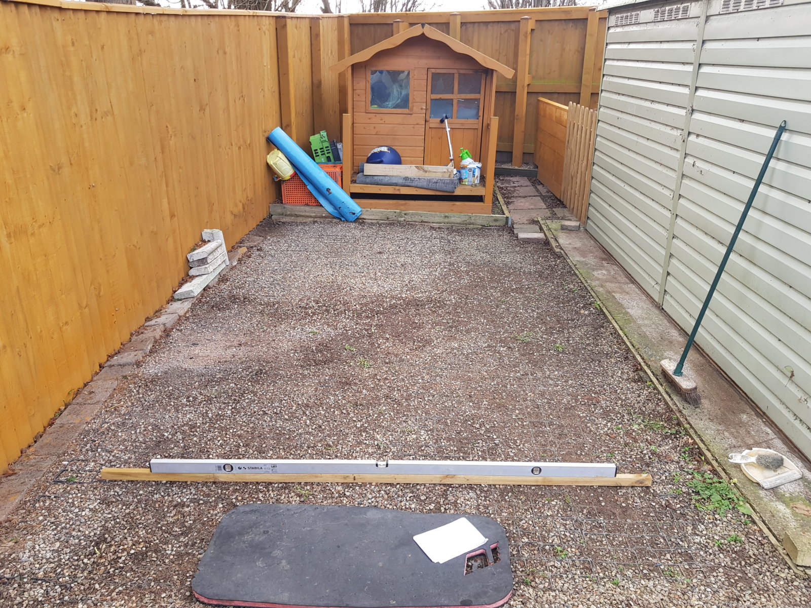

Hello all, just ordered a 7ft x 13ft wooden shed to go next to my metal one (can't have too many sheds!).
Base wise at the moment I have 50mm high plastic grid down filled with 10mm gravel, good solid flat base with good drainage.
I was going to just build the shed base directly on top of that but thinking about it would it be best to lift it off the floor a bit, even 10mm to 20mm just to let air circulate underneath.
Whats best thing to use to pack under the base, plastic packers of some description?.
It will be used for storing suff mainly, my shed next door with concrete base will be reclaimed to use as my workshop again hopefully!.

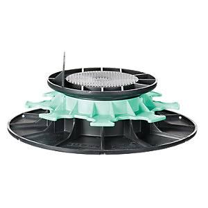

I've see some adjustable joist supports from Wickes, would 20 of those do?.
Am I just overthinking things or would it be a genuine benifit lifting it off the floor, don't want to waste time and money if not..

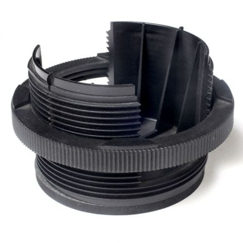

These don't look bad, support 700kg per m2 apparently.
[Found them on Amazon - just the job @ my place
The adjustable feet are a good idea ,set them all level and drop the base onto them.
As long as they are in the right place I can't see any problems.
Did the sons summer house the same.
Then added a deck board skirt..looked great
they are going to be expensive the timber will need supporting every say400-700mm on every timber
if we assume 5 floor joists across the front at 0-535-1070-1605-2140 so five and say 6 or 7 along the length is 30-35
also timber on the floors is likely to be around the 38mm deep so will require the feet to be wound up nearly fully to allow a few mill off adjustment assuming the slot type

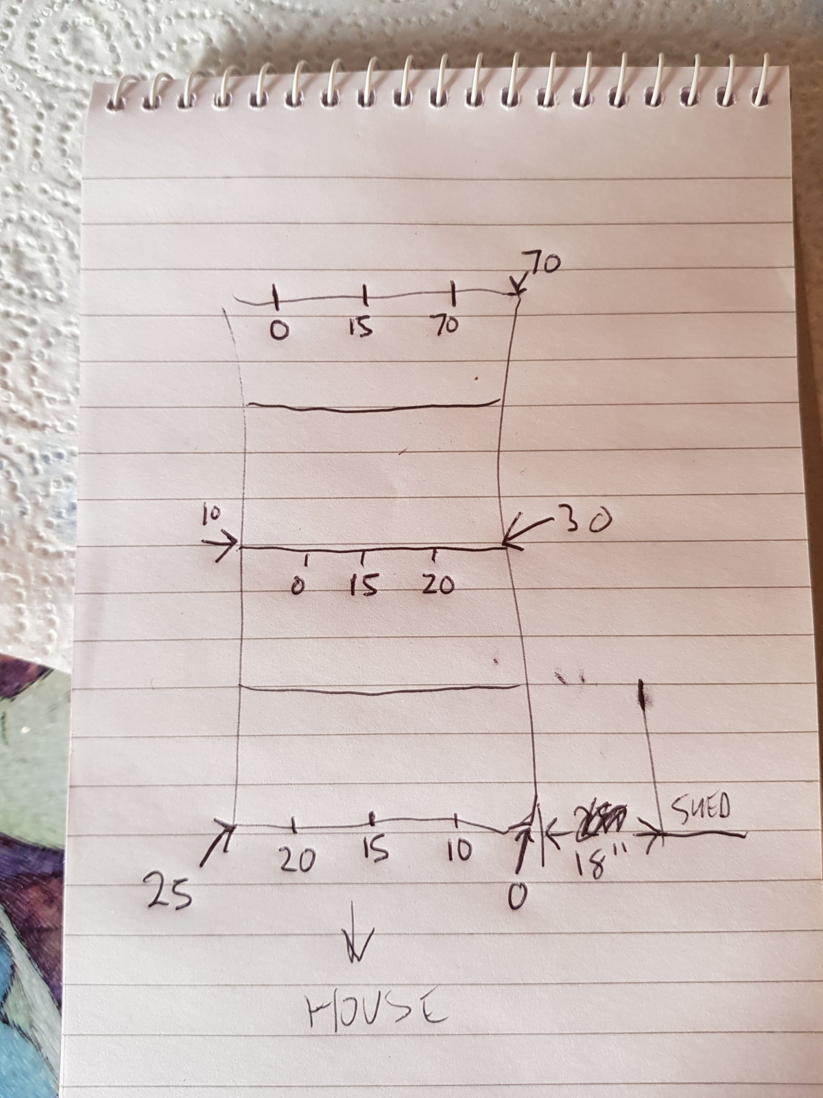

Spent this morning clearing the space and raking the gravel back down to flush with the grids, it's been down probably 8 years now so not going to move!.
Took some measurements and I'll need some sort of level adjustment so will go with those in my picture (and plenty of them!).
Suprisingly it's dead level front to back down the middle which is a bonus.
There's one corner thats a mile out, might set a paving stone down for that one and finish off with the adjusters.
Shame nights come in early, depends when it turns up next Monday but I might only get chance to lay the base level then have to wait till Sunday to crack on again.
