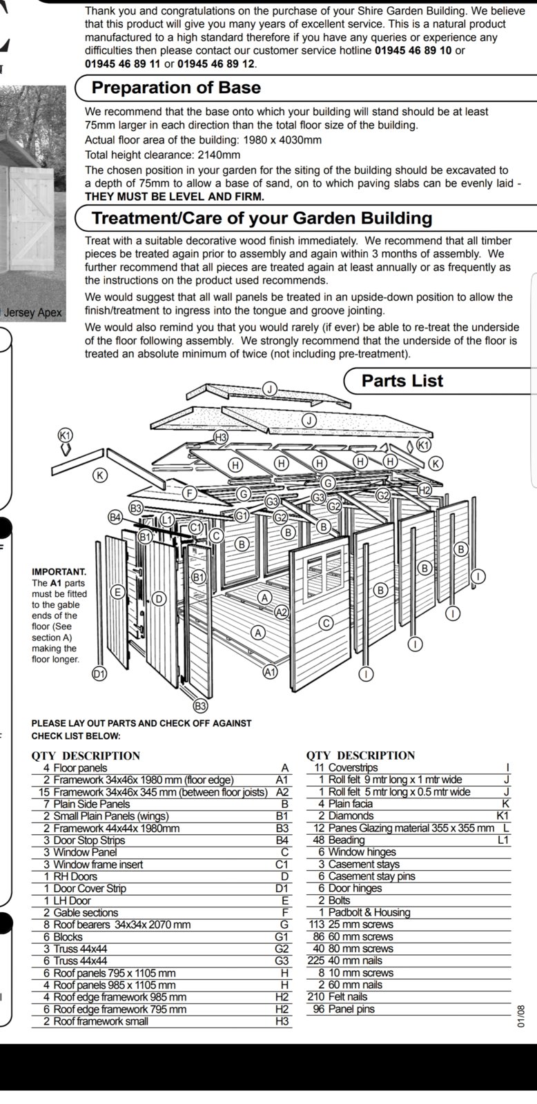

Managed to find the instructions and the floor is in 4 sections, 6 joists per section.
I've ordered 48 joist supports, 2 for each joist on each section.
Will have to build it from the back forwards I think and level as I go, won't fasten the sections until is all level and sturdy.
Looks like a bit of a pain but worth the effort as it was just dead land and I need the storage space!.
you need one at each end and one every say 400-700mm
so assuming you have one at zero and one central and one on the joint you will be 6 short
Yep you're right, I've got some hardwood that I might end up using to make the outside supports but will order another 6 to be sure!.
