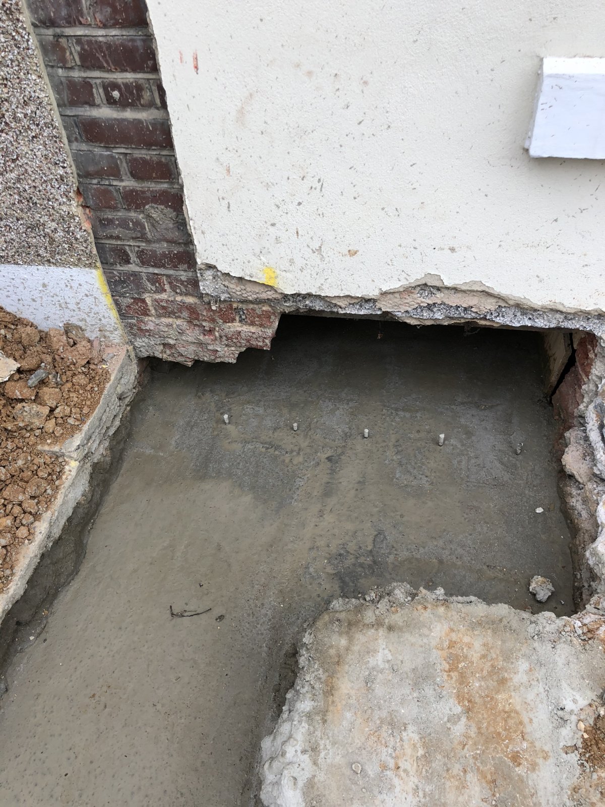

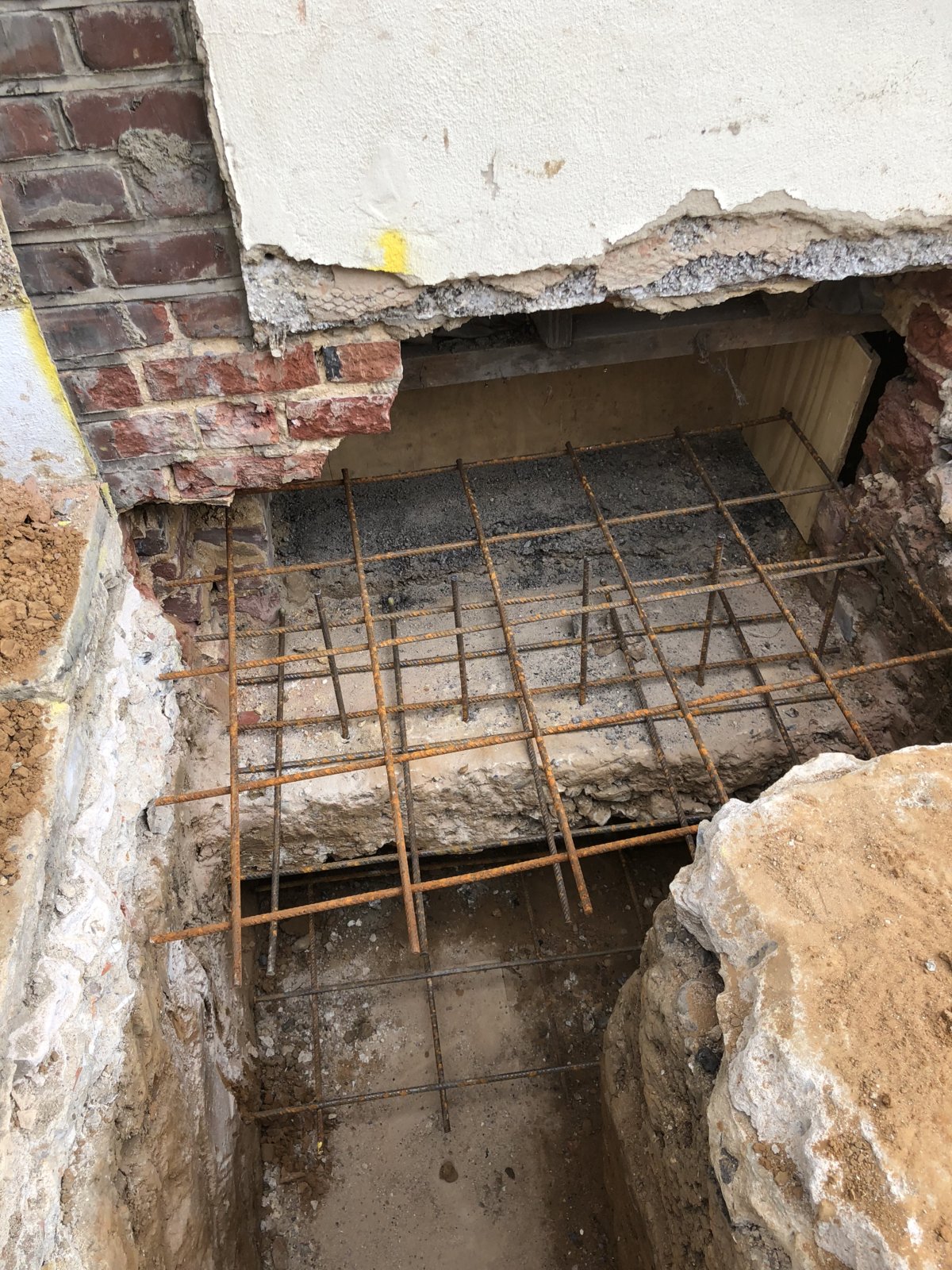

Ive attached a before pour and after pour. BCO have asked it to be poured 1m deep and the builders dug under the existing pad by 1m. To envelope the existing pad. The bit I am worried about is the stuff between the shuttering and the foundation.
To be honest if I was to do this myself, I would probably have broke out that foundation and had a full pour for the pad.
“Sigh” I’m not very good with this contractor game, hence I would try and micromanage or do it all myself. Probably would have been simpler to say, get a builder in and just dig a hole this size. And done.
Once these guys are finished. Is there i possibility, I go on the other side, dig out the breeze block oversite and just fill in 0.24m cubed of C35 concrete with tied in rebar?

Frankly I'm surprised the building inspector approved that.
It will be impossible to fully excavate under that existing foundation so they have probably only gone back as far as they could reach with a hand trowel. It will be extremely difficult to get the concrete to fill that void and if they had a wet mix you will get shrinkage and a gap between the new concrete and existing foundation. That thin mesh reinforcement is far too weak to compensate for the inadequacies in the pad excavation. Your instinct was right, they should have broken out the old foundation and done it properly.
I would only hope that the engineer has massively over engineered that pad design so that the point load from the column will still be within safe tolerances.
I have written confirmation from the SE about enveloping the existing foundations and he was happy to confirm it is suitable if we tie rebar into it.
However in this situation, as we didn’t envelope the foundations on the inside, I believe the confirmation would be void.
