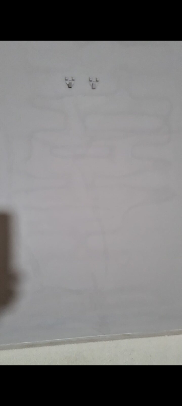

Help!!! So decorated my chimney and got this very strange snail marks. After 3 coats it will not disappear how can i cover this. The wall was sanded down before painting but lightly. Advice greatly appreciated

@Kat1988 please take another pic, standing back to show the whole wall from ceiling to floor. Include something to show scale, and measure some of the marks to see if they are brick-sized rectangles.
If it is a chimneybreast it needs to be ventilated or the flue will be damp inside from condensation.
Apply a stain blocker like Zinsser Bin and then paint in your chosen finish.
Was there ever wallpaper with this kind of pattern?
Sometimes, when plastering, the bonding coat has a series of wavy lines scratched on it before applying the finish plaster, but the lines don't look 'natural' enough to be that.
Very strange. It could be a caulk someones used, or a bonding gun or someone has filled cracks at some point. Although the pattern doesn't seem to suggest any of those. As said above, some zinsser should solve it!
At a guess... perhaps there was a mirror that was glued to the wall at some point. The marks being the caulk/sealant.
I too would recommend Zinsser BIN. Oh, and buy some household ammonia to clean the brush with.

it might have been a fake stone cladding applied to the plastr.
But it looks like we are not going to get the helpful photo I asked for.
