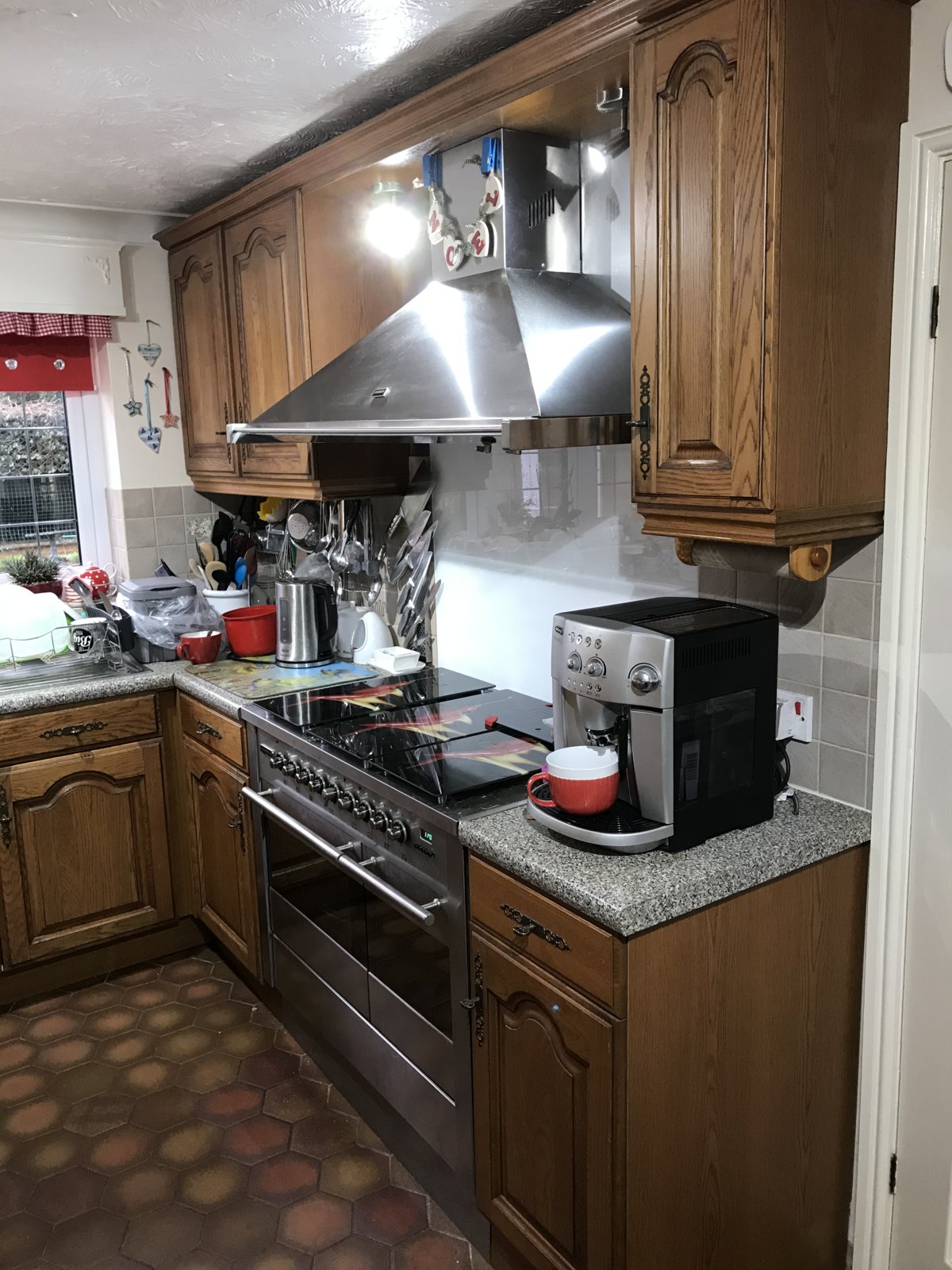

About to paint my kitchen doors and side panels which are oak and would like to end up with a white or cream colour.Would appreciate in help and what is the best way of doing this and what paint to use.

First thing is to wash down the doors and panels to remove any grease.
Once dry sand thoroughly using 120-150 grit paper. I assume that the doors are either varnished or oiled. If you don't sand them enough the finish coats will be prone to chipping off.
I would then apply a coat of Leyland Trade acrylic primer and then sand that with 220 grit silicone carbide paper.
Although I am not a fan of waterbased eggshell, it will dry much faster than oil based eggshell. 2 or three coats should be sufficient.
The end panels however are likely to be laminated. I would recommend priming them with Zinsser BIN and a small mohair roller. Do not use a foam roller, the alcohol in the BIN will make the foam roller go floppy. Clean brushes and rollers with household ammonia- it is slightly alkali and completely breaks the paint down rather than simply diluting it.

Thanks for replying,think i just needed reassurance as the more i read into this the more options there seemed.Used to be a painter and decorator for about 10 years about 30 years ago.I must admit that i always liked oil base paints but white always seems to go yellowish.Will probably invest in a hvlp sprayer to do the top coats and that’s another minefield of information to find the right sprayer.
My HVLP is an old Fuji 3 stage. It is fine for acid cat but would struggle with waterbased. If I need to spray oil based finishes I add Owatrol.
If you do go for waterbased an airless sprayer might be better. eg the battery powered Graco. Not cheap though at £500.
Although I have used acid cat on many occasions and love the fact that it cures soooooo fast, I cannot not in good conscience recommend it because of the risks to health. Spraying cellulose with a HVLP would be safer.
