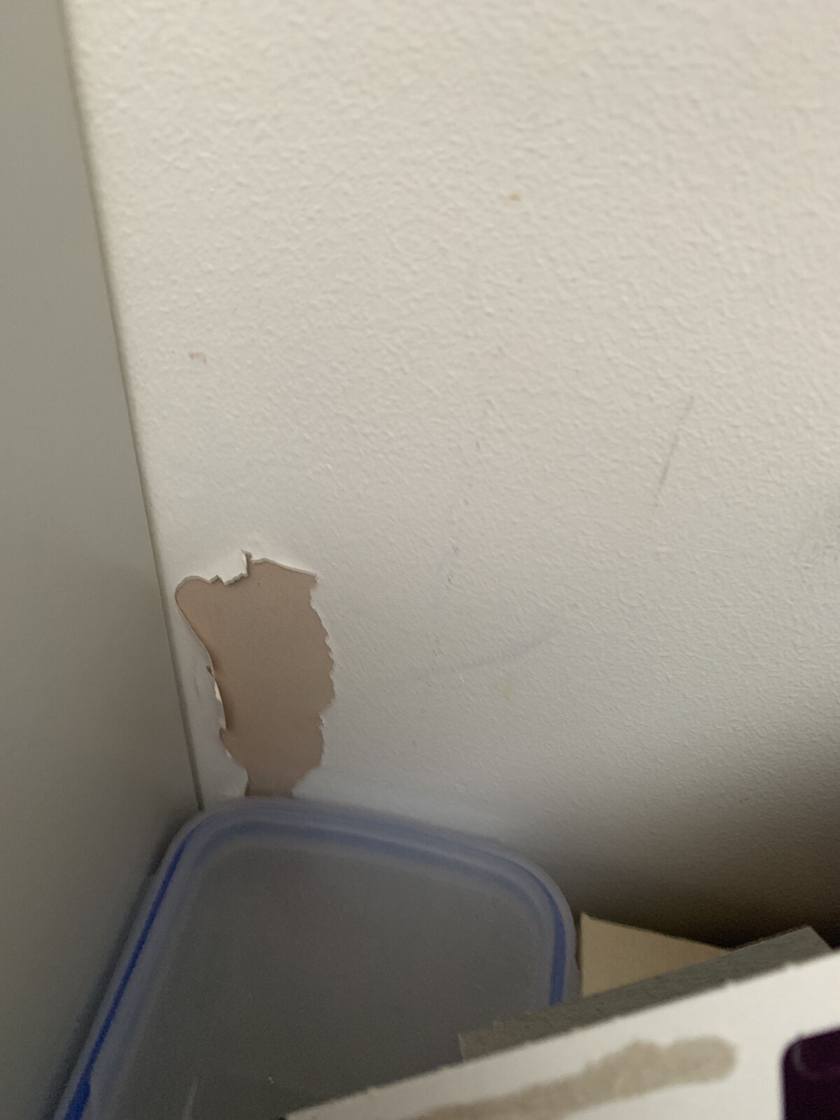

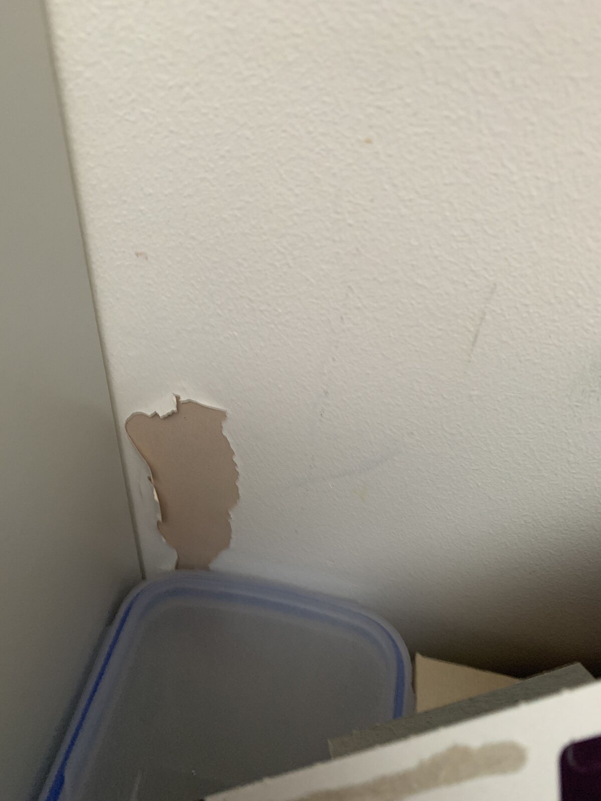

I have a large kitchen to paint in the next few weeks. It was last painted by the previous owners, maybe 8-10 years ago.
As can be seen in the second photo, some of the paint has peeled off. The same sort of peeling has occurred in a few small places in the kitchen.

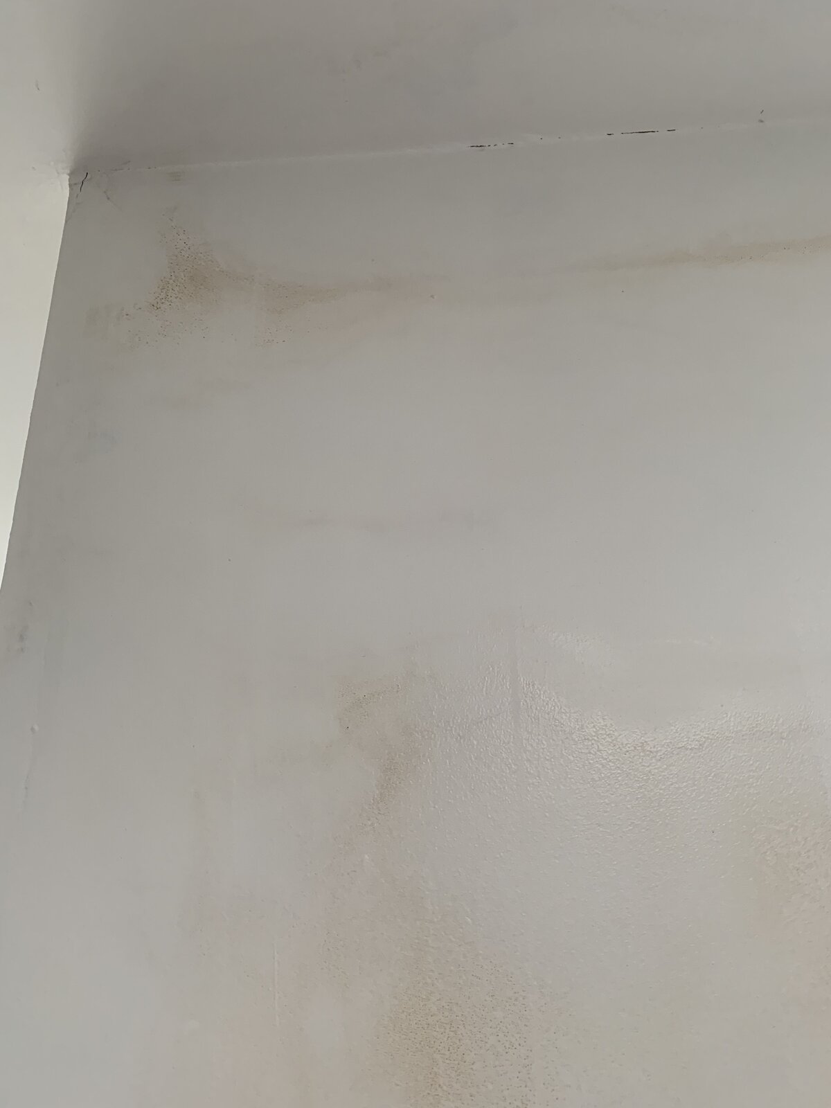

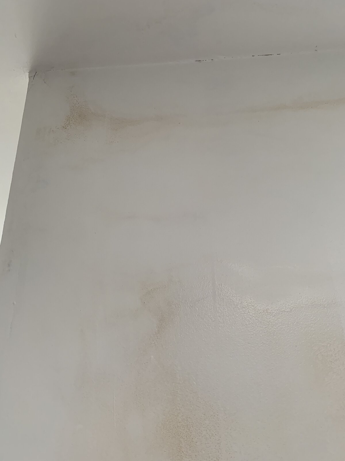

As can be seen in the first photo, there are some brown water marks from a leaky roof - this has now been repaired.
I therefore have two "problems" here to deal with in terms of achieving a good, consistent finish throughout. Can anyone give me any tips?

Zinsser BIN the water stains.
Then emulsion.
It maybe condensation on the other peeling paint areas by looks of it. Low corner spot gets no airflow.
Don't look like it's damp as plaster looks fine vs salts and stains
It could also be that they put a silk/satin/eggshell paint on- is the paint that's coming off slightly more shiny than ordinary Matt emulsion? Or if you paint over it, does it start to bubble or peel? If it does, that sucks, because you'd probably need to sand it (or scrape it) so you can start again. Hope you can get it sorted easily
Thanks for the help! I'll investigate the peeling paint a bit more, I am not too sure.. it is only a tiny proportion of the whole kitchen so I don't want to scrape everything off.
You could try just sanding the affected area and seeing what happens or doing what Wayners suggested? Very best of luck with it, whatever you choose to do
Given that it was a long time since the last painting, paint peeling isn't extraordinary. You can simply peel off as much of the paint peel as possible and repaint. If the peeling is persistent on a dry surface, then you can use primer. Nothing can stop the peel on a substrate surface that gets wet.
