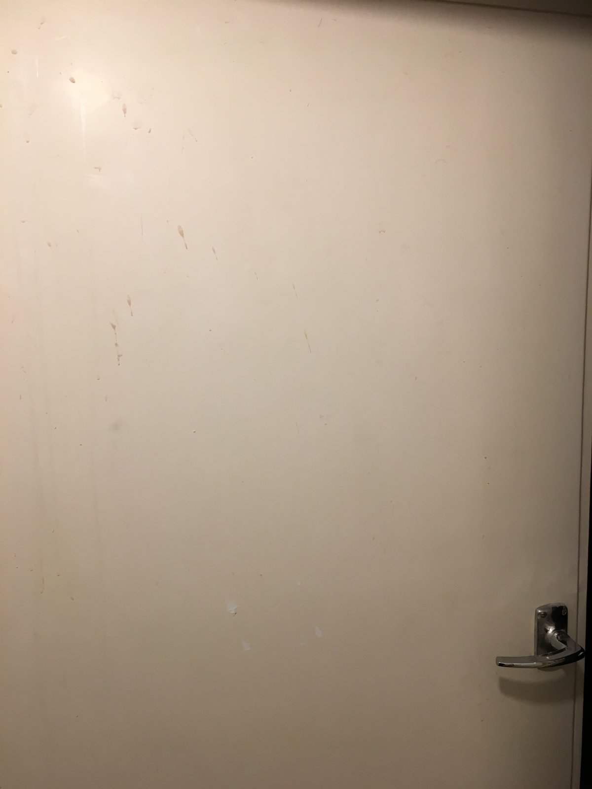

Hi,

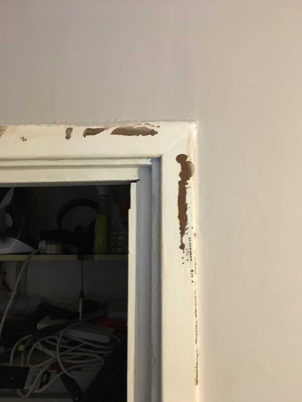

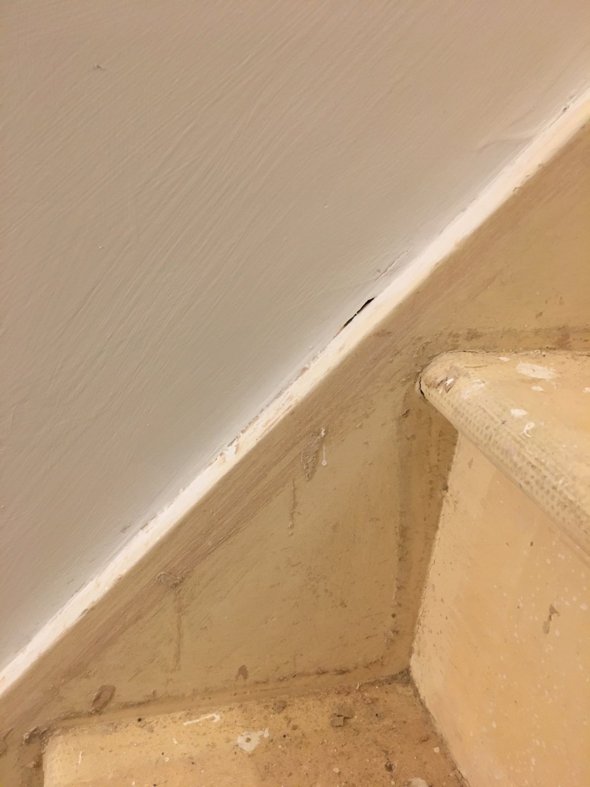

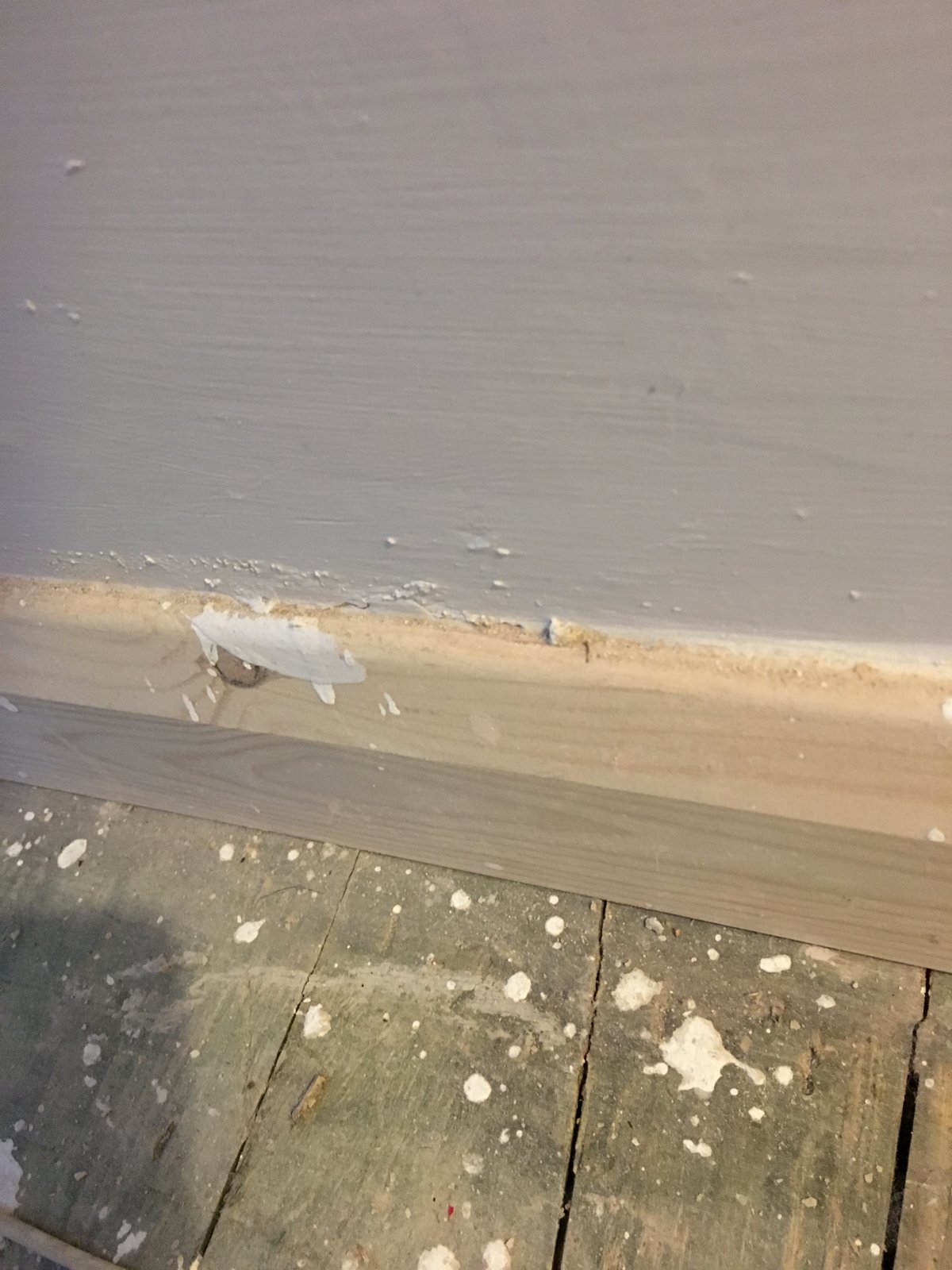

I have lots of woodwork to paint; door frames, skirting boards, doors, etc.
The door frames already have paint on them and so do the skirting boards on the stairs. The skirting boards in the rooms are new and plain wood with no paint (but for a few drips) all shown on the images below.
We had a painter come and do some but I thought I could save money by doing it mysel. I asked him what he did. He said he used “Quick dry undercoat and painted after with quick dry high gloss dulux”, but I’ve read bad stuff about quick dry. He just went over the existing paint and I don’t think he sanded it down. If it’s that easy great, but is that the right way to go?

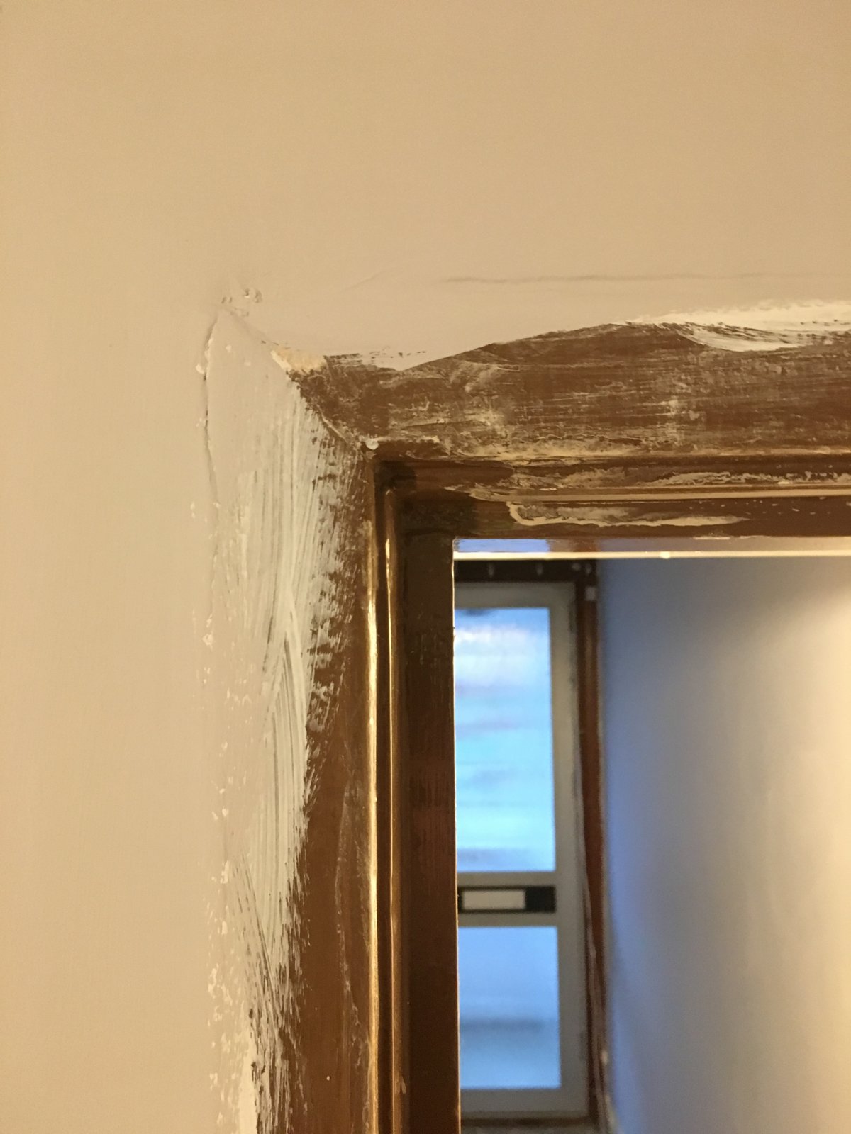

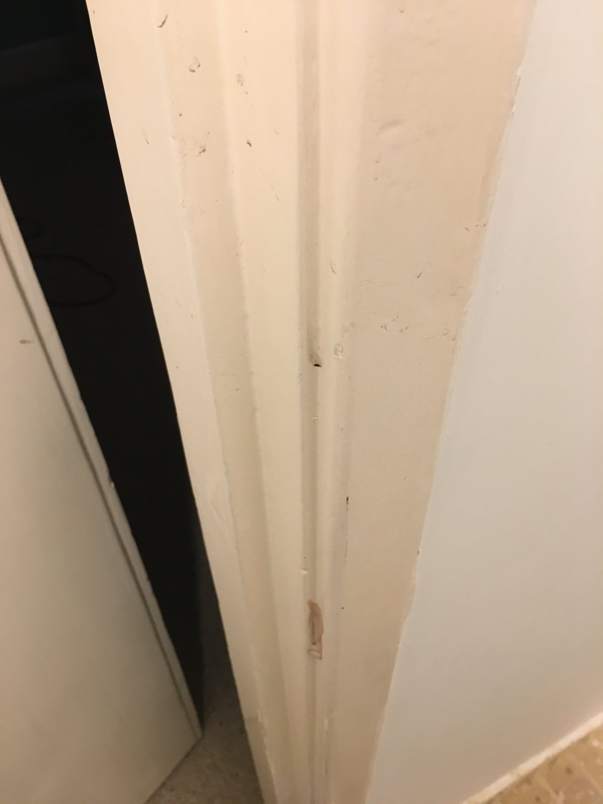

The door frames have quite a lot of paint that’s overlapped from the walls, as you can see from the fifth picture, so how do I get this to a tidy finish?
TIA.

Previously painted :- firsty wash down with 'Sugar Soap' then once dry 'Key' with course sandpaper to remove the existing loose paint. Use a fine dust breathing mask whilst you doing this!
Now is the time to fill any imperfections if you wish to. The imperfections will lneed more keying before being filled. If you do fill then allow 24 to 48 hours to dry and smooth off. Dust off with a 'Tack Cloth' or a damp soft rag. Undercoat with your choice of Undercoat - unless you have large patches of now bared timber. 'De-nib' with fine sandpaper (between all coats) and then 2 coats of top coat.
Bare timber :- fill any imprefection or gaps; sand any paint splashes off. either 'prime' with Aluminium Primer or use knotting on the knots, then prime with 'ordinary' primer. Then paint as above but possibly with 2 coats of undercoat.
As for the final picture. The plaster finish looks to be flush with the top of the Architrave... Is the skirting the same - effectively a flush wall? So a choice, additional architrave over the existing (and the same for skirting) or carefull rubbing down to bare wood and paint carefully - even use masking tape to get a straight edge.
Sorry, I'm a little ignorant here. I'm not completely sure what flush means? We had the walls plastered, then wooden skirting boards fitted, and I painted the walls, with some paint dripping on.

Can I check with this, with bare timber, do I prime using primer, then undercoat then paint with top coat? I've knotted, just need to know what's next. Thanks.
You can get combination primer+undercoat which may save you some time now you've knotted.
But FYI one of the best primers you can get is Zinsser BIN. It can be used for knotting and will stick to anything -wood, old paint, uPVC, oil slicked sea birds, you name it. Then just undercoat and top coat.
Cheers Gerry. I've already bought my primer and undercoat separately unfortunately, so I guess I'll prime then undercoat then top coat, yes? Cheers.
