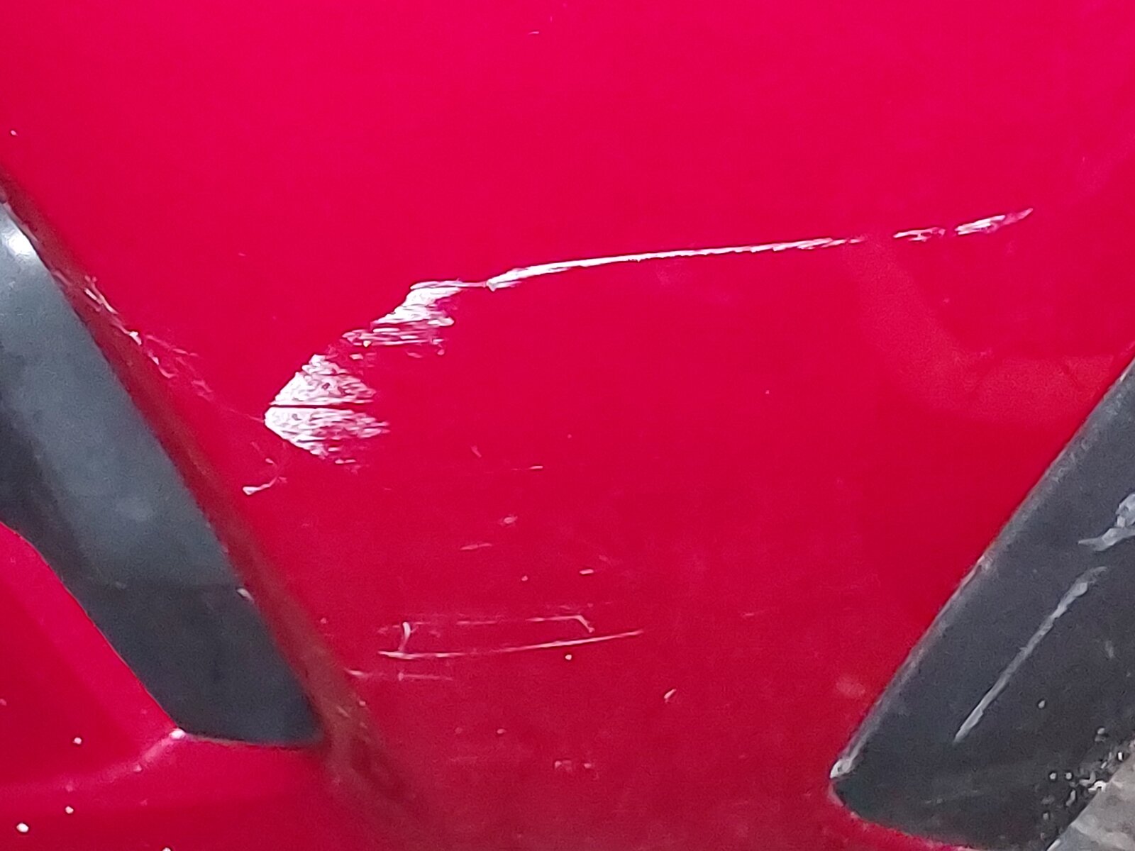

JohnD Joined 15 Nov 2005 Messages 98,812 Reaction score 8,836 Location South Country 26 Dec 2023 #1 Some drunk (presumably) bumped my car and left their white paint on it. I believe this can be polished off, but how do I minimise damage to my own paint?
Mottie Joined 27 Feb 2017 Messages 55,659 Reaction score 14,538 Location Essexshire Country 26 Dec 2023 #3 If you cant feel the scuff with your nail, a good cutting compound followed by a layer of wax should sort it.
JohnD Joined 15 Nov 2005 Messages 98,812 Reaction score 8,836 Location South Country 26 Dec 2023 #4 Looking at it enlarged on the screen, with flash, it looks worse than I thought. I think the paint looks cracked. The drunk must have been racing out of her parking bay.
