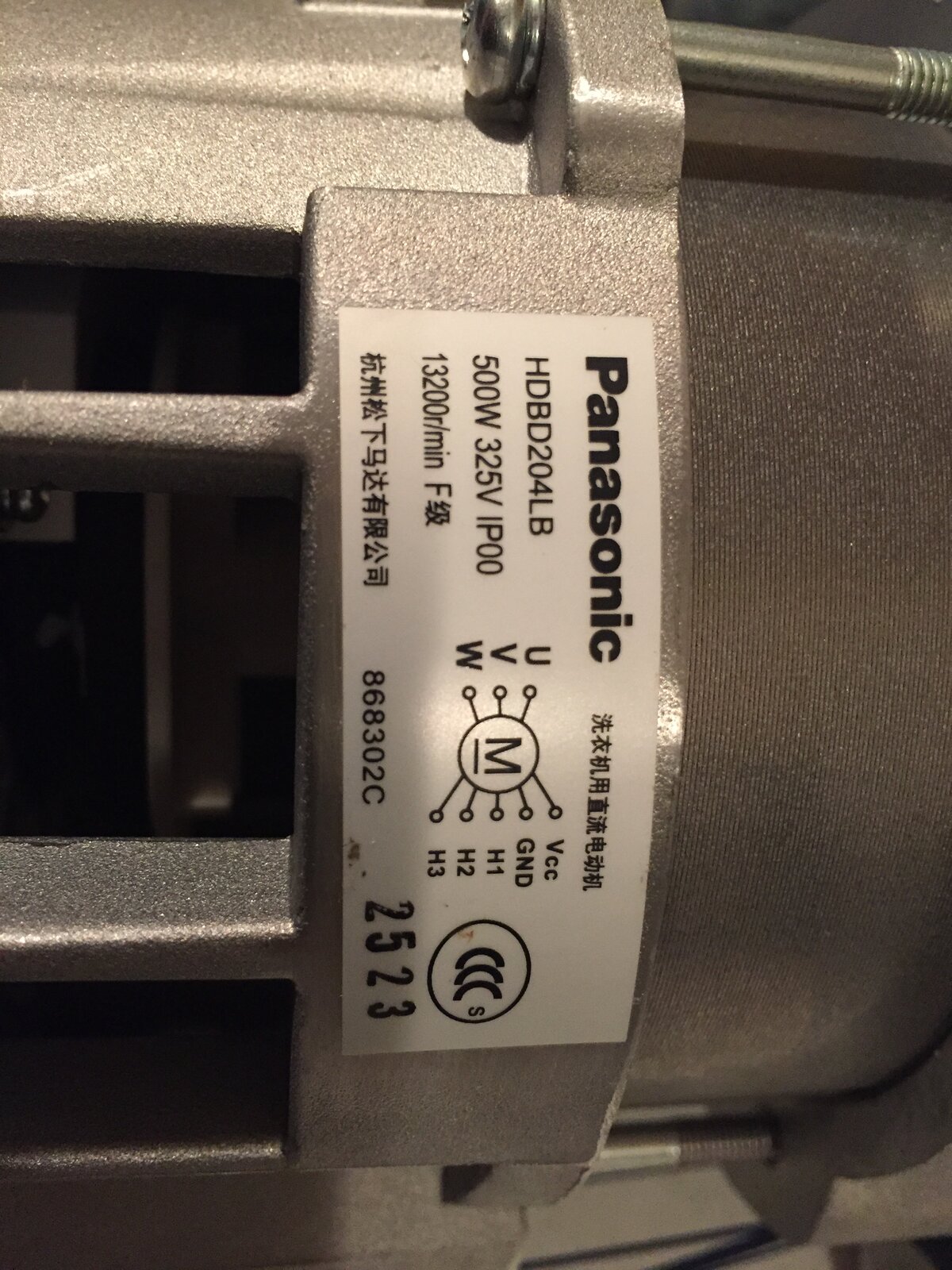

I placed a moderate load in my Panasonic Washing Machine NA-168VX3 but noticed after a while that the drum does not rotate but just moves right to left continuously but never completing a complete revolution like normal but moves right to left 30 degrees only in a jerking fashion!
My first thought are has the drive belt broken? If so I have had a look online but cannot find a drive belt for a Panasonic Washing Machine NA-168VX3. There was an error code but did not capture the code and any programme now the code does not show up but drum behaves the same!
Is there a substitute belt etc that can be bought and if so from where?

Too the back panel off, the drive belt is fine and attached correctly. Ran washer on a spin with drive belt disconnected but Motor made some slight jerky to and fro moments!
With belt disconnected spun the Motor pulley BUT the spinning action is very notch and jerky almost as if there is a flat spot on the commutator???
Does this mean that the motor is finished or does it need new bushes etc?
Water enters and exits the machine correctly
Took motor out, it now spins freely no jerky movements. The motor is a Panasonic HDBD204LB - 500W 325V IP00 m13200r/min
Re-installed the motor and when the electricity is connected the motor spins feels jerky again! Is this normal?
Is this a brushless Motor???
Many thanks
I cannot tell you if it is a brushless motor or not but a search fails to throw up any replacements so it may well be brushless. Your latest post suggests that if it is brushless then you are perhaps getting a permanent supply to one of the field coils when power is applied to the machine. This does not sound safe to me & my guess would be you have a faulty control pcb. Given parts do not seem readily available for your machine I don't think I would invest any time or money in it. Sorry I could not be more helpful, perhaps someone else will have more knowledge about Panasonics & follow up on here.
Thanks JJ4091 for your informative post and yes PCB & Motor are hard parts to get hold of and extremely expensive so mayn't be economical!
Anyone know how to test this motor to determine if indeed it is faulty?
Can it be wired to power up out of the machine for test purposes? The motor is a Panasonic HDBD204LB - 500W 325V IP00 m13200r/m
Photo of motor label attached if it helps?
Many Thanks

There is a guy breaking a Panasonic machine for spares & is selling 2 motors on e-bay who says he bought a new one that did not fix the problem. Suggests to me perhaps the pcb's fail, but he does not seem to have one of them.
HI JJ4091
Yes saw that on Ebay and also messaged the gentleman and yes indeed it appears to be the dreaded PCB Fault! Have consigned myself to buying a new machine as the PCB is approx £300 to £400!!! Makes no economical sense to buy at all and make this another throw away appliance! What a waste such a nice machine solidly built and functions beautifully when it works!
