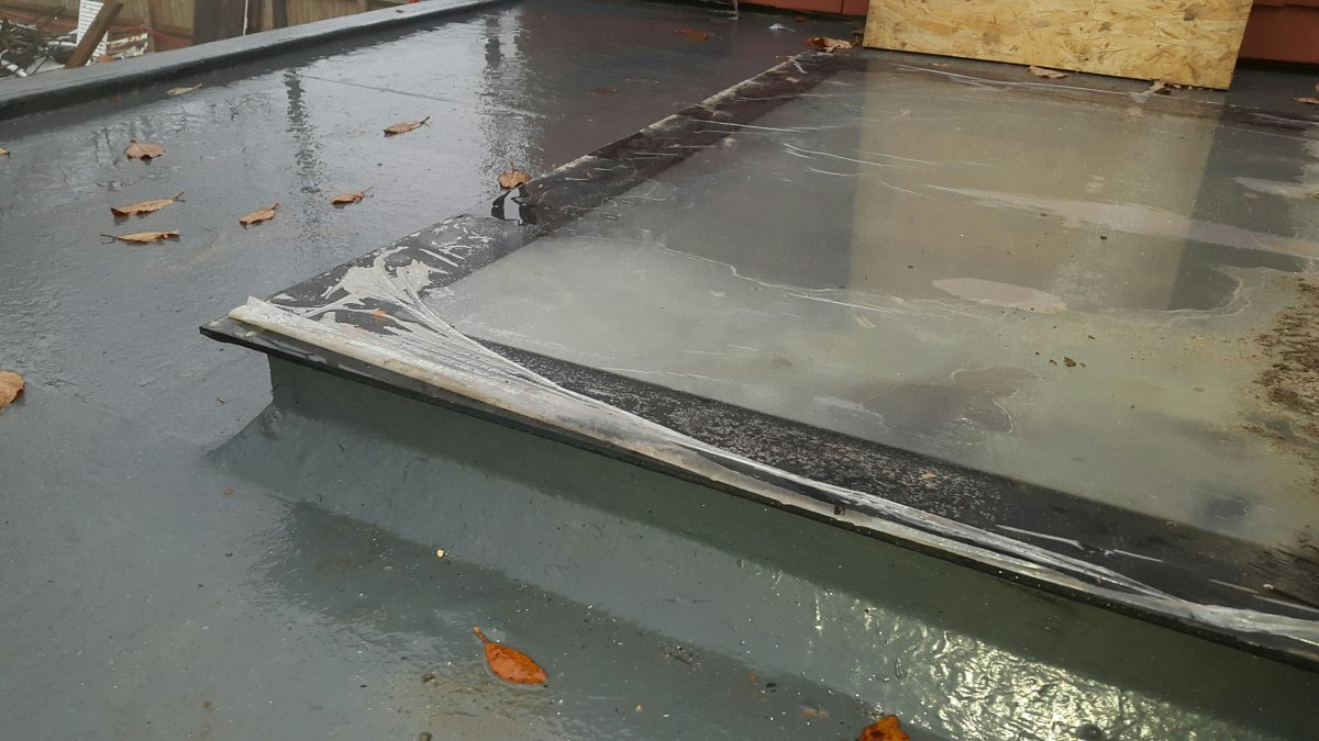

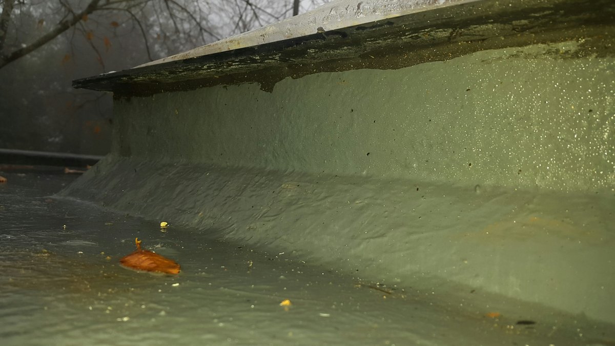

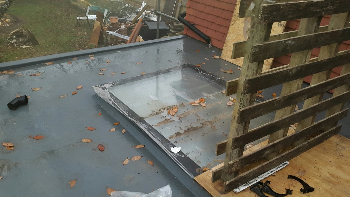

    Hi. we're still building but it is fitted. ours came with the wooden frame/kerb and we bought from ebay. it has a visible glass area of 1m x 2m.
    Installation was easy - build up a small upstand etc then add the frame/kerb. we had a grp roof that the roofer lapped up the side if the kerb as per instructions.
    To install the glass... lots of black glazing silicone and drop the glass into place... again very easy. several trades said they wished all skylights were as easy to fit.
    It is very low profile too on the roof which we needed.
    So far no leaks - even in very heavy downpours so looking good. can't comment on thermal performance yet as not got the heating going again yet.
    At the moment I think it was a good purchase... will try and post some pics before I head off to work.

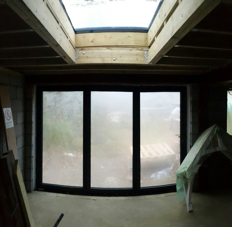

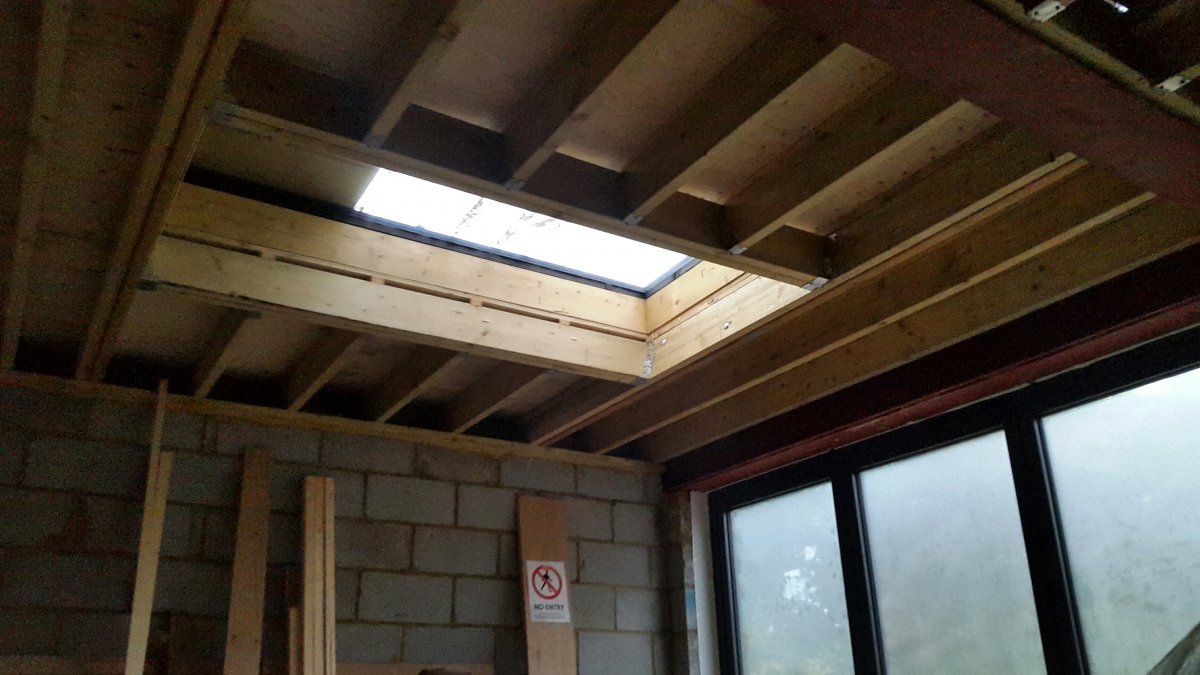

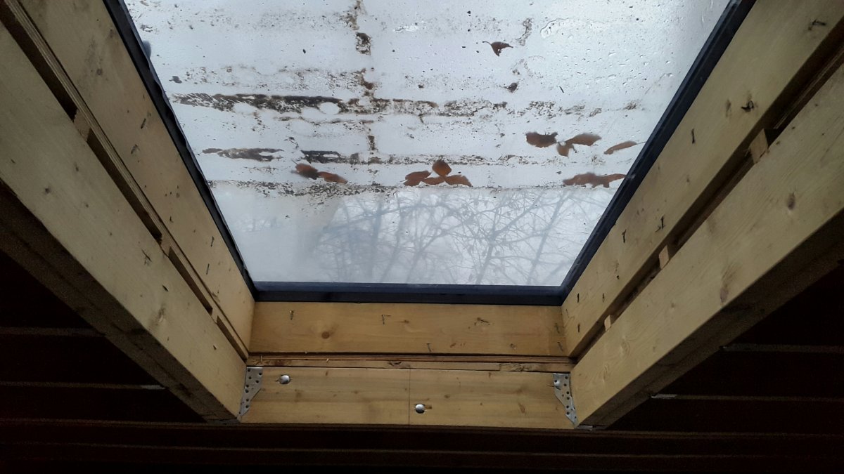

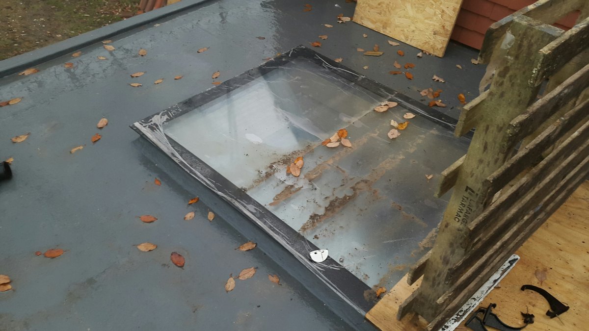

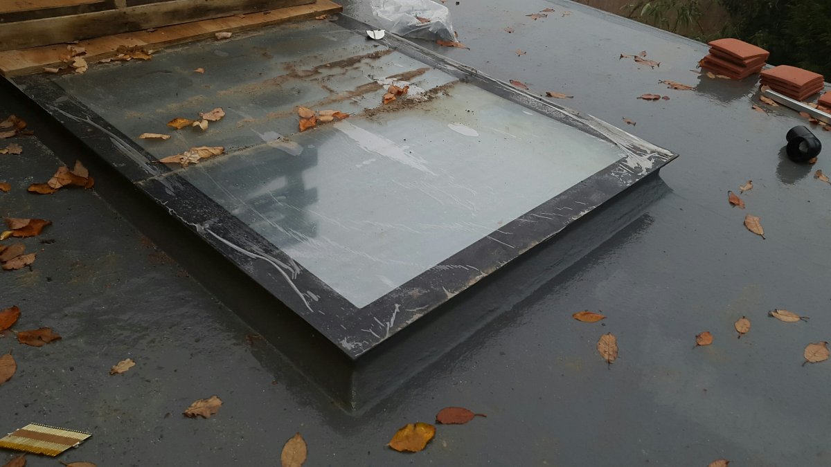

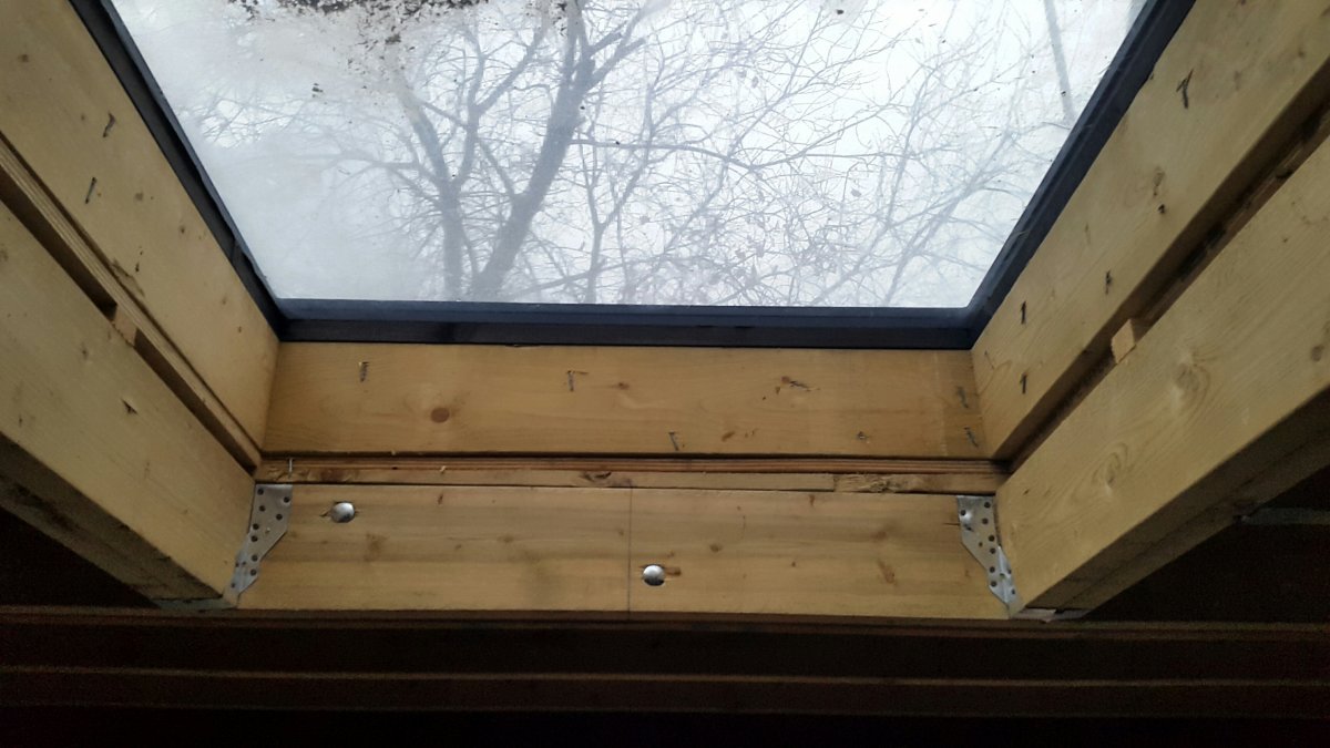

    As requested some pics..! Not looking its best atm as we're tiling a wall quite close but so have left its protective film on and covered it with pallets/wood atm to protect it... so it's quite dirty!
    On the inside, the plasterboard will just get butted up against the underside of the glass to create a "seamless" finish.
    Happy to answer any queries

    I have myself constructed several rooflights pretty much identical to those and would estimate that a 1mx 2m sealed unit like that would cost around the £200 mark, plus a little bit for triple glazed.
    One thing I would say to check though is; if the black edging doesn't extend into the window enough to cover the top edge of the plasterboard and the plaster, then that raw edge will be visible if you can see down from above. You can get round this by smearing a thin layer of black silicone onto the glass before putting the plasterboard up and skimming (through the glass from above it will look just like the factory pacification) then when you have skimmed, trim and scrape off the excess

    How are they fitted? Is all the weight hanging off the outer panel and relying on the spacer bar bonding until they're plastered in?
  17. andymet87
    andymet87
    Joined:
    8 Jun 2010
    Messages:
    183
    Thanks Received:
    8
    Location:
    Sussex
    Country:
    No, they supply a timber frame with a lip that the window sits within... this the drawing off their website / ebay listing.
