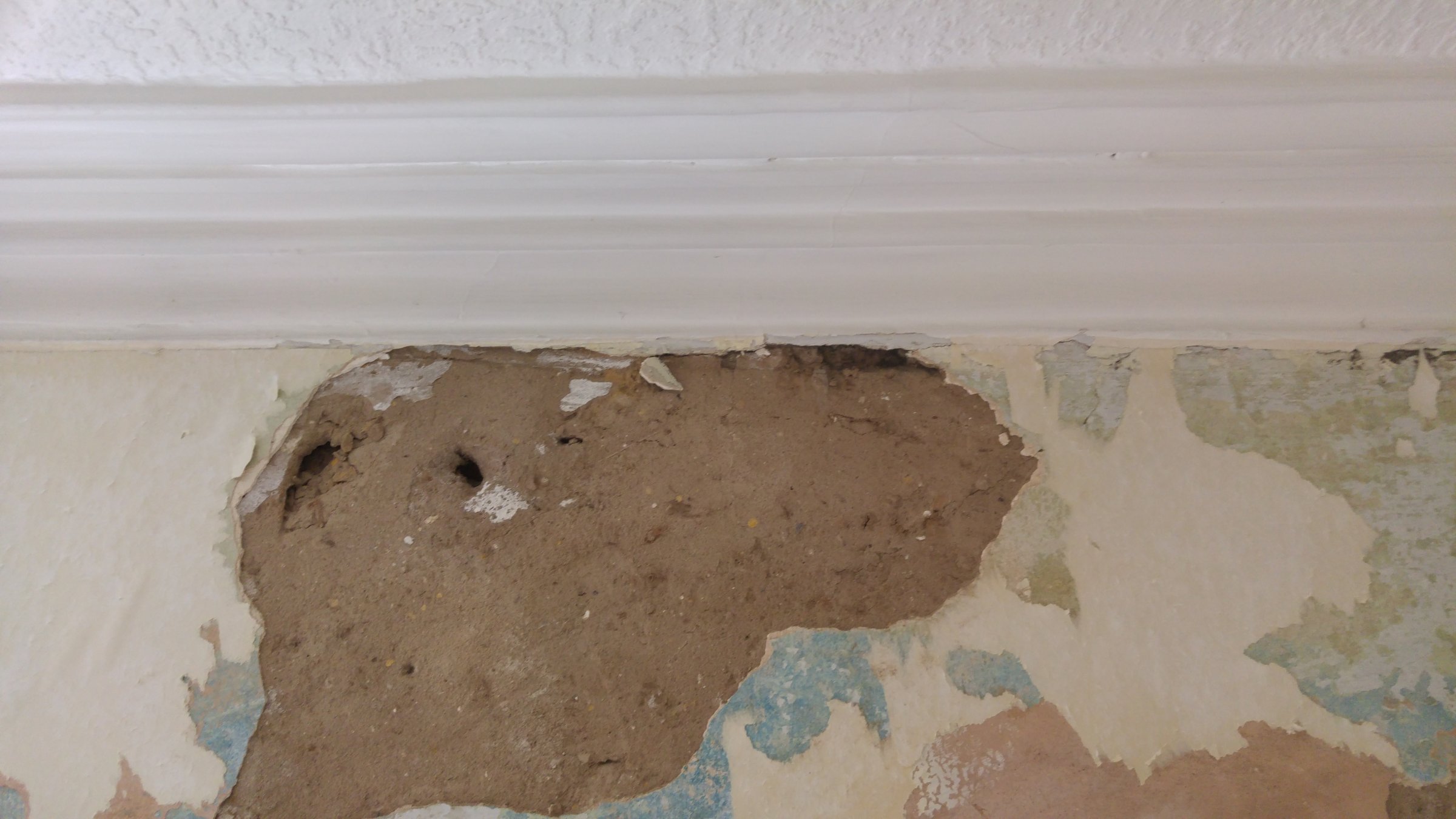

Paper off.. Plaster blown.. But how to preserve that nice coving?
12 May 2015
77
3
Liverpool
Hi
Another Victorian house held together by thick wallpaper. I've stripped it off, but unsurprisingly the plaster needs removing too.
Is it possible to preserve that nice plaster coving? Or will it all fall down the minute chisel hits plaster?
Score a line below the coving with a knife or cut it with a fine saw before you start hacking away
Still in the game! Looks like some old lead pipes for gas lights in there.
