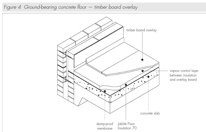

For 2). You could consider a load bearing insulation block, such as Jabfloor:
Where a vapour barrier and wooden board structure can sit directly on top of the insulation blocks; very easily removable :)
More info below.

Thank you. A quick google shows various thicknesses including a 230mm thick version available, leaving 20mm for floorboards etc. Could be on to something there, cheers will look in to it further

So your garage floor is 230mm lower than the house, why not insulate, dpm etc, then screed to bring it to where it needs to be for your floor covering, then just build Straight off the ‘new’ surface?
If that’s not reversible enough, do as Grinch has suggested. Cut a slot in the insulation to put a base plate or couple stacked up then build your stud work.
Hi, Just to clarify, the garage floor is 250 below - the 230 mentioned was leaving approx 20mm for floorboards.
I'm trying to stay away from screed / concrete, not only from the reversibility angle but also access is not ideal for heavier / wider wagons and even more from the point I'm trying to avoid bringing in other trades where possible, not just from a cost point of view but I'd like to DIY as much as possible. The bulk insulation does currently look the way to go, maybe not quite as cheap as timber but a hell of a lot quicker.
