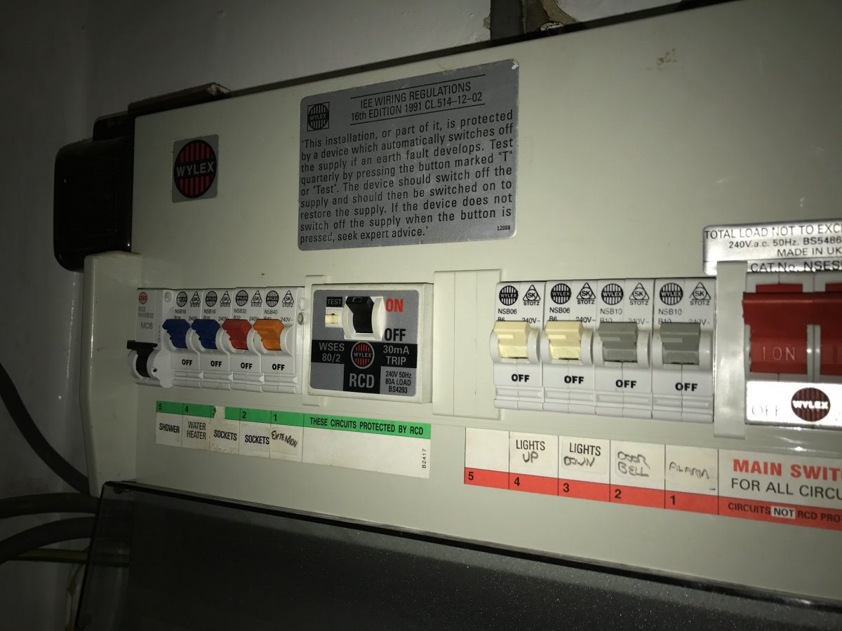

Can you post a picture of the CU with the lid open? Just copy and paste or drag into the reply box.

This is the fuse board I have...
Okay, lighting circuit not protected by RCD. But that can be sorted out with the board, with a couple RCBOs.
Thanks guys. So no new board required.

New board not required for what you require, just upgrades on the devices protecting the lighting circuits, from MCBs to RCBOs.
