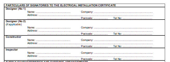

This is the issue the LABC will not accept the EIC forms. (condition report)
They have the view that the Installation electrician MUST be the one who completed the Certification,
That is correct, if you have done the work you sign for the work, and if you have designed it, then you sign for design, and if your electrician has tested it then he signs for inspection and testing.
they will not accept the certification by an electrician of work completed by others.
My Electrician explained to them if the original guy is dead .... then another must be acceptable, the LABC said no, in that case you have to get them to carry out certification (£322)
Again correct, however the cost does not seem to line up, it was £100 plus vat for first £2000 worth of work in Wales, in Wales third party signing for work is not permitted, this is only allowed in England.
He asked what qualifications does the inspection guy have that he does not - LABC said that is irrelevant,
That is true, the LABC have the option of selecting who does the testing and inspecting, however clearly if the person they select says it is not compliant and your electrician says it is, it would be normal to take the option of the highest qualified of the two, so in real terms their inspector either needs to be in house, or better qualified to yours.
as far as they are concerned the original installer & designer has to carry out inspection and certification or you have to use their approval scheme - and they admit they put it out to 3rd party electrician to do this.
No that is incorrect, the forms allow for multi-signatures
However if you submit an incorrect form, then I can well see why the LABC inspector would say this guy does not know what he is doing, I am not accepting any forms signed by this guy, moving finger writes etc. So now a bit late.
any specific inspection for heating appliances or electrical will require certification, or the Council can go this for a fee.
Paying the fee is now the only option, as there is no installation certificate.
