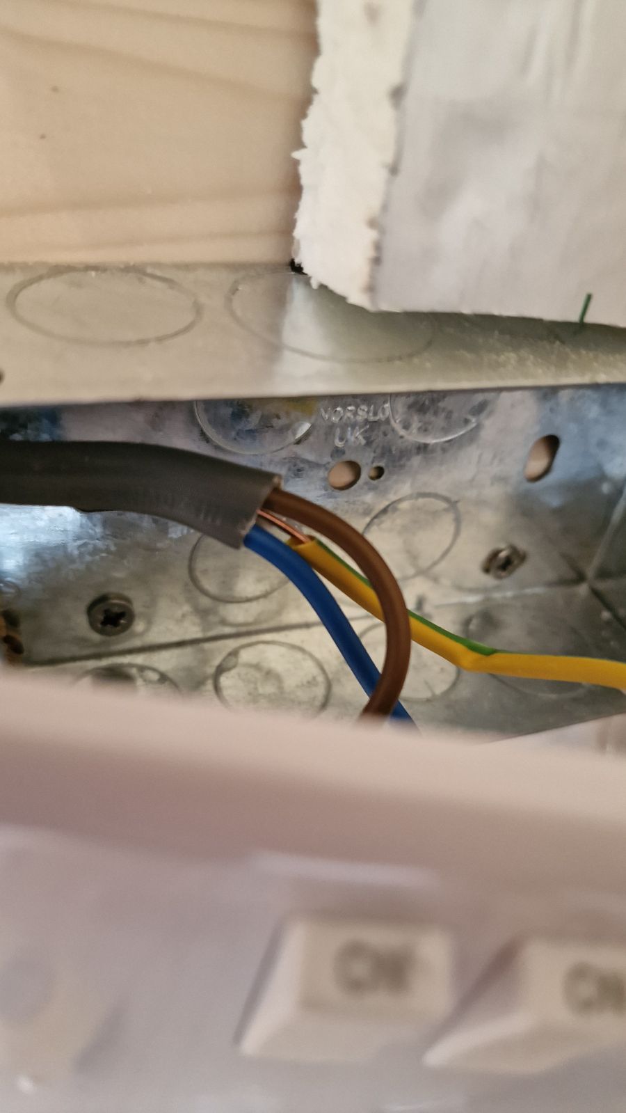

I'm doing a project of insulating our new garden office with 25mm insulation board and 3.6mm plywood. All is going well so.
We have an electrician doing the electrics and wiring a fuse board and some plugs. When i was putting on one of the plywood boards I undid one of the fascias on the plug so I could get the boards in behind it, I noticed that the earth wire was partially exposed, shown in the picture hopefully attached.
I asked the electrician about it and he said it was normal and the cable is bare in the cabling so it can carry fault current back to the board in case of a fault.
Obviously I am not an electrician but that sounds a bit weird.
Can anyone verify?

Twin and earth cable comes with a bare earth wire. When installed, the bare earth wire is covered with an insulating sleeve where it extends from the grey sheath as per your picture. Personally, the earth sleeving has been cut a bit short for my liking, but it's not unusual.
It's also good practice to earth the back box which hasn't been done.
If you do occasional electrical jobs, you can buy small packets of heat-shrink sleeving, in mixed colours and sizes. You are unlikely to use much.
G&Y you can buy in hanks, IME it is often missing or too short.

"...the cable is bare in the cabling so it can carry fault current back to the board in case of a fault."
I trust those aren't the actual words your electrical installer used.
There is a shcool of thought that it is better for the earth wire to be bare because in the event of cable damage it's better to have a short to earth and trip a protective device, than for the damaged cable to remain damaged with live wires exposed.
I think he was just making up some flannel to cover up his inaccurate cutting
Hoping to bamboozle the paying customer
