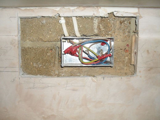

Hi,
patching some largish holes around sockets, measuring upto 14" x 7". The walls are concrete block and I was thinking of PVA'ing, bonding then easy-fill.
Would the perimeter of the holes need to taped prior to the use of easy-fill?
I'm a complete novice when it comes to plastering. Will this be easier to get a flat / decent finish that's level with the surrounding skim, instead of using batten / plasterboard then using easy-fill.
Many thanks

For a novice, would you advise the bonding method? My concerns are about feathering and I have the impression, I could be wrong, it may be more difficult to get a smooth finish using plasterboard and having to tape etc.
Would Easy-fill be the way to go for the finish coat?

I've 6 sockets to make good. Some need less patching than the photo. I had someone look at it on Friday and he said that the whole kitchen would need to be replastered.

After you've patched around the sockets with Bonding, for a pro it may actually be easier and neater to re skim the whole wall.
If you're doing it yourself and not skimmed before - either pay a pro or blend in easy fill over the Bonding.
Thanks for your reply. I've managed to get hold of a plasterer that we used once before. He's given me a price that I feel is reasonable for skimming the whole kitchen.
