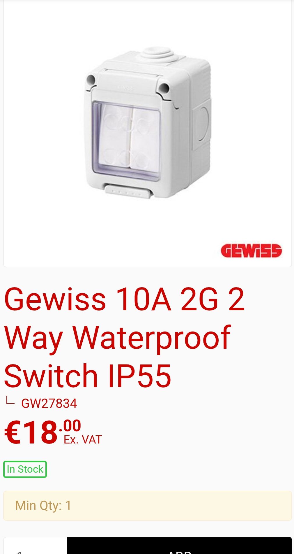

I had my consumer unit replaced less than a year ago.
Best D
Id be even more wary of condensation forming on a metal socket in a cold attic
I'm sure the op can decide based on the info provided
I don't use Bakelite Surface boxes anyway always PVC
Simply because I replaced more damaged plastic units in my time where they had got damaged. Metal is more resilient AND for a small additional cost they will last much longer
Mmm I sort of know what you mean.
In a domestic loft I don't think that's really likely to be an issue
In a village hall we stopped replacing damaged metal sockets like for like due to cost.
