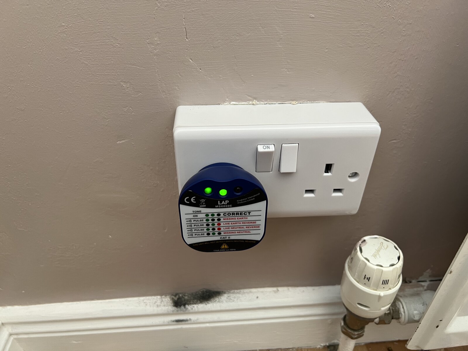

Ok everyone. I’ve been looking at all the information available to me and I think I’m going to have another go at this. I have ordered a metre of 2.5mm T+E and another metre of 4mm. I have 2 and 3 core Wago connectors that I will use to join the wires.
Here is my plan of action:
1. Flick off MCB protecting the socket I want to work on then test with socket tester to verify it is not live.
2. Unscrew socket faceplate
3. Unscrew and inspect existing wires
4. Feed existing wires through back of new surface pattress.
6. Attach surface pattress to wall.
7. Extend length of existing wires if needed using Wago connectors and a length of 2.5 or 4mm depending on existing wire size.
8. Connect up faceplate
9. Screw faceplate to pattress
10. Flip MCB back on.
11. Plug in socket tester
12. Breathe!!
Mrs SamH82 needs the study today so I’ll let her work away but I’ll give it a go tomorrow or on Sunday.
Wish me luck!

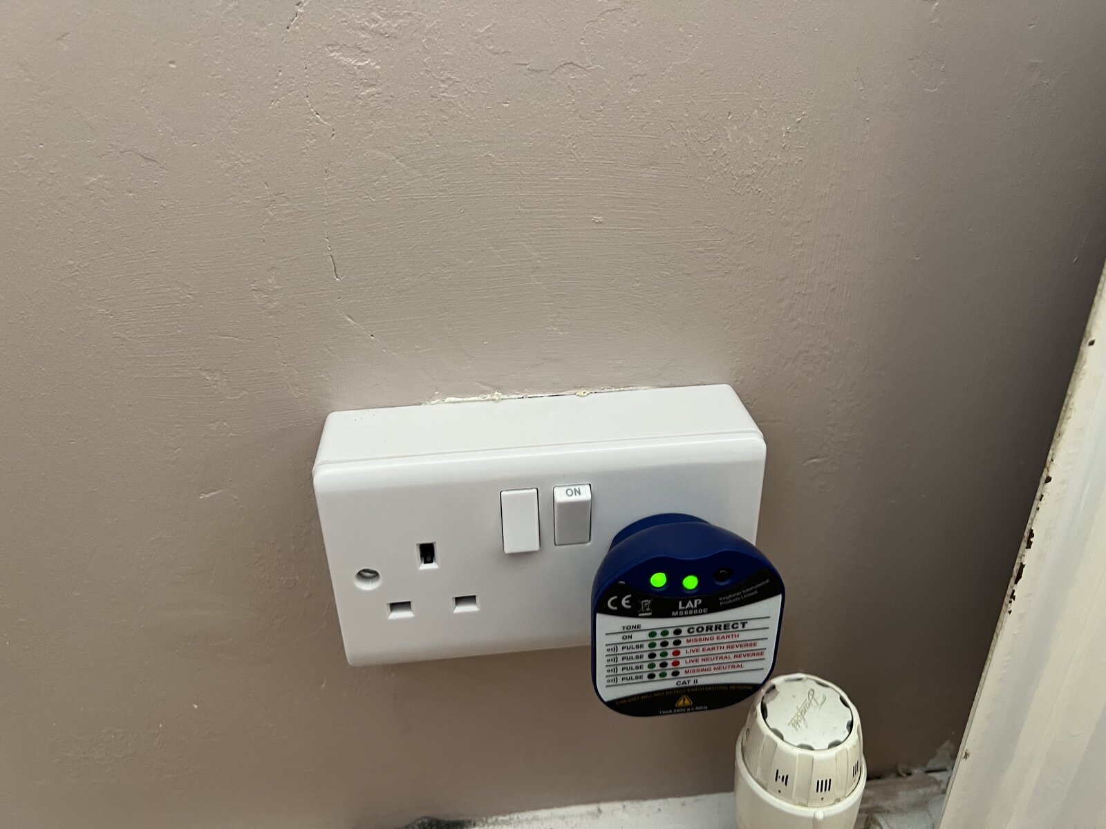

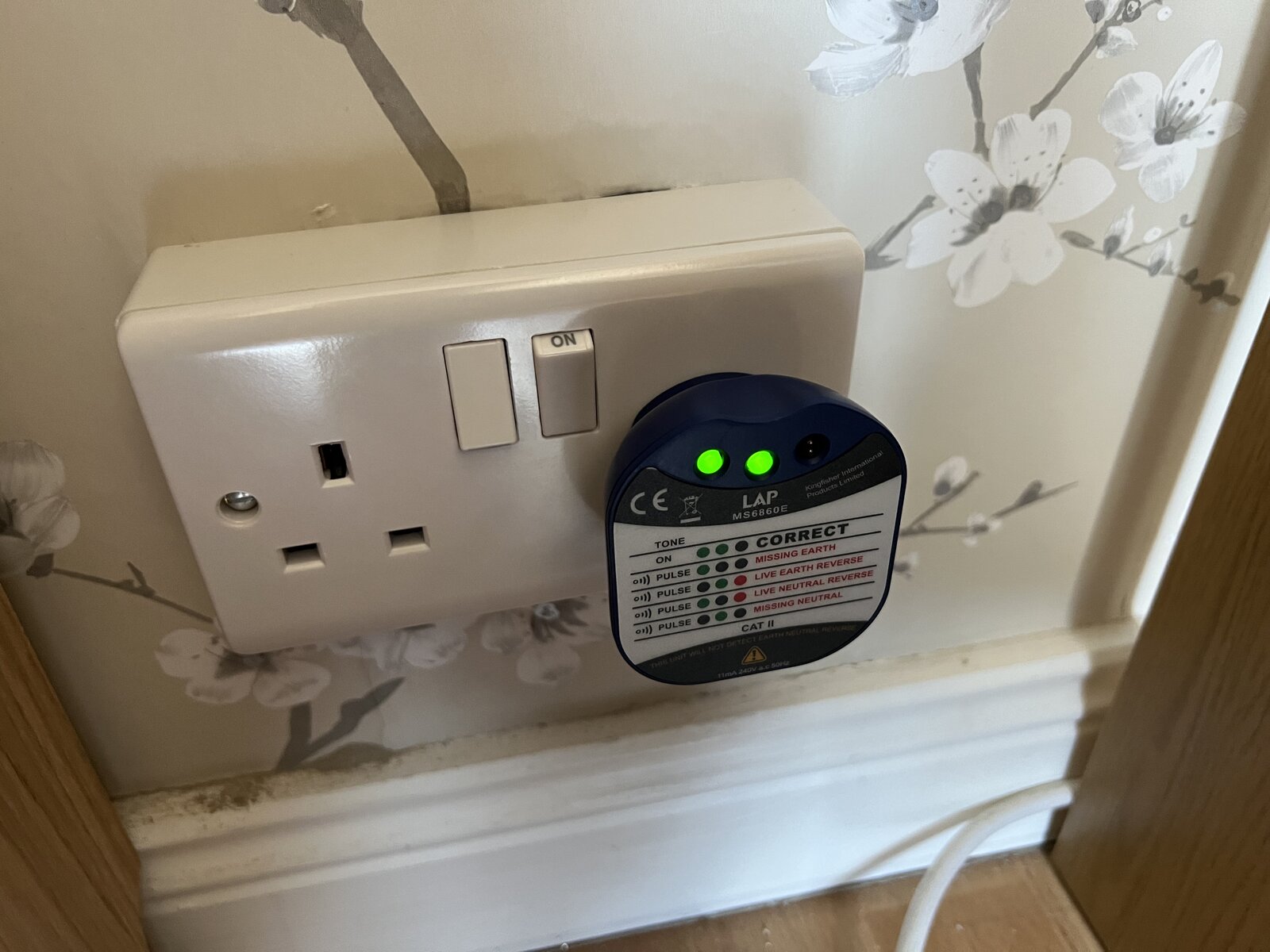

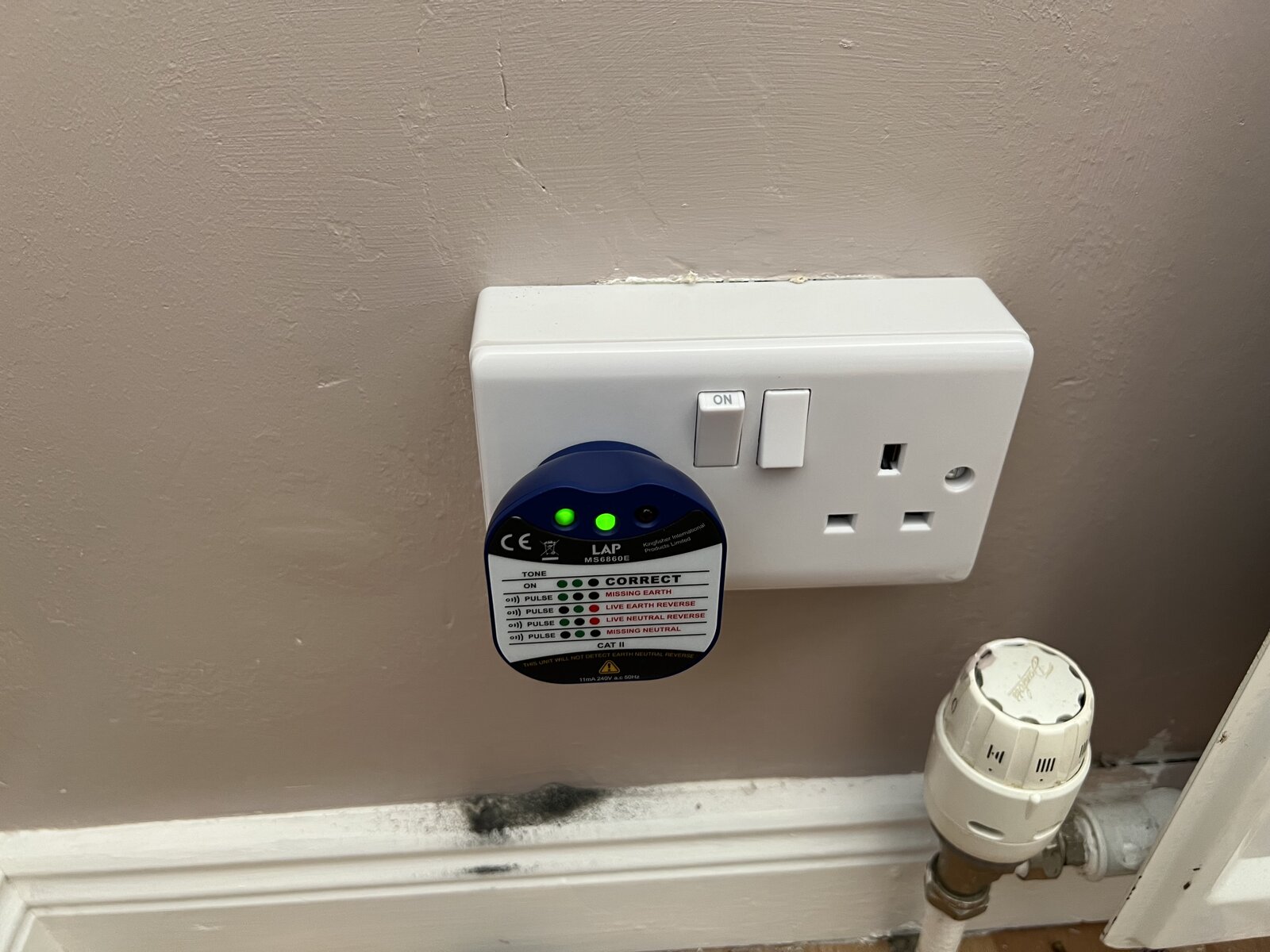

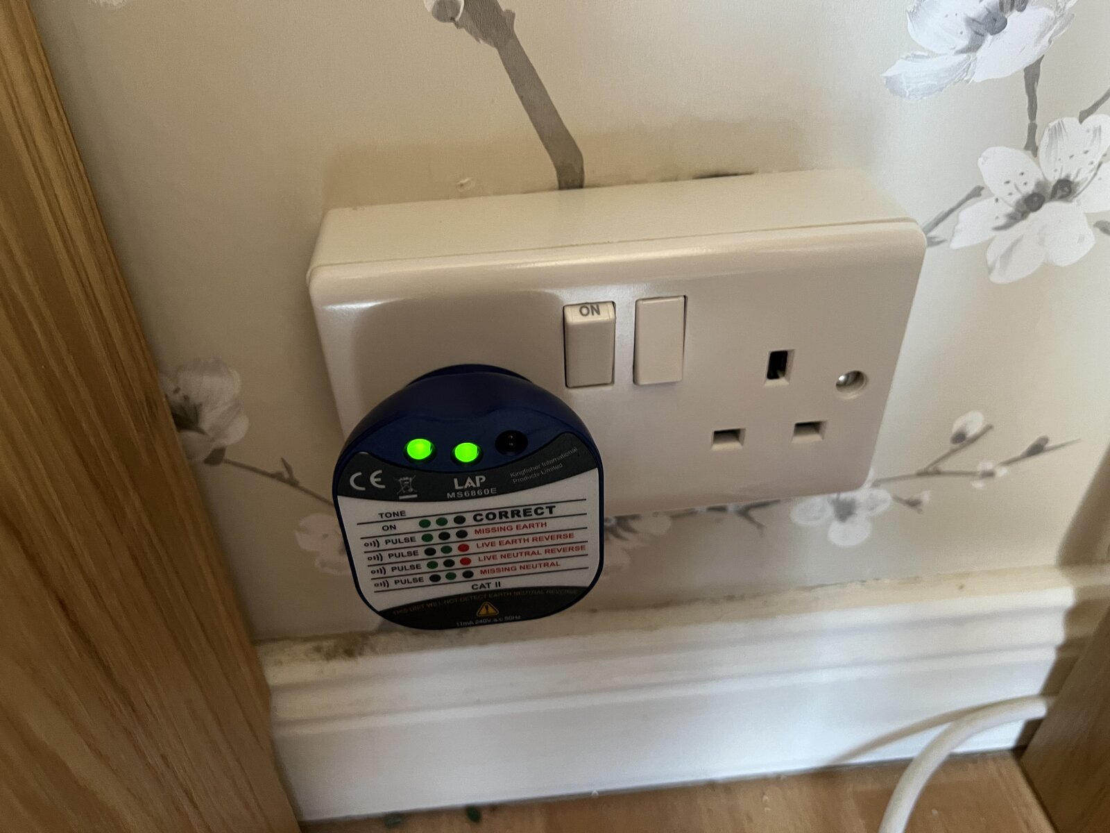

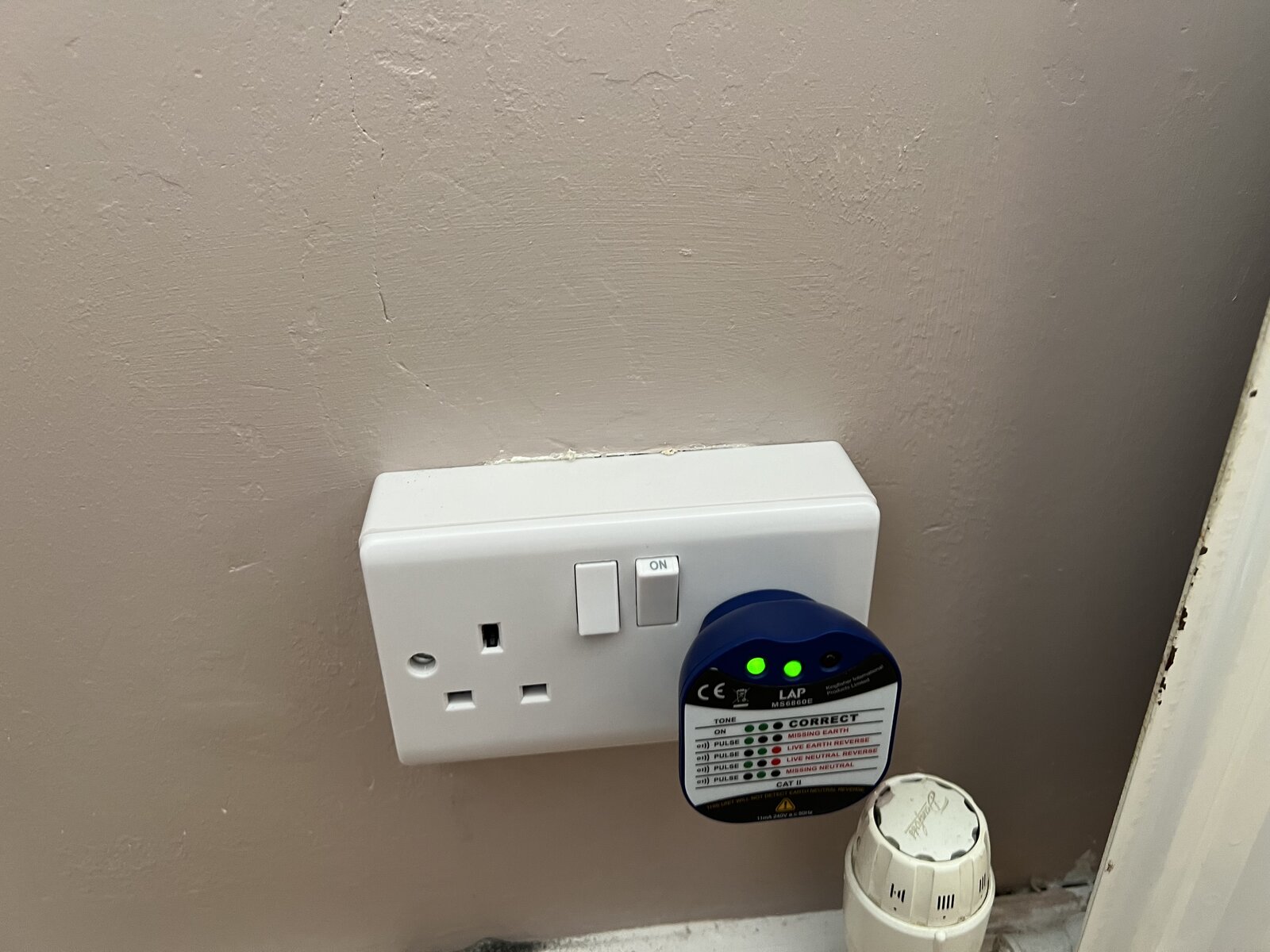

And the job is done!!!
The socket by my wife’s desk (with the flowery wallpaper) was the one on the ring, so I just used a three core Wago and a length of 2.5mm T+E to extend the wires.
The socket by my desk (painted wall) has only one set of wires in it. Given what I know about my house wiring that’s the first one on the radial connected to MCB #1.
Used the socket tester to test it and got 2 greens and a steady tone, so all good!!!
