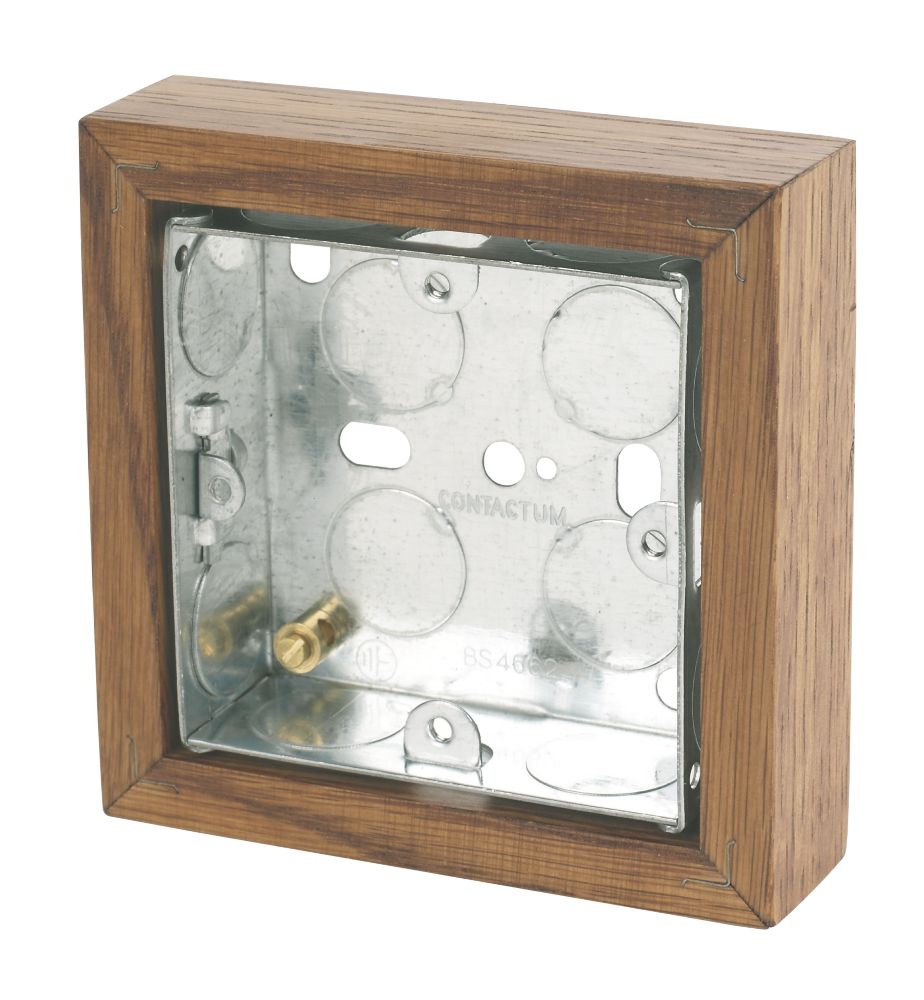

If having an electrician place a surface-mounted wooden pattress box on a wall with a light switch on this in order to achieve a 1930s look, I expect there is some element of increased risk with having a timber product next to an electrical product in this manner.
To reduce any such risk, should the pattress box be made from specific timber, for example, oak? I have seen several produced from oak.
Thanks.

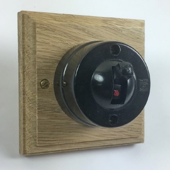

You can buy light switches with the wooden plinth, so these would be approved.
ae235
Even screw fix do these.
Doesn't the cable just go through the wood into the Bakelite switch?
This is the sort of thing I'm thinking of.
Nothing wrong with that (provided the switch itself is up to standard) - no different from having the switch (or any modern plastic surface-mounted switch) attached to a wooden, or wood-panelled/clad wall.

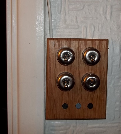

Home made from 100mm wide, 20mm oak ( probably American white ) planks. Cut to size ( length depending how many switches ) and the edges milled and sanded.
The back of the pattress is hollowed out to provide space for wiring.
With antique switches the pattress is drilled with a holes to match the terminals of the switch and a single wire through each hole ( the sheath of Twin and Earth being kept as close to the switch as possible ) A parking terminal for the Earth wire should be provided inside the pattress.
The switches here are ELV ( 12 volt ) but the same method works for LV ( 230 volt ) switches
