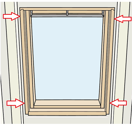

Agreed. Velux told me they don't sell a fixed rooflight. They fix by using screws through frame and sash *which have to be removed & re-inserted during installation.
Their image:
If I used an openable velux, screwed shut, and then applied an obscure film what are the chances of the planning team taking me to task...

I would say pretty well nil. Planning enforcement officers only go round to check on something if someone (eg a neighbour) makes a complaint.
