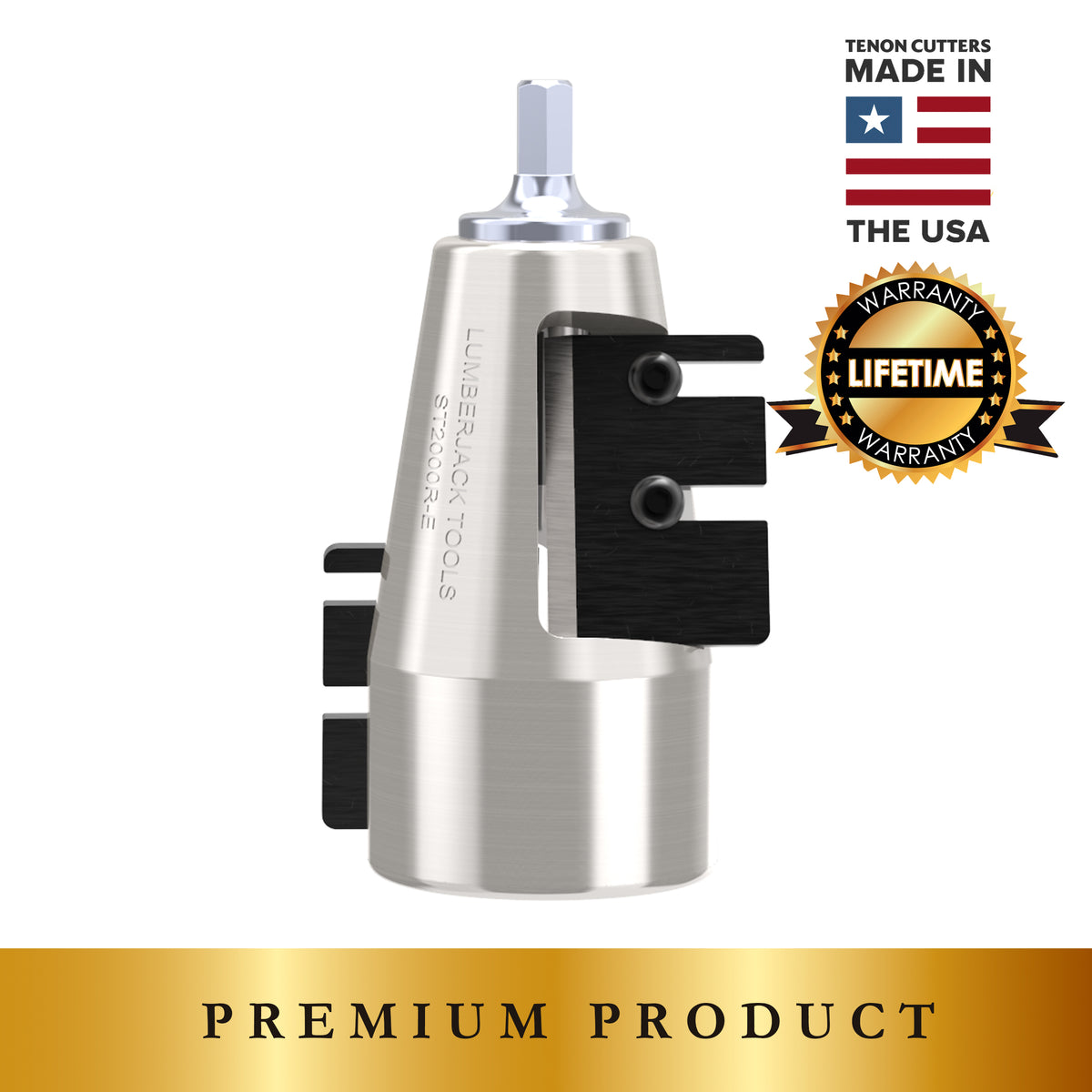

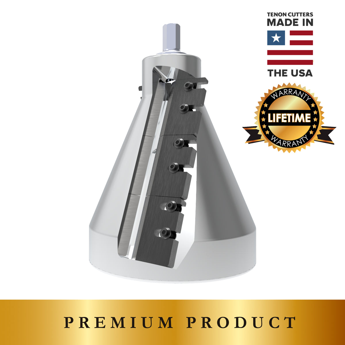

What you really want is an enormous pencil sharpener.....and this is what comes up when you search for that.....
Regards
Tet
does such a device exist that can sharpen a standard broomstick to a point?
Yes but they are not cheap, partly because the only ones I have seen come from the US.
Here are 30º & 45º versions
If you have thousands (tens of thousands?) of really big broomsticks to deal with and four flat sides will do then one of these might do!
