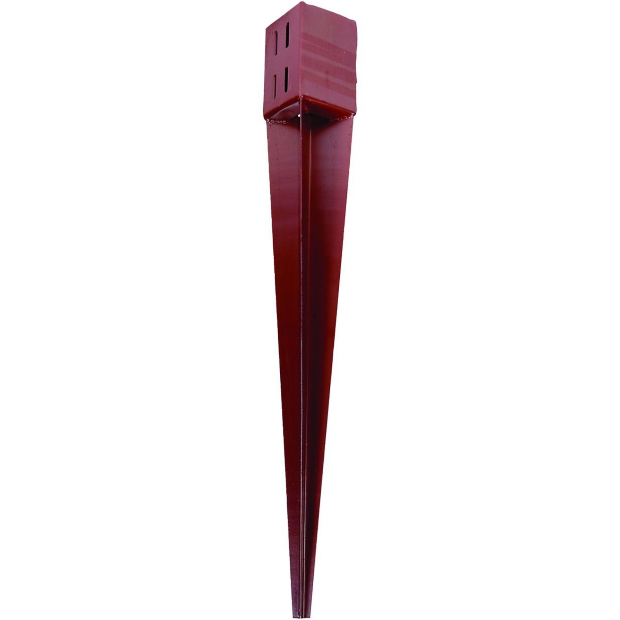

the pictured 750mm spike can this be installed by postcreting instead of the hammering them in method? Because my current post is postcreted in so when I remove it could I just attached the new post first to this and bolt it together then place this with the spike and the metal bit sticking above ground level and then pouring postcrete in to secure it then giving the spike a solid foundation similar to concreting a post into the ground?
Thank you. The Problem with this is I’d have to make the ground concrete then secure that down. Having inspected the rotting post the rot basically is just from about 10 to 20mm above ground level. I can actually poke screwdriver into the wood it just goes in but the rest of the post is still rock solid and in good condition as I kept it treated yearly too. So instead of getting a completely new post what I’m thinking is using that spike which is 75cm long basically temporarily remove the post and cut off about 30 to 50mm above the rot area that essentially should give me enough space to put the spike and because the spike is 750mm should be able to allow for that excess that I cut off. Then can pour postcrete in around the spike. This keeps the job a bit smaller and cheaper too. Thinking to paint the cut end of the post as it enters the spike with Bitumen paint maybe. Is there anything else I can do to make sure the metal spike is rock solid in the ground? Then after that I can just do the poly roof and keep an eye on the remaining posts and deal with any other posts as and when the need arises rather than replace the ok post too

Support the existing joists with whatever you have available and replace the columns with like for like, or fill in the holes after you've removed the old posts with some concrete and then fix some metal shoes to take new timber columns.

wooden posts in the ground will always rot, and will eventually break off above ground level where the damp wood below the ground meets the dry wood above the ground, and at the boundary is the patch where dampness and air give the exact perfect conditions for rot.
If you are replacing, I recommend casting a concrete pad into the ground, but rising up a few inches, with a metal foot cast or bolted into it, and fix your wooden post into the socket, so it is not in contact with the ground or the damp concrete. You can pour it into and on top of the hole where you raked the old wood out. Make wooden form so the top only shows a neat square block protruding from the ground
this method is not suitable for fences, because the socket method has poor resistance to persistent sideways wind loads, but is fine for a shed or pergola which is braced by the roof and is not inclined to bend over sideways.
