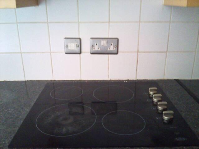

1 - Sockets and spur was directly above electric hub, Owner suggested to put a blanking plate over the socket, what do you think? what she would do with the spur then?, the hob was fed from a 32A bs60898 type b, i gave that a code 2

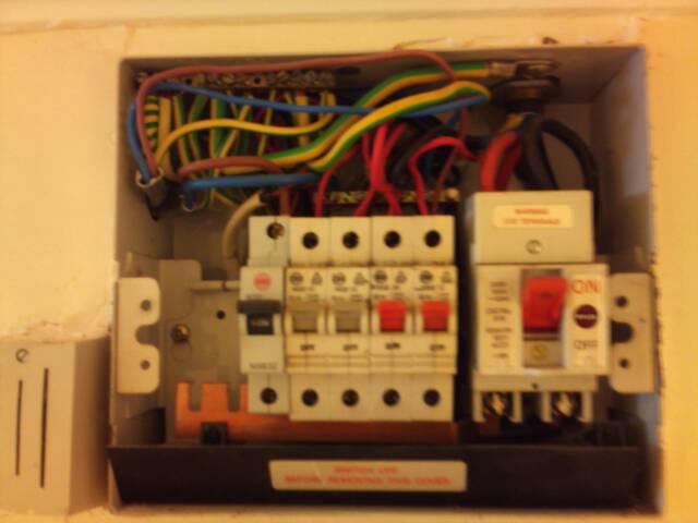

4 - No rcd in consumer unit, as it was a ground floor flat and there was a chance someone could use a extension lead for some gardening, again code 2

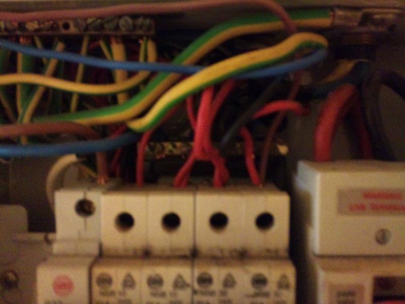

6 - Bunched circuits in a 10A bs3871 protective device, no coded agreed.

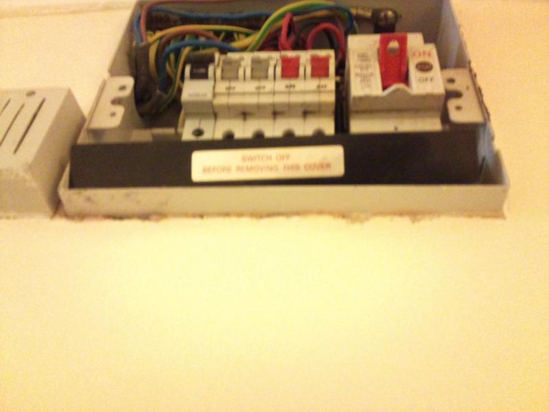

9 - In the consumer unit there are two types of protective devices, the originals are bs3871, type 2, and the addition is a bs60898 type b, which didnt completely fit on to the buss bar, is this a code 2? What are the max short circuit capacity of these breakers, are they 3KA?

1 - Agreed - stupid place to put a hob!

6 - Not really an issue. Have a read of the definition of a circuit in Chapter 2.

Multiple conductors originating from the same protective device count as a single circuit.
So if I combine 2 existing final circuits onto 1 mcb, I am creating 1 circuit and the circuit(s) wont need to be electrically seperated as 314.4 suggests?
Yes, it'll appear to be exactly that to the next person to work on it.
Have a look at the definition of 'circuit' in chapter 2.
1, Sockets and spur was directly above electric hub, Owner suggested to put a blanking plate over the socket, what do you think? what she would do with the spur then? i gave that a code 2
Hard one I would agree as if induction hob would it really present a danger? But I would still say code 2 like yourself although not cut and dried.

4, No rcd in consumer unit, again code 2
Again code 4 as was permitted in earlier eddition

6, Bunched circuits in a 10A bs3871 protective device, coded 4
I was always taught one hole one wire but in domestic that is not really an option as every ring main has two cables per MCB so hard to justify coding this! I am aware of 314.4 but that really does not make any sense as a ring main with one socket connected directly to MCB as a spur is permitted as shown in chart back of book. I would consider 314.4 as gobbledygook?

What you failed to talk about was the type tested CU had what seems to be mixture of types and unless manufacturer permits mix it would be code 2. If a socket is disconnected is it an electrical item? Do you have to remove any sockets from your tool box because they are not connected? I would agree there could be a problem if socket was metal.
Could it not be deemed possible to consider that a ring does not apply in this way. In that it is a returning cable and so the two runs from the mcb are not electrically seperated when disconnected?
A circuit as per definitions is:
Circuit - An assembly of electrical equipment supplied from the same origin and protected against overcurrent by the same protective device(s).
So, for example; two twin sockets, each one fed by one single 2.5mm2 t&e with both t&e's connected to a B20 MCB - that's one circuit by design.
How can 314.1 come into play?
314.4 - Where an installation comprises more than one final circuit, each final circuit shall be connected to a separate way in a distribution board. The wiring of each final circuit shall be electrically separate from that of every other final circuit, so as to prevent the indirect energizing of a final circuit intended to be isolated.
By design, it's one final circuit and completely seperate to other circuits that share the same consumer unit.
I would think it comes down the the designer of the circuit to what constitutes a circuit. It's not unreasonable to supply lighting to a newly added downstairs toilet from the same MCB as the rest of the downstairs lighting if the consumer unit is at full capacity. That doesn't then become two circuits sharing one MCB but one circuit.
One example I can think of for 314.4 is when an idiot (and I've seen it done) connects each end of a ring final to a B20 MCB so that you need to isolate both MCB's for complete isolation of that circuit.
