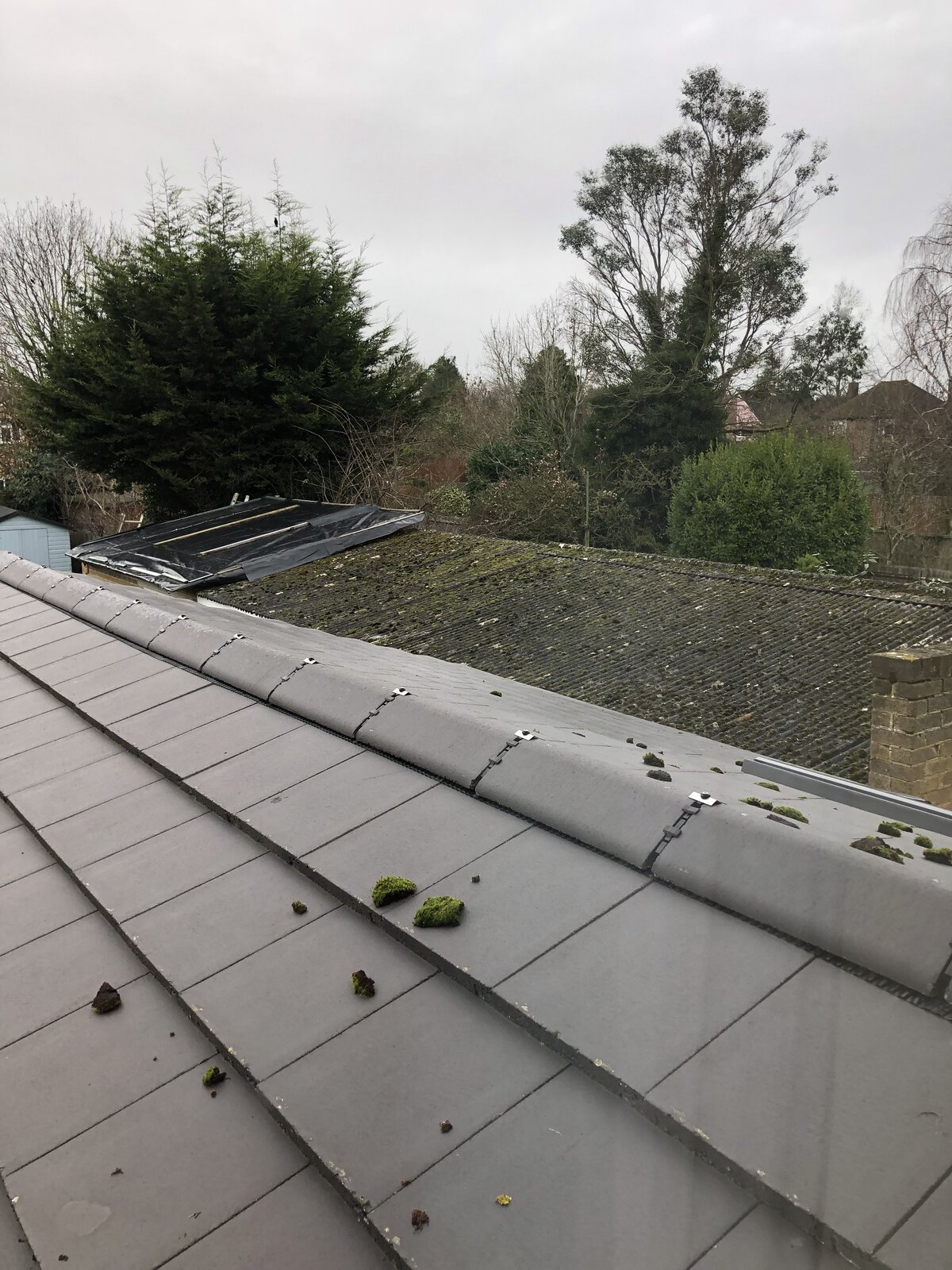

Has anyone used this system called easy slate 500 for low pitch slate roof, wondered it it would also work with Marley moderns which is not a slate I know but presume the concept of it is the lift a tile to reduce capillary and to put a channel under the tile joins, thanks https://www.permavent.co.uk/products/easy-slate/ wondering if it's a reasonable way to go down in pitch to 12.5 instead of the 17.5 usual minimum of moderns.
Okay thanks, I’d come across some locally left over from a job and just crossed my mind, have this extension we did and now converting garage which has been extended and got a temporary roof, it’s 12.5 degrees I can’t go higher, want to do that bit first as it’s business workshop currently in main garage, extension is Marley moderns, there will be a box gutter joining the two of them, south facing and Oxfordshire so not extreme weather area (yet!) had hoped for a flat matching style but looking like pitch is the issue, prefer tiles as can see roof from extension and would look nicer, photos from rear bedroom, joists are in 150mm, 400 centres with every 4th having another between it and the following one for added strength and might have solar panels later. Any smooth flat options without costing a fortune or are redlands better than mendip 12.5's ? (Also noticed some huge leadtimes on tiles!) I could board, felt and counter batten then tile but adds weight, cost, time and height and none of those appeal strongly. I had contemplated winging it with some moderns and seeing if they leaked at the pitch but risky strategy being a workshop with expensive kit in

Thanks yes did that, some horror stories aren’t there! Actually Found local supplier with some redland regents in stock so going to get a few to see what they look like. Also discussed it with Marley technical who confirmed they wouldn’t recommend the moderns at that pitch which I knew but still asked, only in case there were scenarios where it’s possible. Not a fan of how wavy tiles look but they are probably stronger than moderns which do appear to break rather too easily, guess being so flat theres not the strength than shaped tiles get
Mini stonewolds are a good tile . Still won't do that pitch though .
Board it , counter batten it , torch on over it then fit any tile you choose
