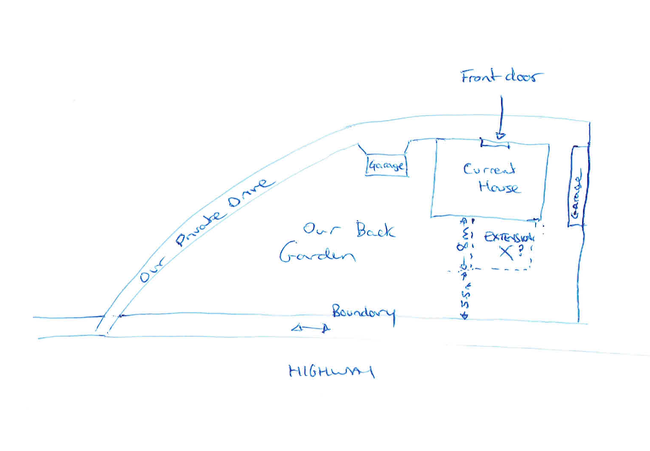

Hi
My house faces away from the highway so my drive and front door are effectively at the back of the house (See image below). My back garden then faces onto the highway separated by a large hedge and fence . The front door of the house has always been at the back in relation to the highway. When I say 'highway' its actually a country lane.
The house is detached and has a large garden much bigger than the space occupied by the house and planned extension.
I plan to add a single storey rear extension to the back of the house (where the back door is, not the front door) which will go out by the permitted 8 metres from the original house under PD.
My questions are -
1) As the back of the house fronts onto the highway will this be a problem? The planning portal only mentions extensions to the front of the house facing the highway.
2) By extending the full 8 metres I will be about 5.5 metres from my boundary to the highway. I can't find any rules about how close a single storey rear extension can be to the property boundary.
Steve
It looks like the principle elevation is the one with your font door, so yes that will be a rear extension and PD will apply (if you have PD rights), and you can build up to 1m from the boundary.

So they could say the back of the house is the principal elevation as it nearest the road, that could be a big spanner in the works! The back of the house is 13 metres from the boundary with a further hedge of about 1 metre and the road can not be seen from the garden (or accessed as its too low) as it drops away as it passes our drive entrance. The front door has always been on the side of the house it is on now. Looks like I will have to risk the expense of drawings and see if we need to argue where the principal elevation is after it has been reviewed by the planners. What a pain!
Facing a highway does not define the principle elevation. There are several other factors.

I think if this was my job I might be steering the client towards a LDC ..... If only to prevent some painful annoying letters further down the line from an overzealous LA.

If the back of the house is a bland elevation, then even if the front is bland too, the door and the fact that there is a private [front] driveway indicates that the front is the principle elevation. If the front has additional features, then it's a given.
If the back elevation is more detailed than the front, then it might be different.
