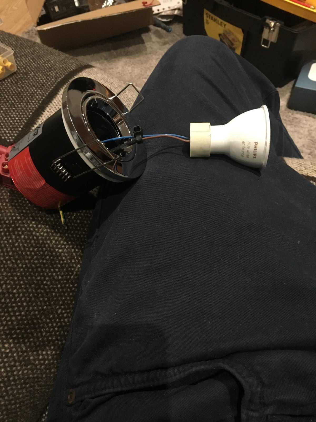

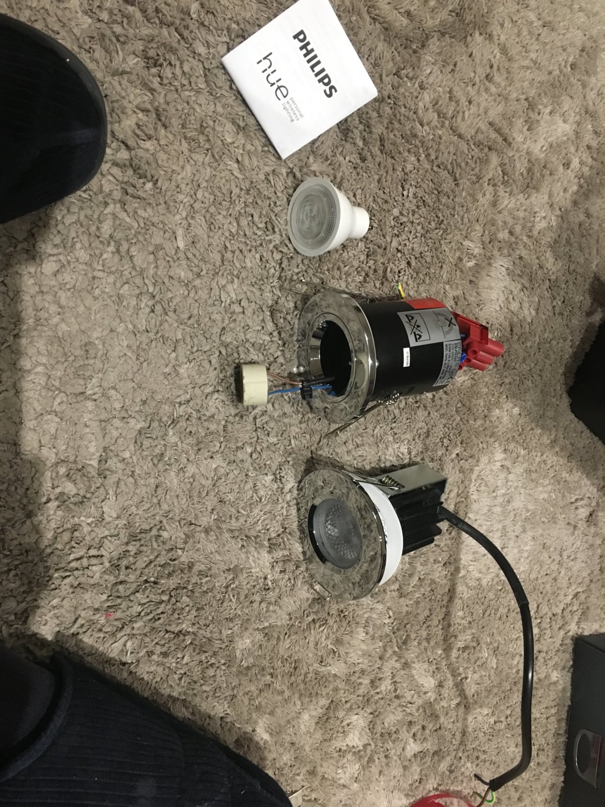

So I want to install hue lights in my lounge. I already had some integrated downlights which I have removed.
I bought a GU10 downlight from tool station and bought some Philips HUE GU10 LED's.
However, they seem to big to fit.. I thought that fact they are both GU10 they should just work?..

I thought the Hue white ambiance were ‘perfect fit’ and normal GU10 size.
Gu10 is just the lampholder, the actual lamp can be any size, most commonly 50mm diameter.
Post a pic of the 2 lamps side by side

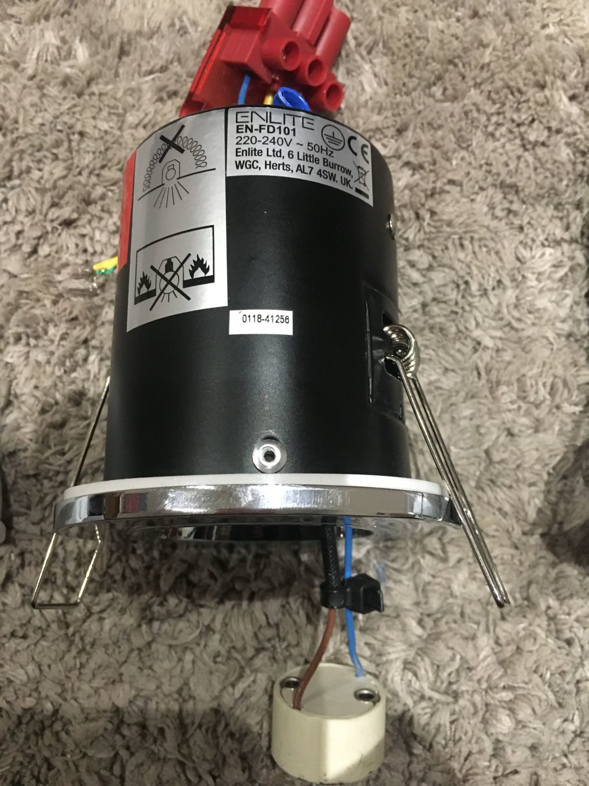

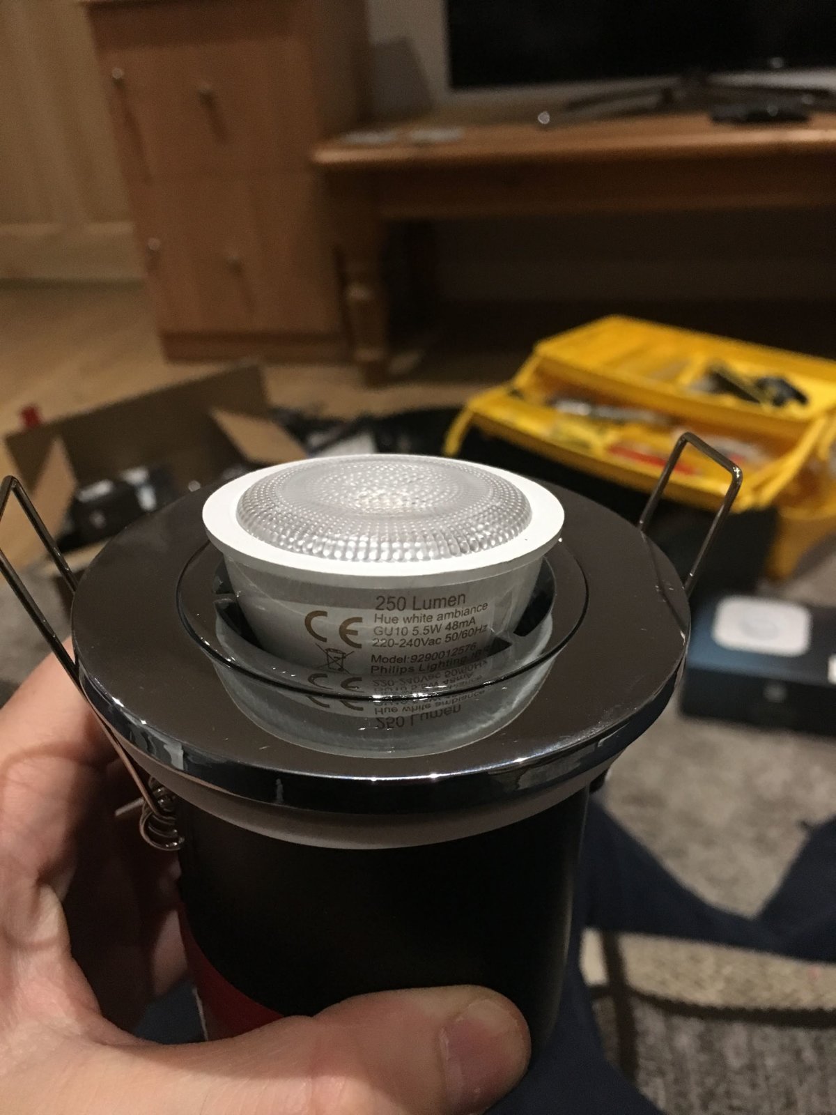

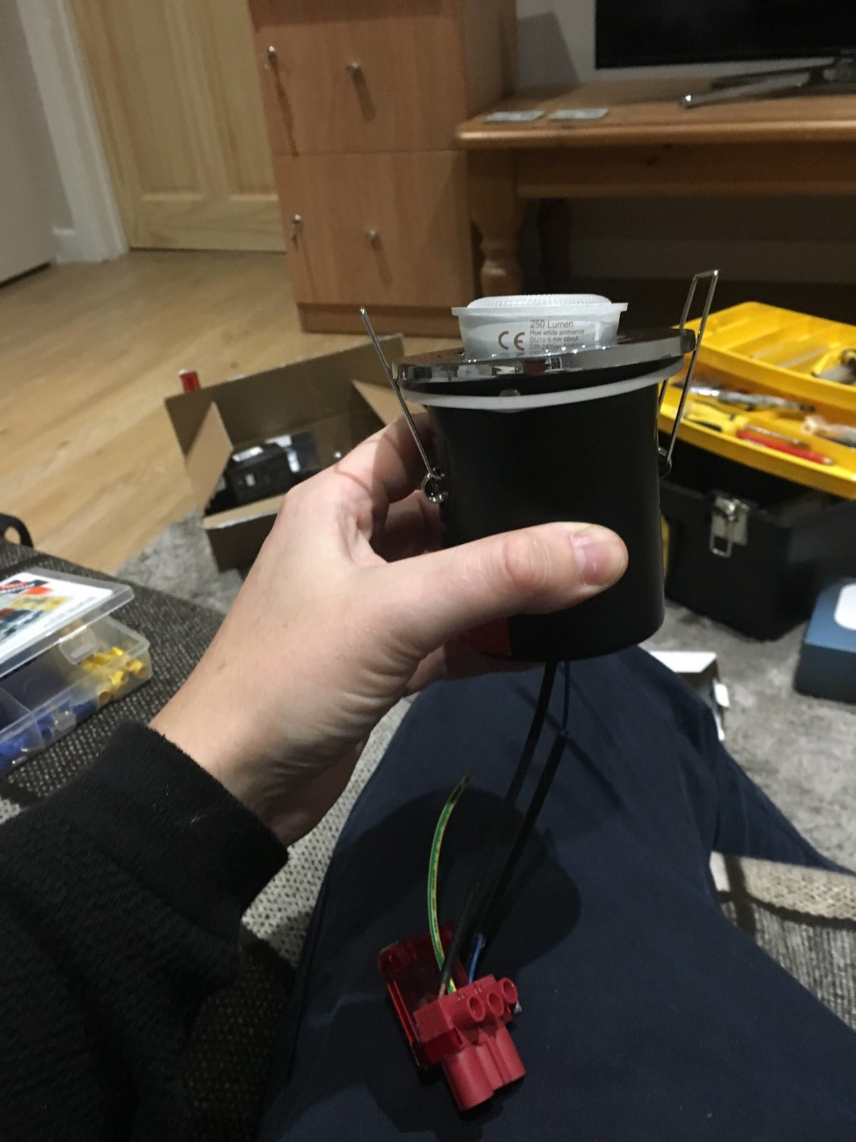

I see well the only lamps I have are this Enlight EN-FD101 and an Aurora AU-FRLD811/40 (this has an integrated LED bulb).
Most people will refer to GU10 as the standard, common bulb found in Screwfix as a GU10. Whether that’s right or wrong, it seems to be the way they are sold (as you know).
Philips make 2 sizes in Hue. Both just called GU10. One is called perfect fit though, and is the normal 50-55mm that fittings require.

The inside piece is removable. It twists outwards.
It then fits on the bulb and screws back in holding the bulb secure.

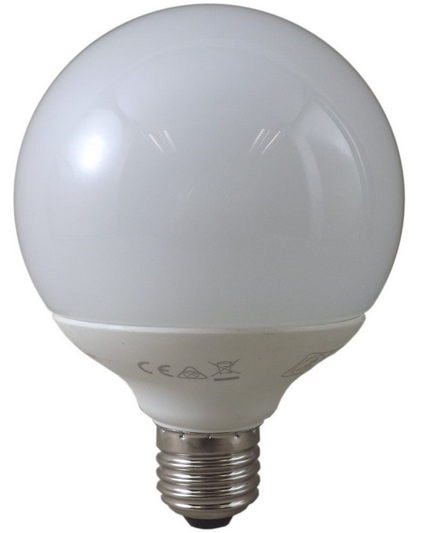

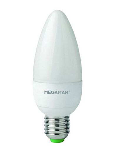

GU10 is the specification for the base, nothing else.
These two bulbs have the same base (ES):
If you had a light which used the one on the left you wouldn't buy one like the RH one and complain that it didn't fit but it was an ES....
