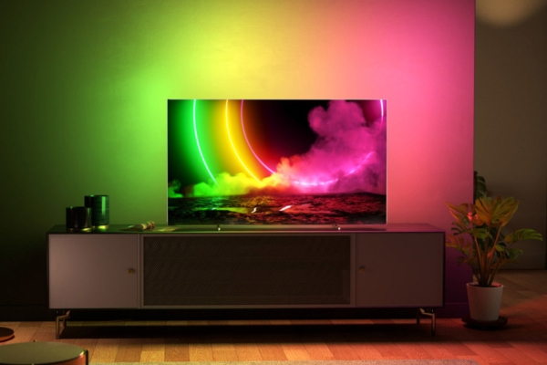

I have a Samsung Smart tv with a nice cinema sound system, i want to compliment this with using lights and one of the ideas is to use the Philips Hue system, can i ask what i will need as its confusing or is there another maybe cheaper altenative?
If you're talking about the standalone Philips Hue Play system, then the controller box for it sits between the TV and a source device - so let's say a Sky sat' receiver and the TV - and 'reads' the picture content from the HDMI connection passing through the Hue controller box. The controlled box is known as a Hue Play Sync Box. In this way the LED lighting extends the colour onscreen onto the surrounding wall area behind the TV.
"What happens if you want the light to sync to the TV tuner or the TV's own smart apps?"
For that I'm afraid you're stuffed. There is no way to get picture info out of the TV from any sort of video connection. HDMI won't do it. None of the other video connections will work either. They're (*almost) always inputs which means they're a signal-goes-in-to-the-TV connection. That's the wrong direction. in order to drive the colour change electronics.
"What if I have a Philips Ambilight TV?"
In that case the lighting system is built into the TV so it can read the picture content from the tuner and internal apps as well as any external HDMI sources. But only if it's a Philips TV with Ambilight built-in.
