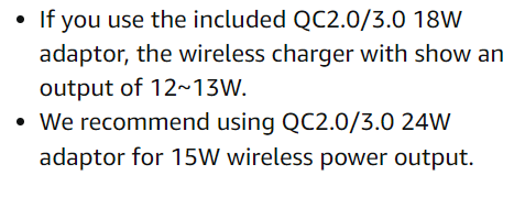

But on Amazon, I found this:
Guess that 2.0/3.0 refers to the USB standard?
Not sure why an 18W charger won't supply 15W to the device?
I may be wrong, but I have seen mentioned that the conversion to wireless is about 80% efficient?
So to output 15W, would require 18.75W + .25W for the electronics?
...and over-driving the PSU probably wouldn't do it's longevity any good!

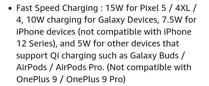

But worth noting if you have a Samsung, or iPhone:
Proprietary code, and non-standard 'Standards', strike again! :confused:
Samsung have disabled fast wireless charging from non Samsung wireless chargers. I suspect it's because they get the phone/battery too hot. Some Samsung fast wireless chargers have fans in them.
I bought a "fast wireless" Devia charger with my new phone, supposed to be 10W but it only charges at 5W, with a message warning incompatibility on the phone.. It's about 3 minutes per percent, whereas 25W wired charging and 15W are just either side of 1 minute per percent. These are different outputs from a 65W charger, so that's not limiting it. Percent per minute also changes with battery charge %.
Interestingly, Android 11 has given the ability to limit charging to 85%, and also inhibit fast wired and fast wireless charging.
I suspect that's because it's kinder to the battery.
