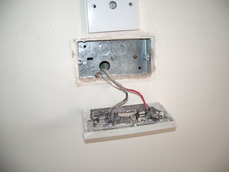

Well folks, It's that time again.
These are all from the same property.
Yet another case of bad DIY.
Yep, thats a 1.5mm² fed from the ring circuit.

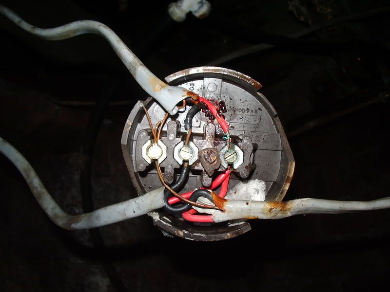

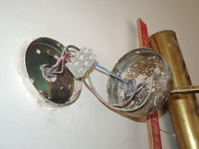

This was also fed direct from the ring circuit.
This junction box was so damp that mould was growing in it. I had to break the lid off to get into it.
It's IR was down to about 0.10Mohm, and was causing the RCD to trip.
How do you get all these juicy jobs?! I take it the call out was for the RCD?
Tim77, when DIYers go shopping for electrical stuff, lets say they want to add a socket spur. They go out and buy the socket and backbox. Thats it. They get home, and realise they forgot to buy cable. No problem, he's got some leftover from another job in the shed. Oh its only 1.5mm well never mind its only a socket. So he chases the wires in, fits the socket and backbox, wires it up. Oh the earth wire is bare . . .
Now either one of 2 things is thought by mr DIY.
1. Oh the cable is made like that it must be ok.
2. Oh bugger I forgot the blasted earth sleeving. Never mind.
Rob I just noticed, is the neutral switched on that light fitting??? :roll:
Yes it is a switched neutral, and yes I did notice it, hence 'ALSO' fed from the ring cct.

I must confess to having not used earth sleeving on a cuple of occasions, but i have used green/yellow insulation tape instead.
No problem with that as long as the bare cpc is fulled covered.. :wink:
Or the next person who needs to work on it gets their fingers covered with horrible sticky glue!
