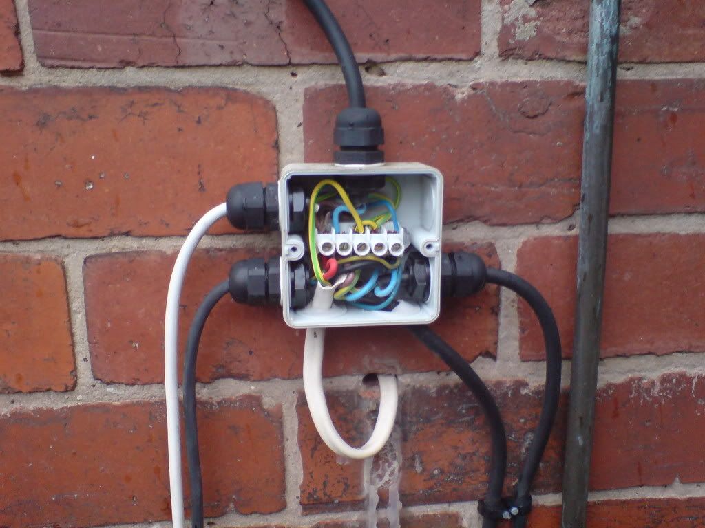

Well folks, it's that time again.
This week we have an external junction box which supplies some pond equipment.

Back to the pic. At least the box is the proper rating. Do all those flex leads get buried in the flower borders?
that JB looks a bit cramped and untidy but is there anything actually wrong with it?
I thought that, but the only thing i would say is the T & E supplying it
not ideal but it's leaving through the bottom so there shouldn't be too much potential for water to get in that way and the box probablly shields it somewhat from direct sunlight.
I might be wrong, but all of the cables, except the T&E, appear to be indoor flex, rather than SWA. The radii of the turns look too tight for SWA and there is no armour visible. It looks like the installer used an outdoor box and gland seals, for weather-proofing of the terminations only.
i bet the blck flexes are rubber which is what most pond kit has, no idea about the white one, but as rf lighting said no lid, but we all assumed he took the lid off for the pic
Are the Neutrals and Earths all crossed up? It looks like there's a Y/G wire in the bottom of the right hand terminal, and a Blue in the bottom of the fourth terminal.
Agree with Plugwash.
Box and glands IP56, if lid was missing then it looks very clean with no signs of ingress of water.
