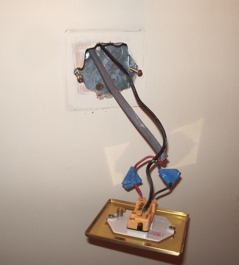

Well folks, it's that time of the week again!
This weeks picture continues on from last week.
It is another brass switch in the same house.
Is that blue tape covering a dodgy joint or is it just some perverted marker?
Blimey, now theres a spark who likes leaving a lot of cable in the backbox!
Is that a cpc wrapped with black insulation used as a strapper that I can see?
Metal faceplate too, naughty.
AFAICT it is just being used for marking the strappers.
securespark said:
What sort of stuff is that common made of??
It is a single insulated 2.5mm² conductor
No, the CPC has been cut off, and a singles has been used for the common.
Well at least you have enough spare T & E to strip back to find the CPC! :lol:
Providing it goes to a propper earth at the other end of course :?:
