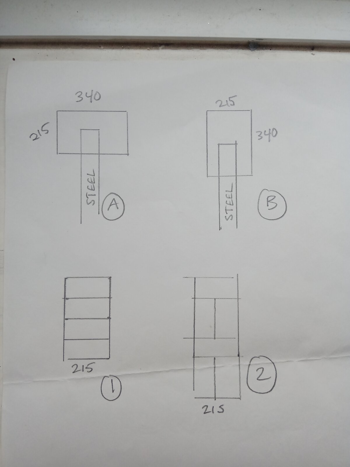

Hello. Just wondering if anyone has any ideas about this? I've got to build a pier as suggested by a structural engineer. It's 7n blocks 340x215. I'm not sure if that means the longest dimension should be width or length ways in regards to the steel it's holding up.
Also not sure if there's a right or wrong way for the bond. For example all on their side or alternating or whatever.
I've attached a sketch of what I mean incase I've not described it will.
Cheers.

Suggested or specified by the engineer?:cautious:
A, probably
Blocks should be laid upright, and bonded into the wall they attach to, not tied

A) would be my preference, so that would be good.
I should have said it's an isolated pier. I meant what bond for the pier not which way to attach it.
Yes specified.
A post is a possibility but this way there's more room for Tolerance. IMO.

To suggest a pier of those dimensions in 7N block is nonsense. Aside from the issue of having to cut the blocks down to 340 long, the 215 dimension suggests that at least some blocks are to be laid flat, which is a no-no.
You need to go back to the SE and ask how it is to be bonded. Alternatively, build it in concrete common brick, which would more-or-less accord with the dimensions given – ie one brick x one-and- a-half bricks.
As for the orientation, again you need to ask the SE as this does make a difference.

I agree. I wonder ifhe may have meant to write 440x215mm and put 340 by mistake, but that still suggest laying some blocks on their side and cutting of blocks.

All this depends on the load through the pier. Is it 5kN or 50kN?

Havent got a clue. The steel is 152x152x37kg/m UC 195kg. above that is a upstairs wall and bedroom floor joists sit on it. if that helps
