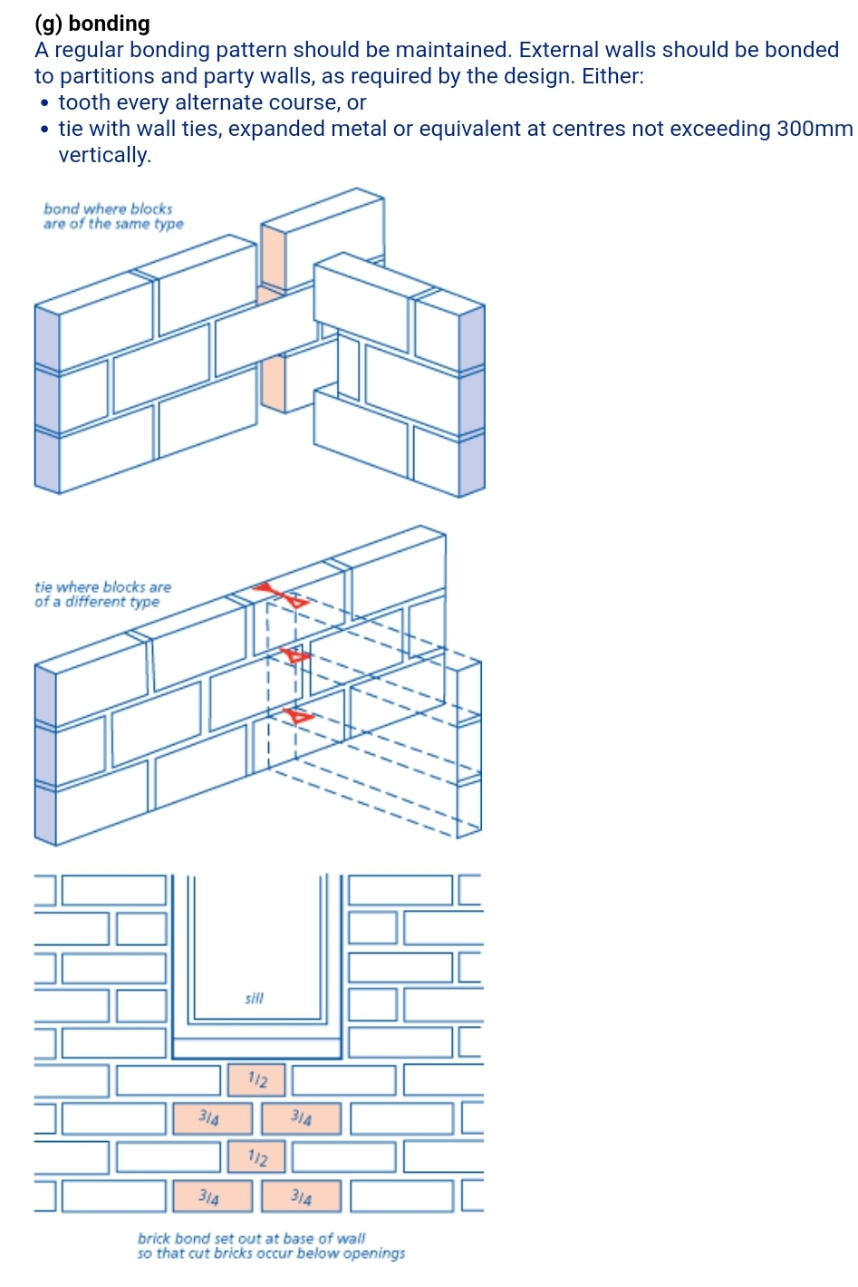

The builder's bricky went off sick with covid, which was threatening to hold things up, so he's started the bricklaying on two piers that are to support a 6m (575kg) steel himself.
The steel went in with two genie lifts today and is currently held in place by two acrow props. He's built up one and a half pier today, and when he left tonight after dark he did say it didn't look good, but that I shouldn't worry as it will be "plenty strong".
I just went out to have a look, and I'm a little worried by what I've seen. I thought I'd post some pictures and maybe someone can reassure me (although I fear the opposite might happen).
As long as this will be a) safe, b) pass building control, I guess I won't care too much. But if it won't, I'd rather know now as I'm pretty sure this weekend the padstones will be cast in-situ with bolts in the beam and attached to the 6m steel. Probably won't be easy to undo.
The spec from the structural engineer was:
The bottom of the level is touching (in places), but clearly the pier isn't straight. As you can see there's about a 1 - 2cm gap at the top.
325x325mm solid engineering brick pier fully tooth bonded to inner leaf
Engineering brick piers are to be constructed using minimum 40N solid brickwork laid in type (ii) mortar to BS5628. 1 Portland cement: 4 sand + plasticiser.
