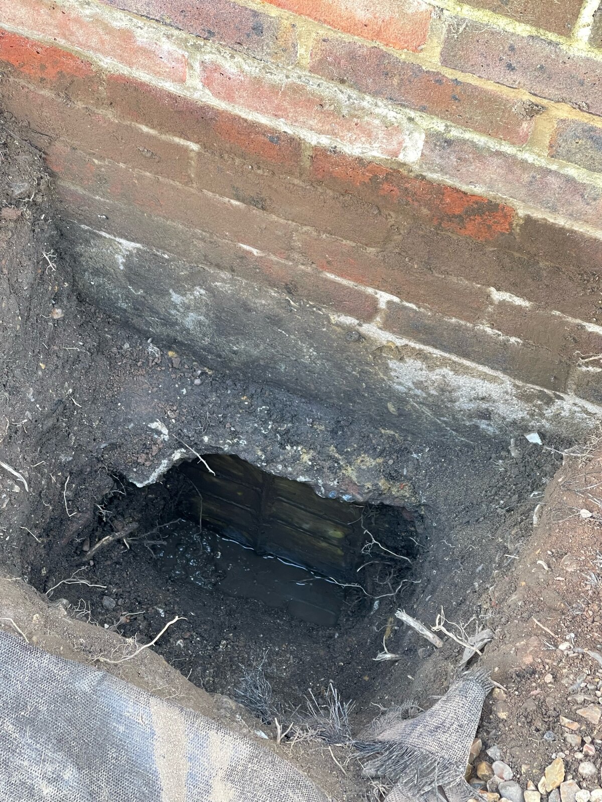

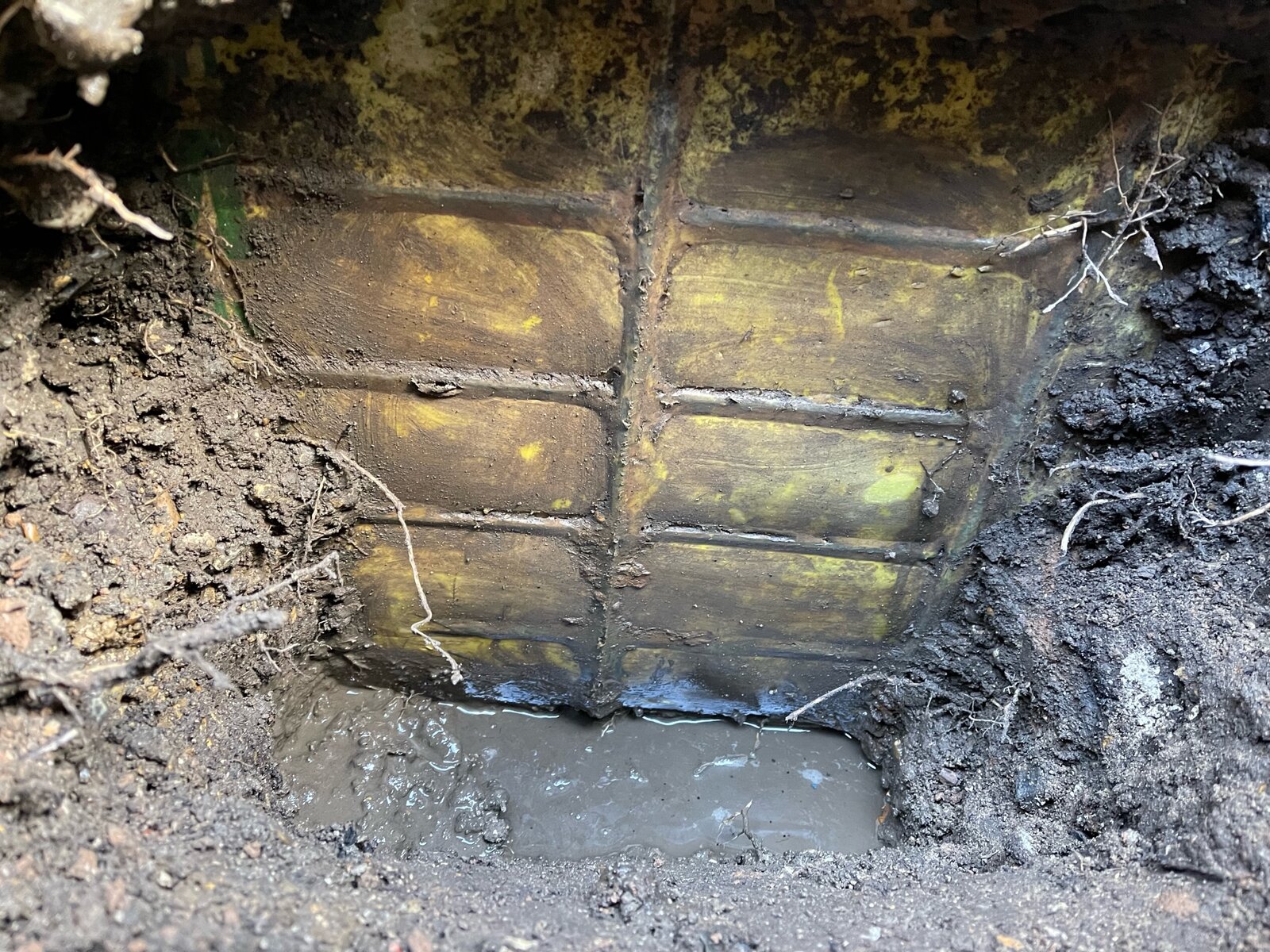

Hi
Does anybody recognise what this yellow sheeting is?
Is it related to piling?
thanks in advise
amwc
Could just have been used to shore up a dodgy side of the trench before the pour
Yes looks like permanent formwork probably for concrete ground beams supported on piles.
Google max frank pecafil and you’ll see what I mean
