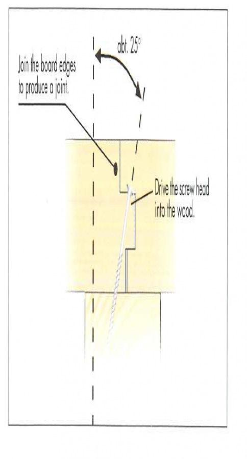

2) What sort of fixings to secret nail the tongues?
The boards will be fixed to the boards underneath, rather than to the joists - for that thickness what sort of fixing, if I was to say hire a pneumatic nail gun? I don't want floating or glued - I want the most sound and stable possible.
3) If I hire a nailgun I may take the opportunity to fix a floating maple hardwood T&G floor in the hallway which creaks like laminate when walked on. It too is approx 20mm thick - can the same nails be used as for the pine?

any idea what nails/pins though for 20mm pine and/or maple?? Do they fire in at 45 degrees? If so, then I think 50mm would give a depth of approx 40mm, so would be through the board and through the sub-boards with a tiny bit to spare - does that seem OK?
You risk splitting the tongues if you try secret nailing.
should pilots be drilled, screws used or should it be face nailed/screwed instead? the data sheet for the timber suggests screws to the tongue, but the suppliers confirmed nails would be fine
