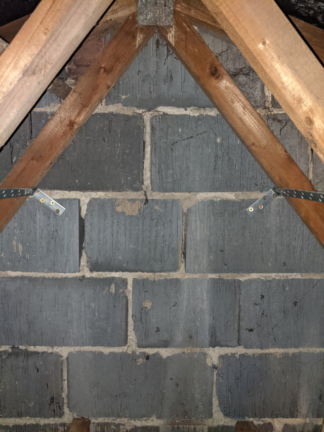

Hi all,
I live in an end terrace that my partner and I moved into five months ago. Since then I've noticed the end wall makes an intermittent metallic "pinging" sound. It's a standard brick cavity wall with insulation.
There is no plumbing anywhere near the end wall. There are no signs of structural issues up to the roof line, but above that the gable is an issue as it leans out. We believe that's historic.
The only thing I can see it being is a wall tie? Or ties? They would be the only metallic components nearby, apart from the gable restraint straps. The noise is keeping me up at night, more from worry than volume.
Photo of this leaning wall may be helpful.
And any overhead cables, TV aerial, gutters, roof.
Have you looked in the loft?
A drip from gutter onto something metallic?
We had the same issue for months, then I found it was my neighbour gutter leaking on an aluminium gully cover.
Pinging occurs even (possibly only) in dry weather, so dripping is unlikely. There's no obvious external metallic structures near the roof.

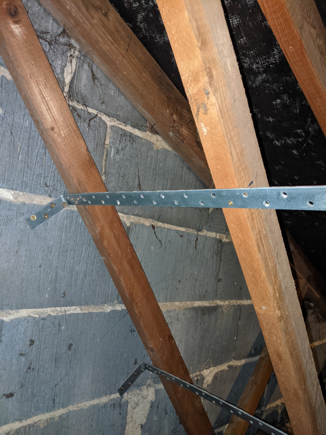

Hmm, the restraining straps?
Photo from inside:
The gable lean is significant - at least 80 mm - and consistent across the rafters, party wall and indeed entire terrace. Structural engineers recommendations were that it's an artefact of construction, and some extra bracing between the rafters is sufficient (we tried to get that done on first moving, but no joy getting builders).
