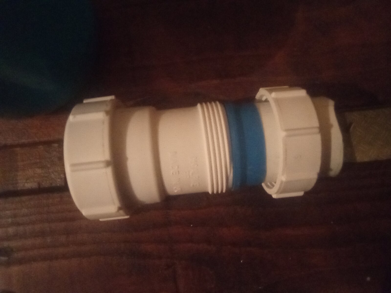

I got a reducer for it, but it wont thread with the o ring in place
Also the sizes are all wrong, says 40mm compresion, but the pipe it fits is 44mm OD
40mm is just marketing-speak. Solvent weld 40mm has an OD of 43, push fit 40mm has an OD of 41. Compression 40mm is loose enough to accept either, because it's squashing the wedge cross-section rubber washer into the gap that creates the seal
40mm is just to distinguish it from the other sizes of waste, eg 32mm and 50mm, which also have push fit, solvent and compression variants, none of which are exactly 32mm or 50mm

in my limited experance there are 2 micky marketed 40mm's. one big and one small, and they do not cross match over different fitting

That's the difference between pipe and tube. Pipe denotes the nominal internal size of the pipe but tube refers to the OD.
This is why 3/4" iron pipe has a larger bore than 22mm copper tube.
Also as already said there are different plastic waste pipe types which aren't compatible so they are made a slightly different size to stop people mixing them up.
