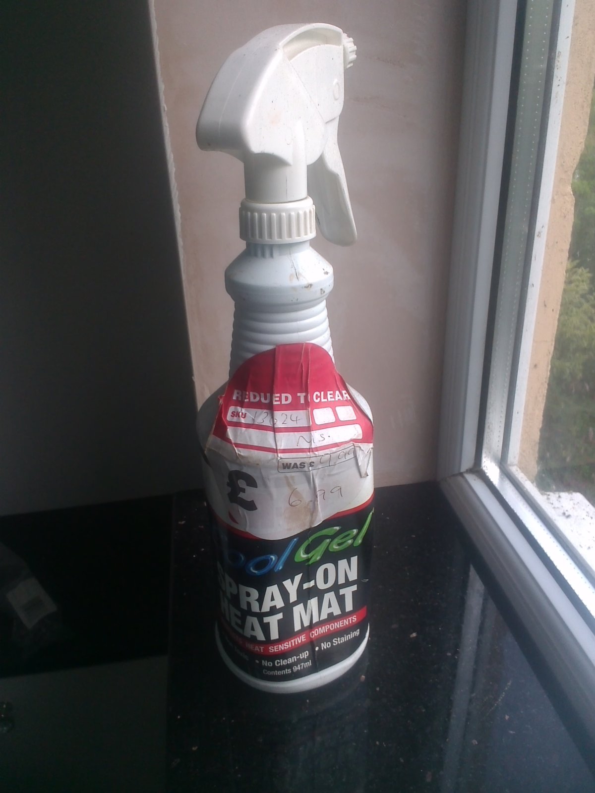

Consider using clip spacers (to bring them off the wall) so that you can then get some insulation around the pipes.
I've found this useful in some situations

Always best to set out and dry fit everything before you solder, you can get a better feel for everything and make any adjustments before final fix/fit.
