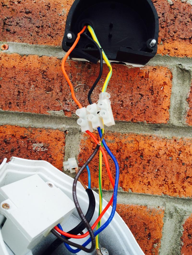

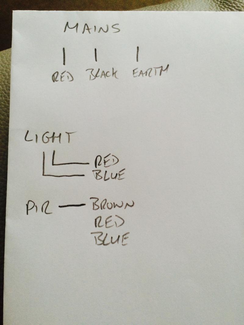

Hi I have moved house and have lost my diagram for fitting my pir outside light,I am a bit lost with the wiring if any one could help that would be great.To me it looks like I have too many wires!
How can we tell?
Post us a picture of the terminal block on the PIR light, and a picture of the wires, that might be a start.
Mind you a wire is a wire. It can be brown, red yellow, black blue etc. But the colour, on its own, gives no indication as to what the wire does. Do you have a multimeter, or a proper two-probe test device?

Two blues from the light and pir together. Connect these to the black from the house.
Connect the brown from the light to the red of pir.
Brown from the pir to red from the mains.
If that doesn't work, swap the red and the brown wires from the pir over.
Leave the earth connected as it is.
