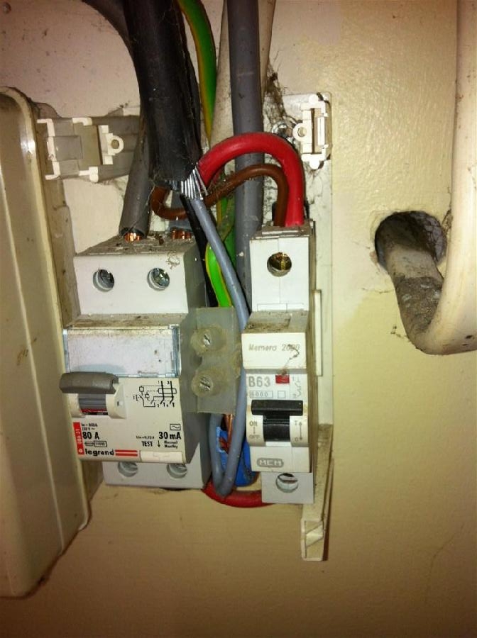

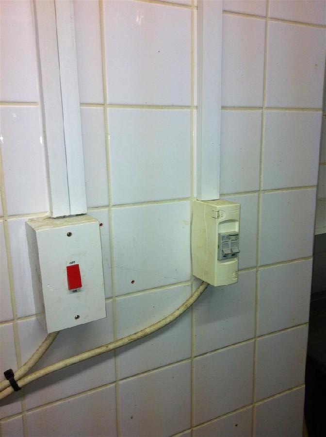

Submain for the cellar. Fed from a 60amp sw-fuse. Not really apparent in the pic, but the submain is two 6mm T+E's in parallel. Notice the 'busbar'.

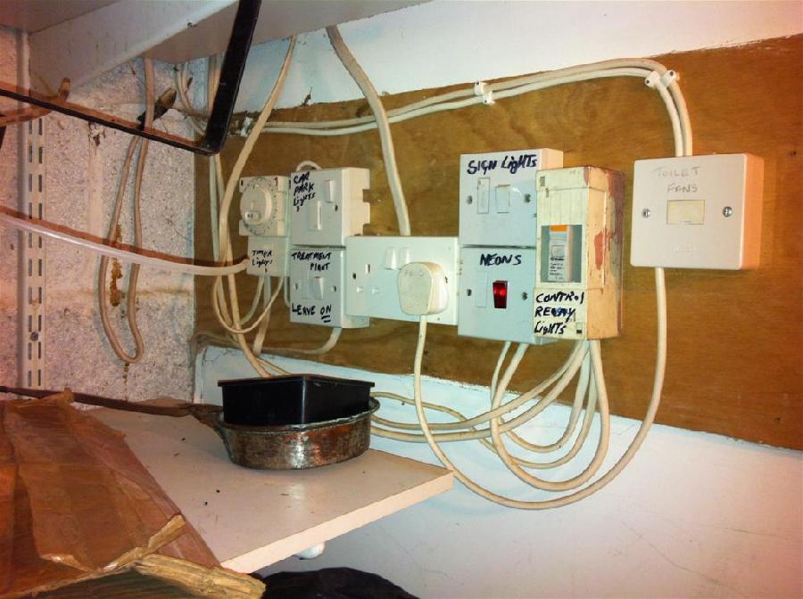

Just a bleedin mess!

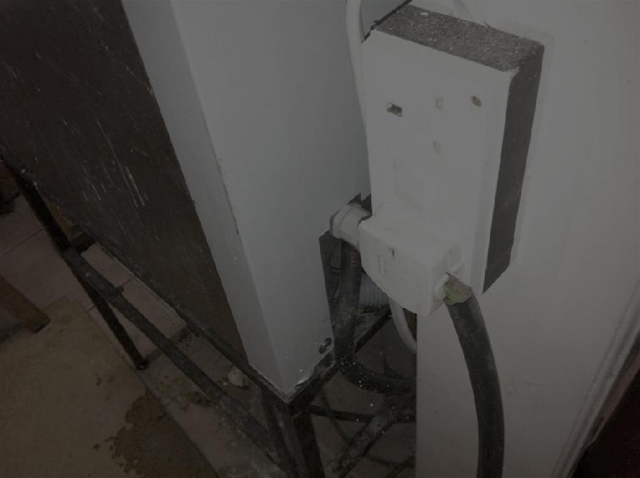

Odd way to connect to a 25amp fryer. The next pic showing the feed to this.
What can you say really?

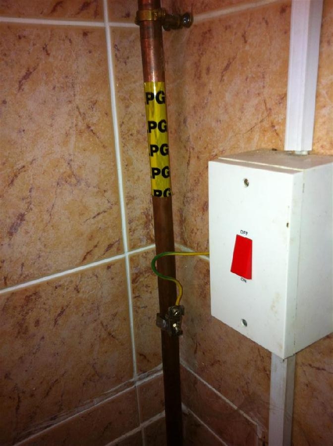

Just a pic of some typical "it's metal, lets earth it" type thinking.

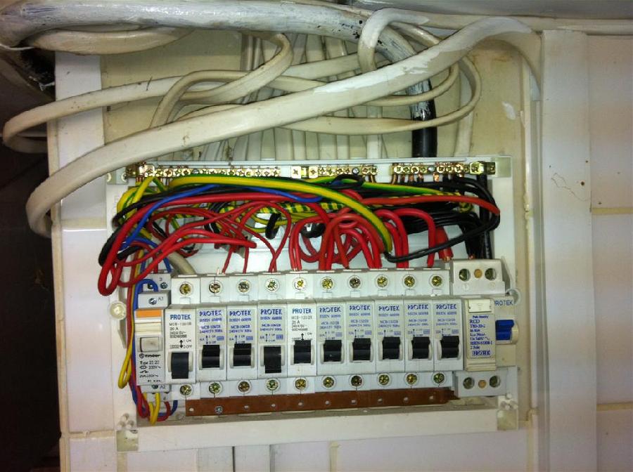

Again, just a mess, but there are also several 32amp circuits doubled up on breakers. A huge loading on a small board with just a 60amp submain. The submain fuses quite often apparently. And why the 30mA RCD incomer :evil:

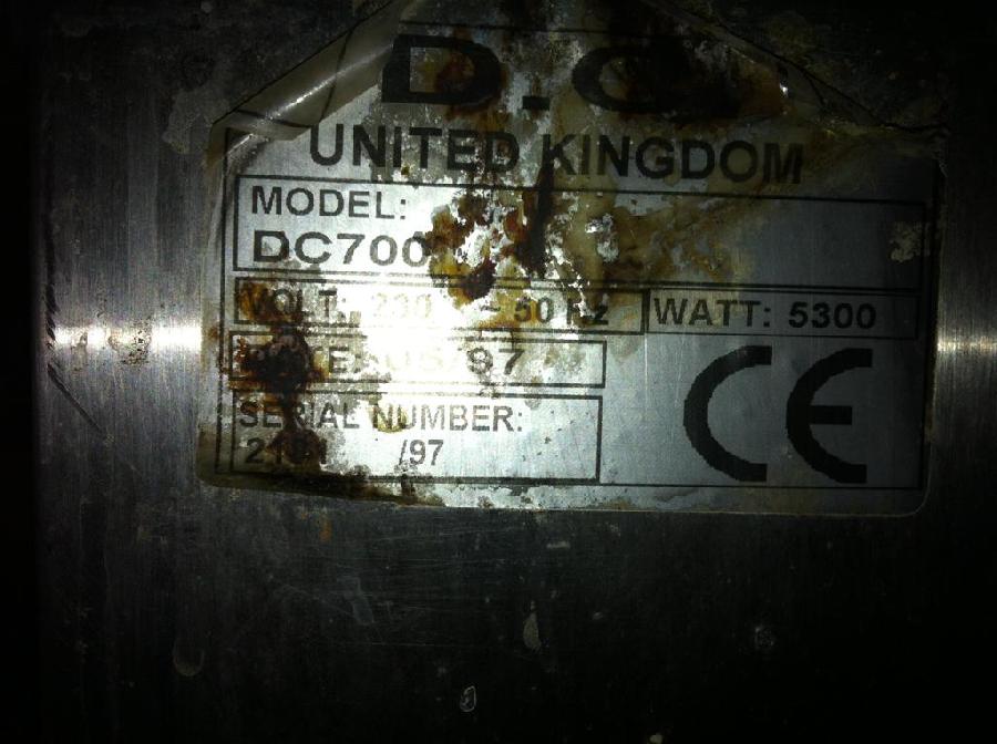

Dish washer (lovely and clean). 5300watts.....and connected via the following pic....
5300watt dishwasher...
Trying to get me head around the first pic. I'm guessing that's a MEM board and incomer but the spark thought that Protek breakers would be cheaper?

And in PIC4. Is that brown wire good for 63amp? Looks like the neutrals are melting too...
Looks more like a protek board with the main switch replaced with MEM
