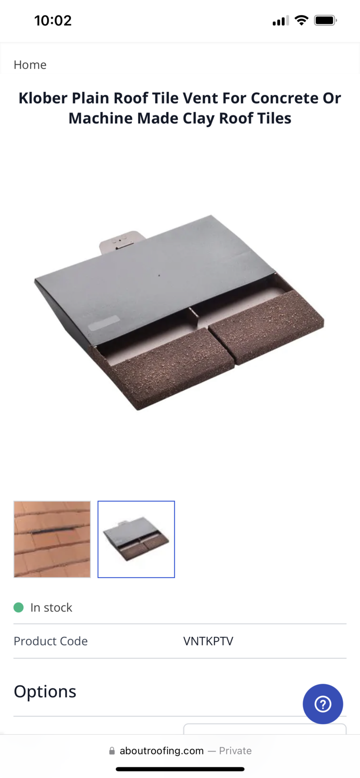

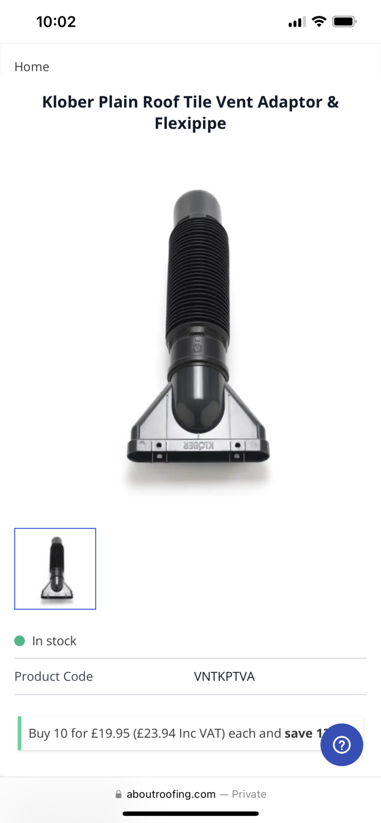

Any knowledge on these “in tile” extractor fan vents? Google keeps leading me down this path and I’m wondering if anyone has any better ideas.
Not cheap at £65 for the vent and adaptor pipe, but the idea looks good. Wonder whether the practice is so good.
Both. Can be a roof vent or an extractor vent with the additional pipe attachment I’ve shown in the pictures…..

We just poke black pipe through a lead multi-slate. Fix a cowl on top and flexi-hose on the bottom.
An old school simple solution. I’d guess there is more air flow through that than that tile vent.

I don't know if you are aware, but most cooker extractor require a min 125mm duct?

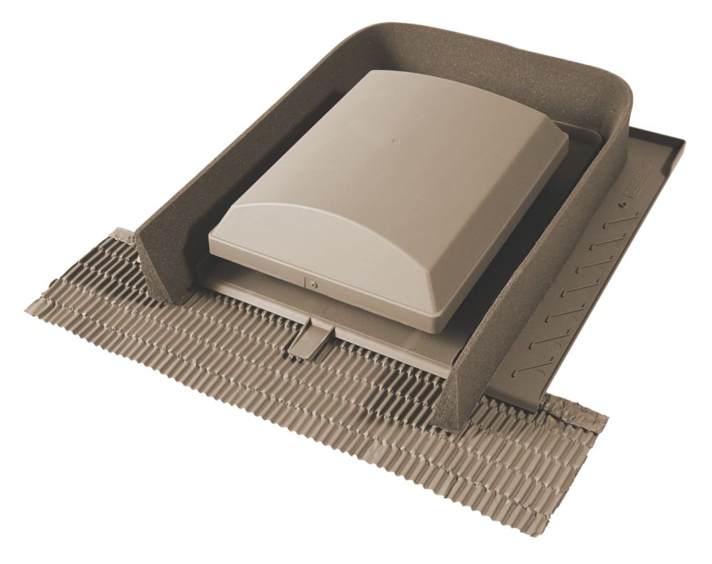

I recently put on of these in, same kinda job but different design.
Faffed around a bit as it was my first one but I'd use again. You do need the adapter supplied separately though.
