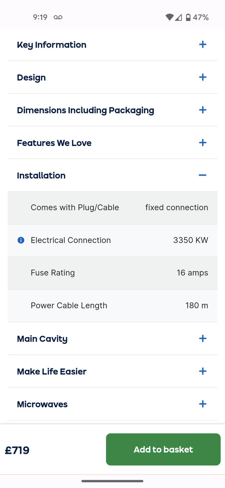

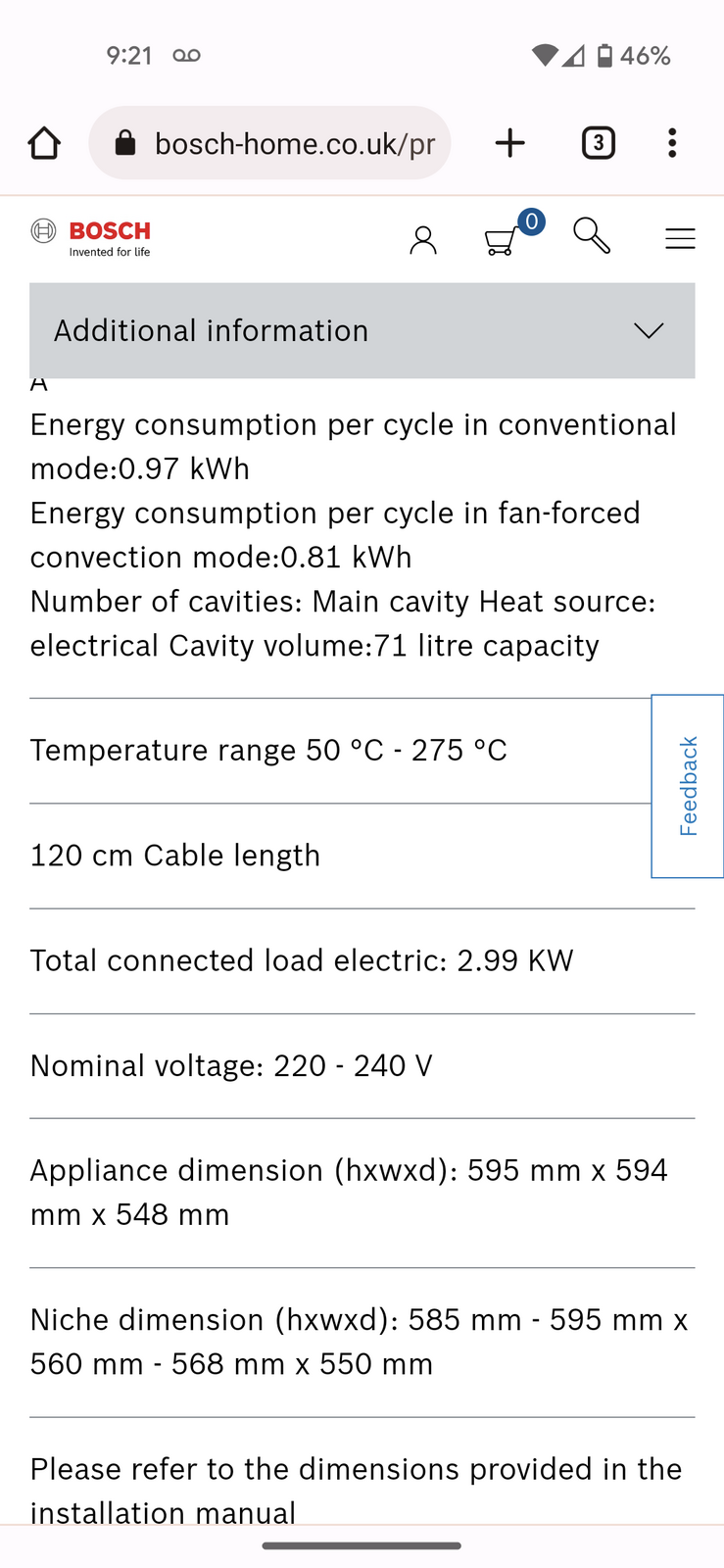

Il leave a screenshot of the 2 ovens specs that i managed to find on the internet.
Would it be pretty much the same, except instead of ONE cable going to the connection (from the oven) there will be 2. (2 ovens) then from that it is the 6mm cable going off to the fuseboard.
Fuseboard is rcbos just not entirely sure at the moment what the cooker circuit is rated at.

Perfectly OK due to diversity. By the way you don’t have a fuseboard as you have no fuses and fuseboards have not been fitted this century. You have a consumer unit.
An enclosure can have in most cases a variety of devices, often clipped onto DIN rail, these do include fuse holders, and one make of the devices is called fusebox.
If the overload device is too small, it will trip, so no harm done, however if frequently tripped they tend to trip sooner and sooner.
My cooker on a B32 type AC RCBO which has never tripped, although max amps is around 65 amp, but one could never switch on all together.

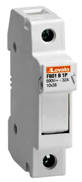

When we moved from re-wireable fuses to cartridge fuses we also moved from 30 amp to 32 amp, this 1672394492261.pngfuse holder will fit in a modern consumer unit, although it cost more than a MCB so only reason to fit one would be to house semi-conductor fuses, as a MCB is too slow to protect semi-conductors.
In the main only used in control panels, however nothing to stop being fitted to a consumer unit.
